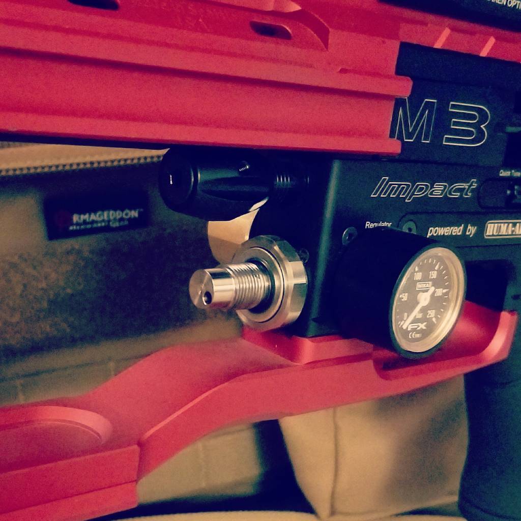

Now that I've essentially turned my M3 into a MK2 (yes, I even have modified the valve adjust knob), I love it! Lol
Edit: btw 160bar reg set slug shooter. And bio, I have something coming Thursday that hopefully works out for the 2nd front gauge
