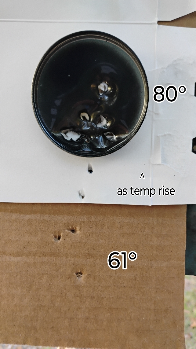

I was duped in getting a gas ram because it solved all this ..lol. Heck it's worse then any springer I got .. far worse .. gamoigttemppoi.jpg
Now if I don't adjust the sights it will hit dead on every temp poi as long as it's the same temp . Lol
I id zero in the warmer afternoon 70 to go hunt in the colder morning and would sourly miss but I'd check it back in the afternoon when the day was warmer 70 again and it was pretty on target . Well. ....
Got smart and set up and shot at a long paper and was low as like above but as the day got warm and I got back to my zero temp it was back in the bulls .. lol
Crazy ..
