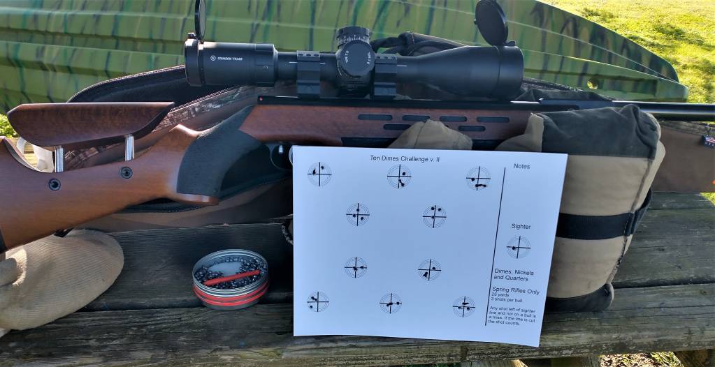

Here's mine I just shot. I posted this on the other similar thread also. Shot at only 20 yds, that's all I got, with a 50s 20 cal.
I am jealous of you guys that own a 98 in .20. It has to be the cats pajamas, has to be.
