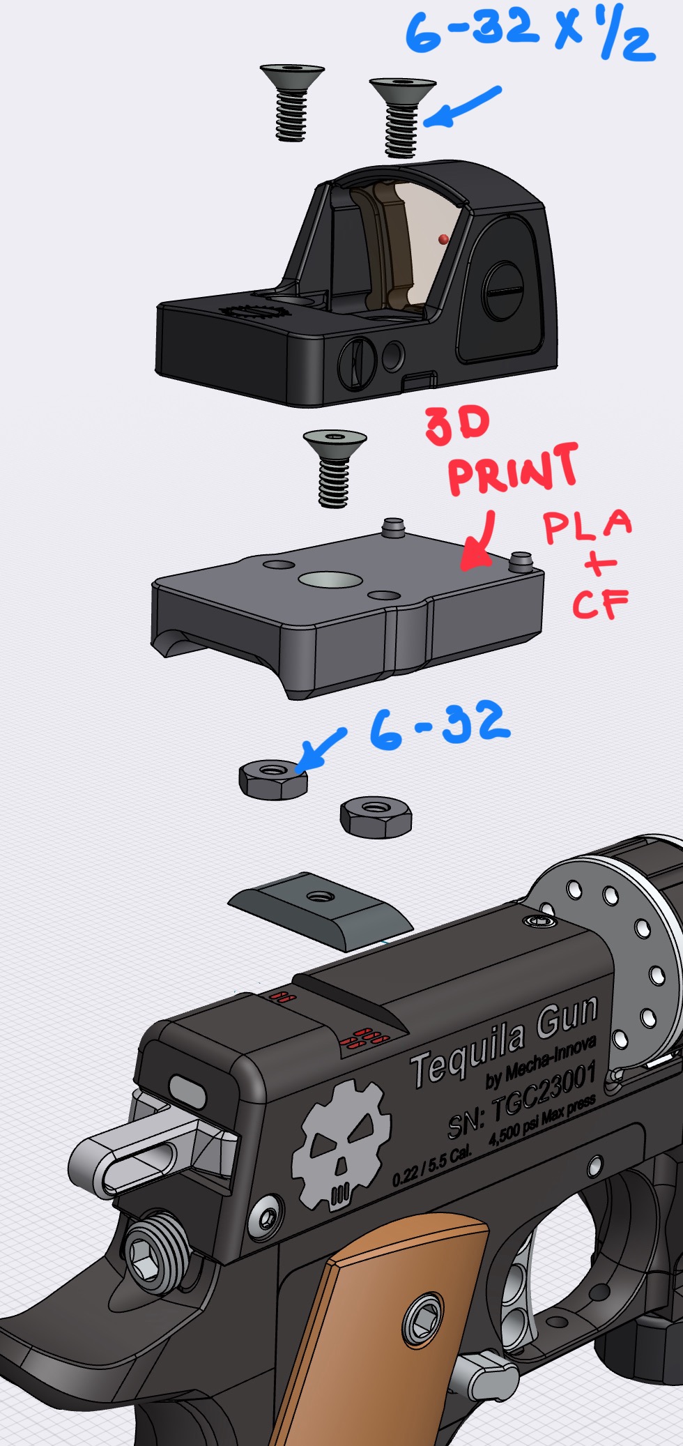

Yeah, that's it. As long as the two piece assembly is a solid, or non-movable, once assembled.
Thanks.
Let us know the availability and cost when you are happy with it.
Mike
Please send me your input.

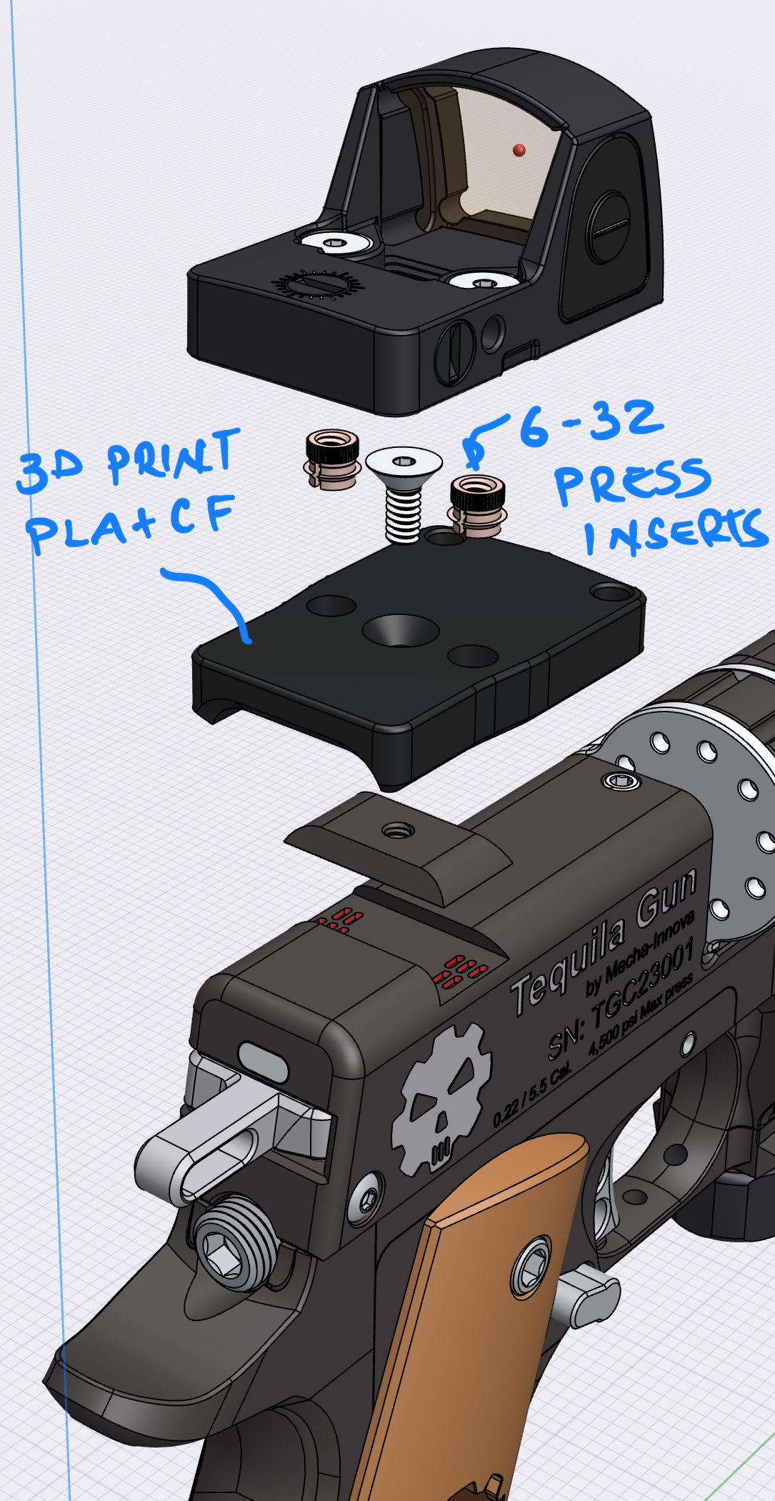

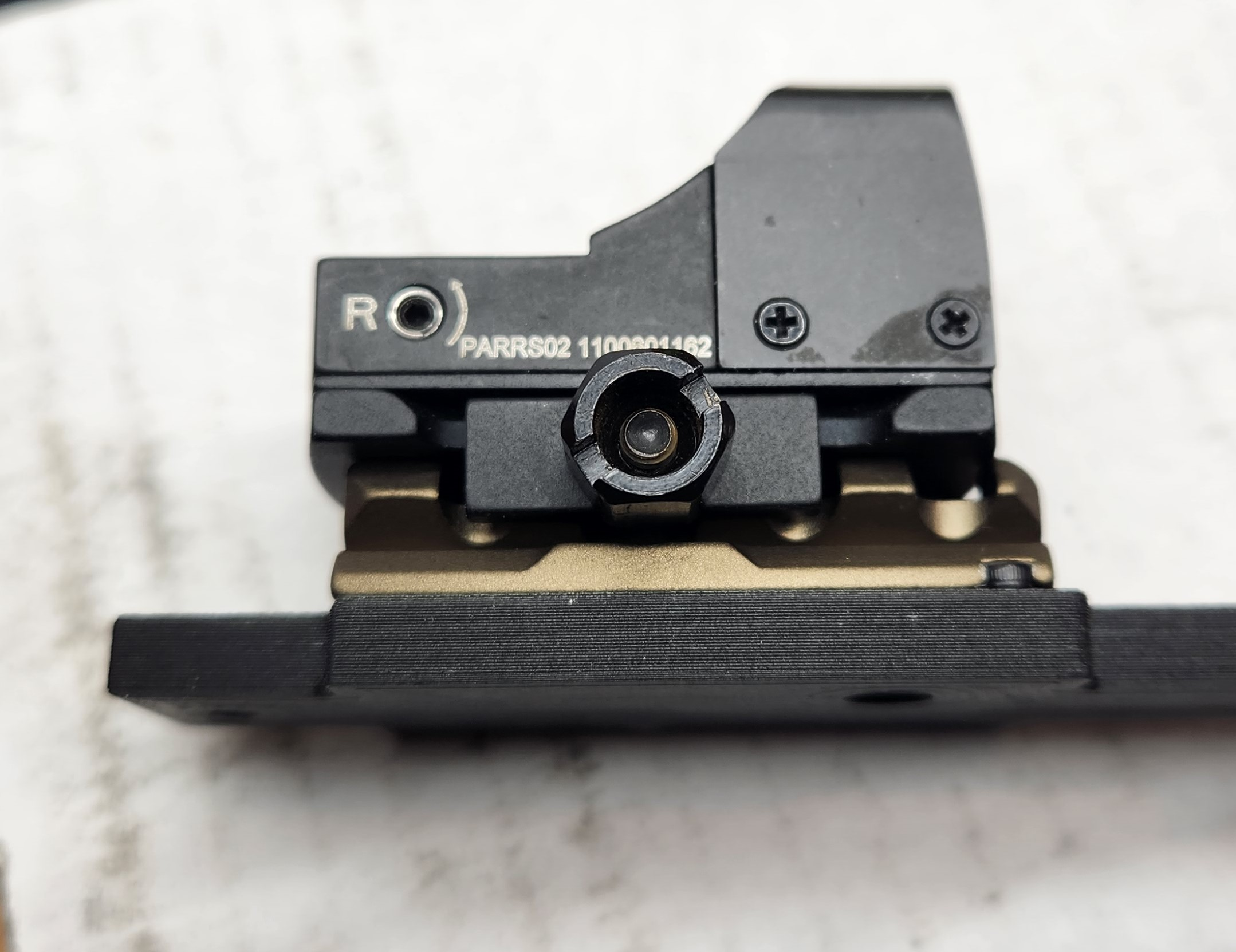

Rather than nuts, I like the way that "M0ist0ne" did it. He just used "thread inserts". Much cleaner. You just need to know that you can't tighten the screws TOO...tightly !
I'll try to find a picture of his adapter. It also has the "pins" to locate the sight, along with the hold down screws.
This one doesn't show the thread inserts and the locating pins. I'll keep looking. But I think that you get the idea.
Here's a shot where you can see the locating pin -
See all the way to the right, at the bottom, end of the gold mount . That pin is 3D printed, part of the plate.
The thread insert, is well, just a thread insert . Can't be seen in this picture.
Maybe...I'll remove the sight from my gun so you can see it, but again, I think that you get the idea.

once be inserted on place. Is hard to be removed, also if is removed the piece would be damage In the process.
Our friend want something stronger than the "plastic" the only thing I can think of is a threaded insert to take up the wear and offer more bearing surface. Personally I'm good with the "plastic", until we can get one made out of Titanium of course. :unsure:
Only option is a treaded insert, not sure there is enough room for a t-nut. BUT how often are you really going to be removing it?
Well...I move sights around to different guns a lot !
A given sight can live its life on one gun, or I've been known to move a given sight to two or three guns in a month, until I'm happy with its placement. Or...any given sight can rest in the top shelf of my safe, until I decide to put it on a new / different gun.
Hope this doesn't bother you too much !?
Mike
Reactions: Bandito

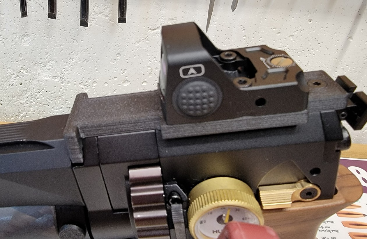

With some sort of metallic threads, I'm fine with a well done "plastic" mount. Plus, I'm also interested in properly fitting locating pins, again, plastic or metallic.
BUT...all bets are off on a firearm ! There's a couple of reasons that a proper steel, aluminum, titanium...or any other exotic metal be used for firearm reflex sight mount use.
The plastic mount on my Huben GK1 is working fine as is. And yeah, per my note above, I've even had a couple of different sights on it, AND...gone back to the originally placed, Holosun sight.

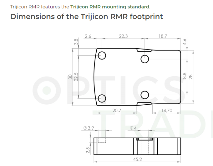

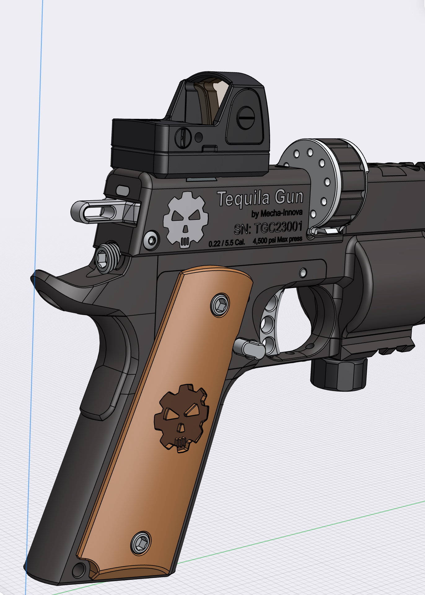

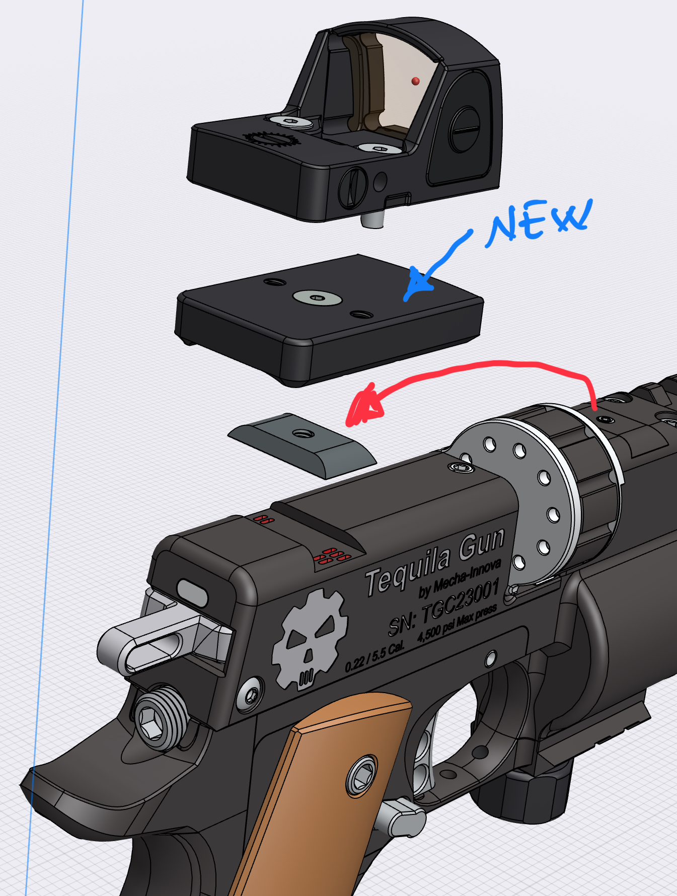

Finally the Trijicon base is finished. Also I developed a new suppressor that has a mechanical valve to catch and release slowly the high pressures air. Only the sound of the hammer hitting the pin valve is listen.
