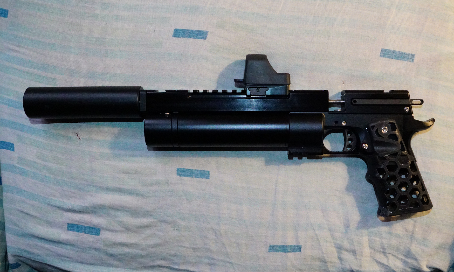

Found the first picture with the original hex pattern 3D grip -
A hand full of changes to the gun since this shot.
Hmm, yeah, there's a few changes in the grip shape, from this first one. Might like to give the new one a try...

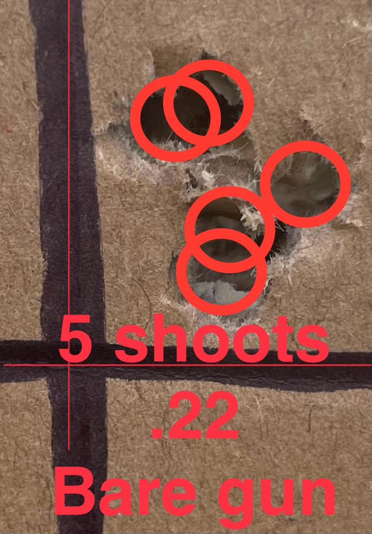

I do not check yet the accuracy but the internal hole diameter is 5/16. It is 0.046” by side of the pellet.Looks like the first two pics are the same. Certainly seems to tame the sound - congrats! How about the accuracy?

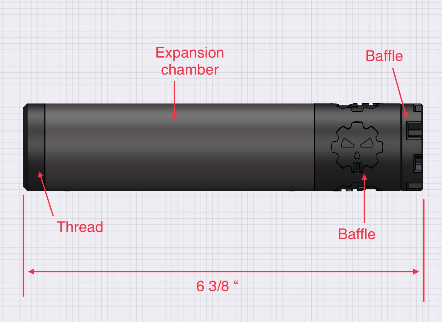

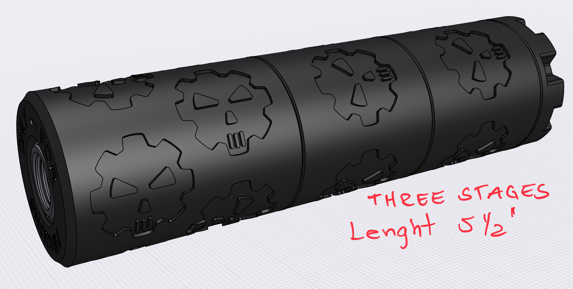

This moderator is other variant of the original. For the original, I have the following configuration:Ouch...that's a mighty long muffler !!!
Seems that a pistol muffler should be about 1/2 of that, 6-3/8" length. Maybe 4" long.
I like the idea of the empty chamber then a baffle of some type. But again, the chamber doesn't really "need" to be that long...does it ?
How much air, by volume comes out the the .22 gun at, say, 550 fps ? Then the empty chamber should be some small portion of that volume, as expended, but it seems to me, "not" the full expanded volume. That could actually be "any" size if you think about it.

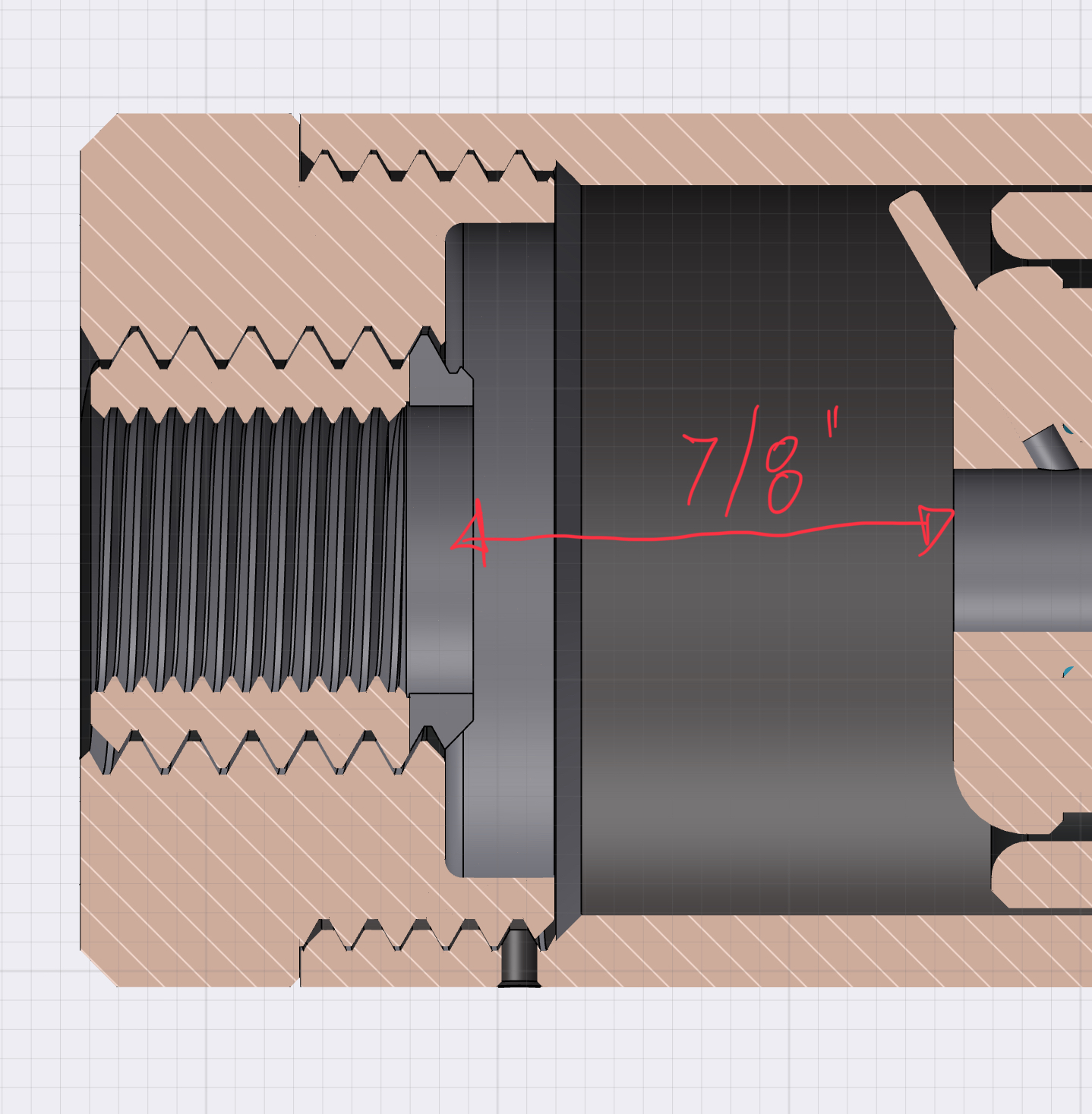

As I tested the original, two chamber muffler, in a few ways. I found that the two chambers, as...empty (no baffles), did a reasonable job of quieting the sound. VERY near what happened with the two baffles installed. Unfortunately, I did not try one empty chamber, and one baffle. I should have.
I'm going to take apart the muffler that I have. Remove the first baffle, leave the second baffler in place, see how that sounds.
So, one expansion "only" chamber, one baffled chamber, and test.

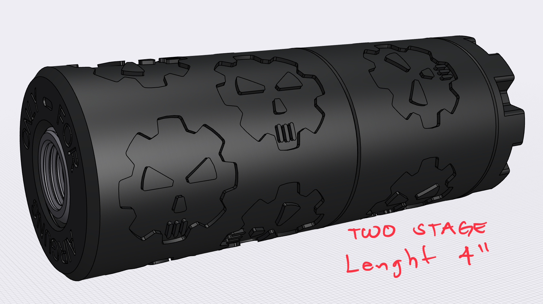

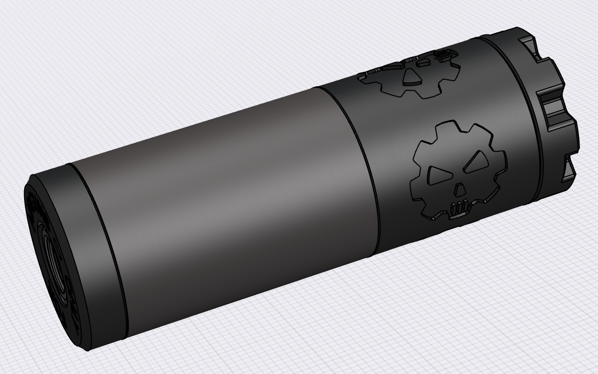

MUCH better, pistol wise !This moderator is other variant of the original. For the original, I have the following configuration:
The total length is 4 3/8

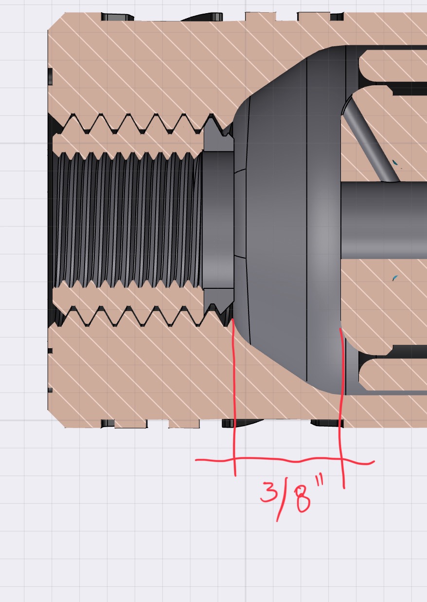

The old model was designed with a small expansion chamber (3/8). The new one is bigger and works better. Also it is built in aluminum.MUCH better, pistol wise !
The longer length should work on, and look better a higher powered rifle, as required.
Although, even on my rifles, if a short muffler works, there's no need for the extra length...in my book. Like my FX Maverick, and Wildcat (similar guns), I have "single" sections of the Huma Mod40 on each of them. Keeps them both as short as possible, and, quiet...enough.

I am waiting for the aluminum expansion chamber, I hope receive it the next week. Once as be received I will shipped to you.Well, I removed the first baffle (closest to the barrel), and left the second baffle in place. It's glued in per Alfonso's recommendation.
It was actually fairy quiet. Only shot it three times, and not for accuracy. I had done all that a couple of weeks back with good results.
So now I'm waiting for the new design can, that's meant for a single baffle (per the above), to see how that compares.
Overall, very happy with gun and its assembly of parts.
