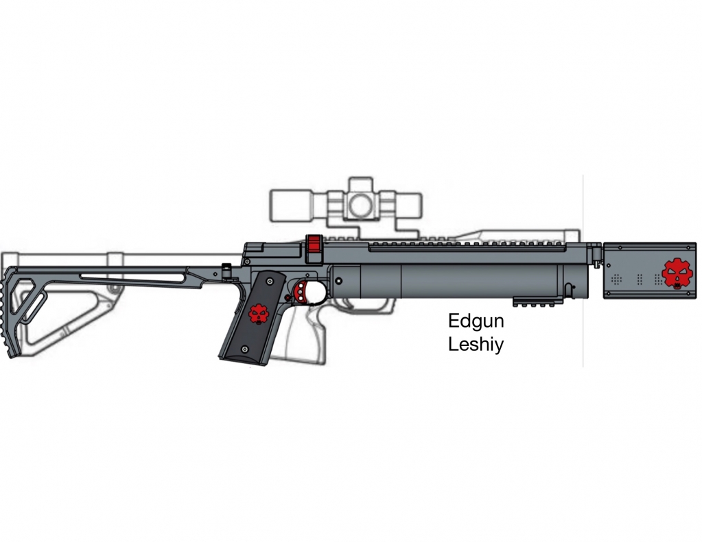

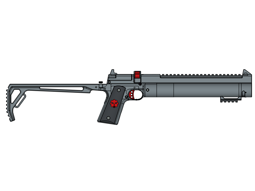

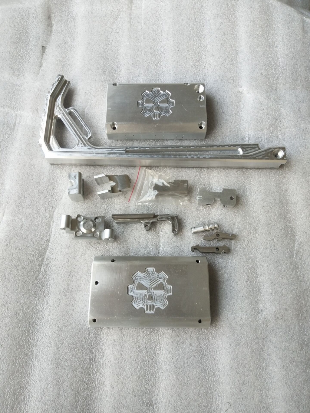

It is very compact and light weight, Also the mechanical design is very robust, I will using a high quality materials and the mechanical pieces has a lot of details on the shape also the internals.

It's coming along nicely! As far as the sights go, I'd suggest that you machine universal sized dovetail grooves in the front and rear of the frame and barrel support for the sights. Also, supply good high quality adjustable rear sight so owners don't have to buy better new sights. If the owners choose to buy high-end micro adjustment sights they can install them easily with universal grooves.
Oh, this is looking very nicely.
With foldable stock, great. (Please, allow the stock to fold to the left side, so that the majority of shooters, right handed, can shoot it as a pistol while the stock is folded.)
I really like the bully-big airtube, and the long picatinny rail.
Keep up the good work, this is going to be great! 😊
Matthias

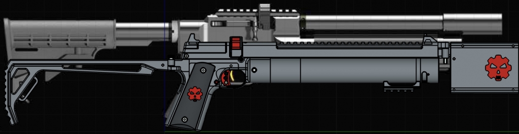

The current design is folding to the left side.

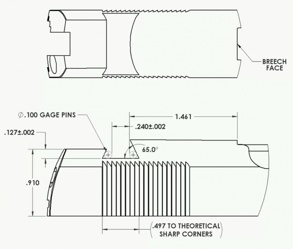

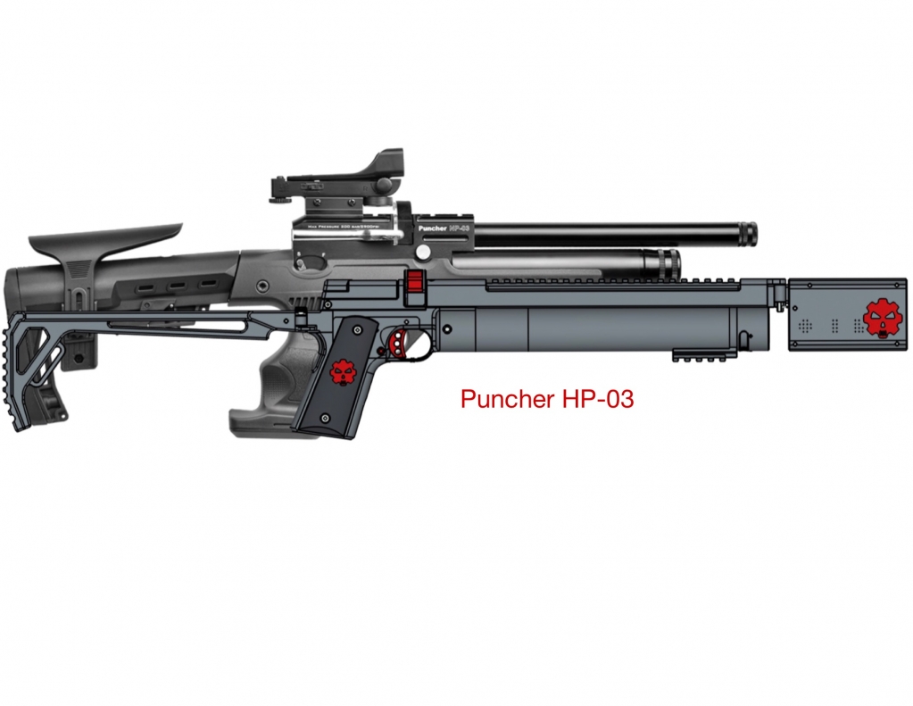

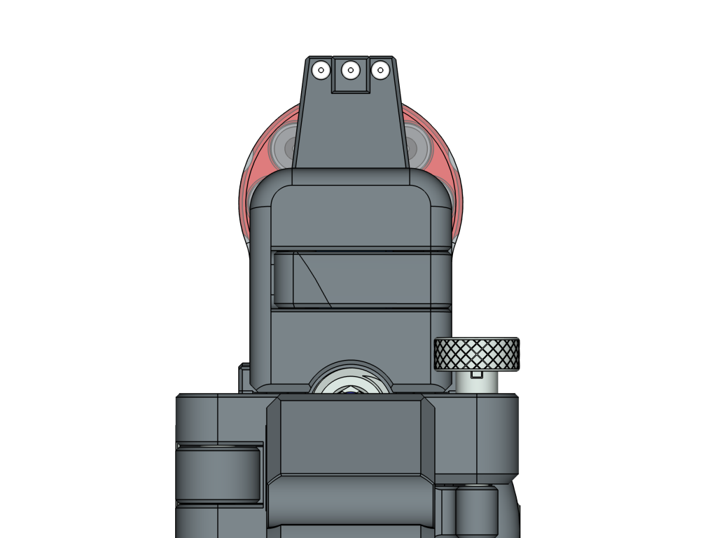

The concern is that the distance from top of the gun to top of the magazine are 3/8, so the sight must me higher, the minimum are 1/2”. I can not find a sight with these specs.
I am using the factory-produced 1911 dovetail.
1571463491_16464935245daaa143ecfd34.62297798_42F06911-7BAC-4F2B-AD3E-C51C9BA40257.jpeg
If standard sight height is an issue, a dovetailed spacer that mounts to the barrel's slide may be the easiest solution. Then the sights would mount into the dovetail of the spacer. You could make the thickness of each front and rear spacer the perfect height, adding a touch of offset MOA, so the barrel and sight plane are nearly zeroed at 10 meters.

I like that idea. And the buyer will have both options: a) fully adjustable and b) fixed screw style.
