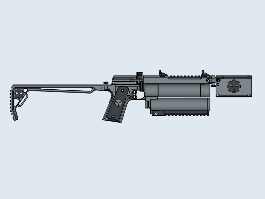

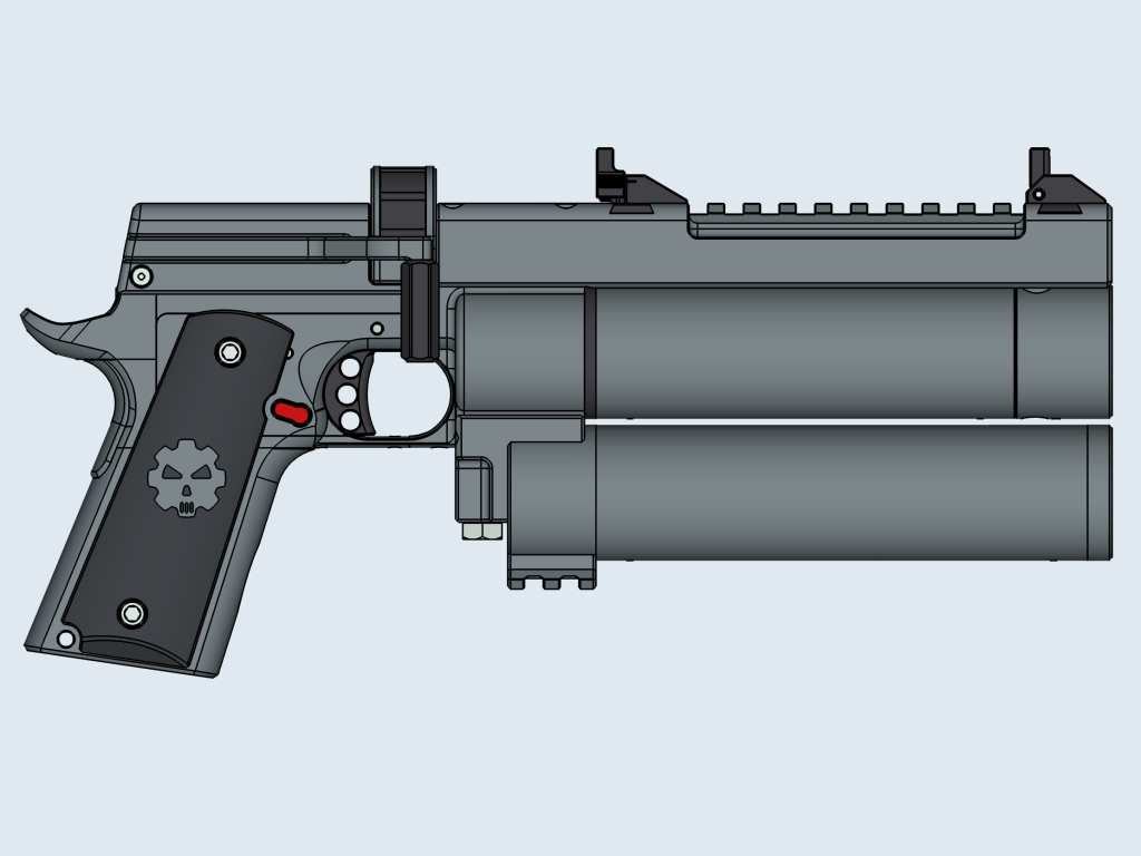

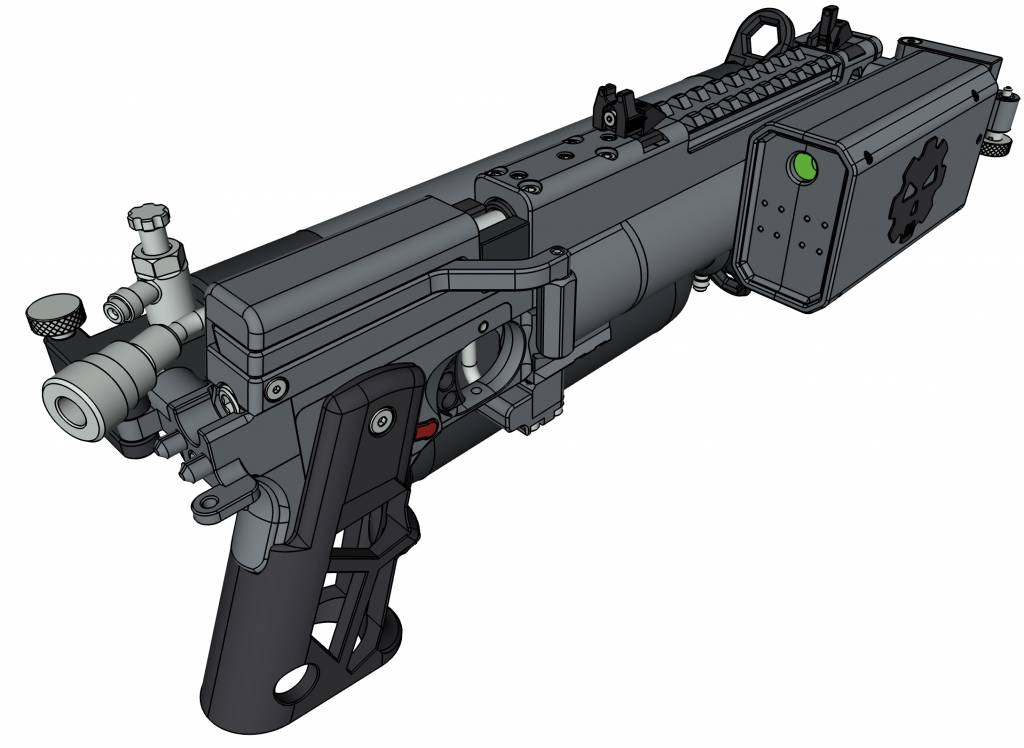

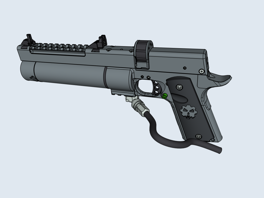

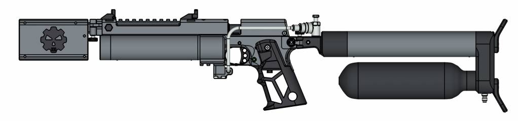

This month I will launch the second prototype, I did a lot of changes to the original design, but the new one is better. And this are the new specs for the Tequila shoot.
1. Handgun

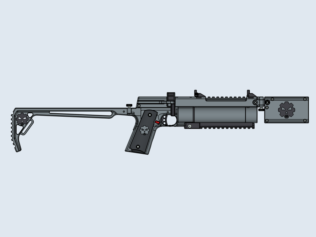

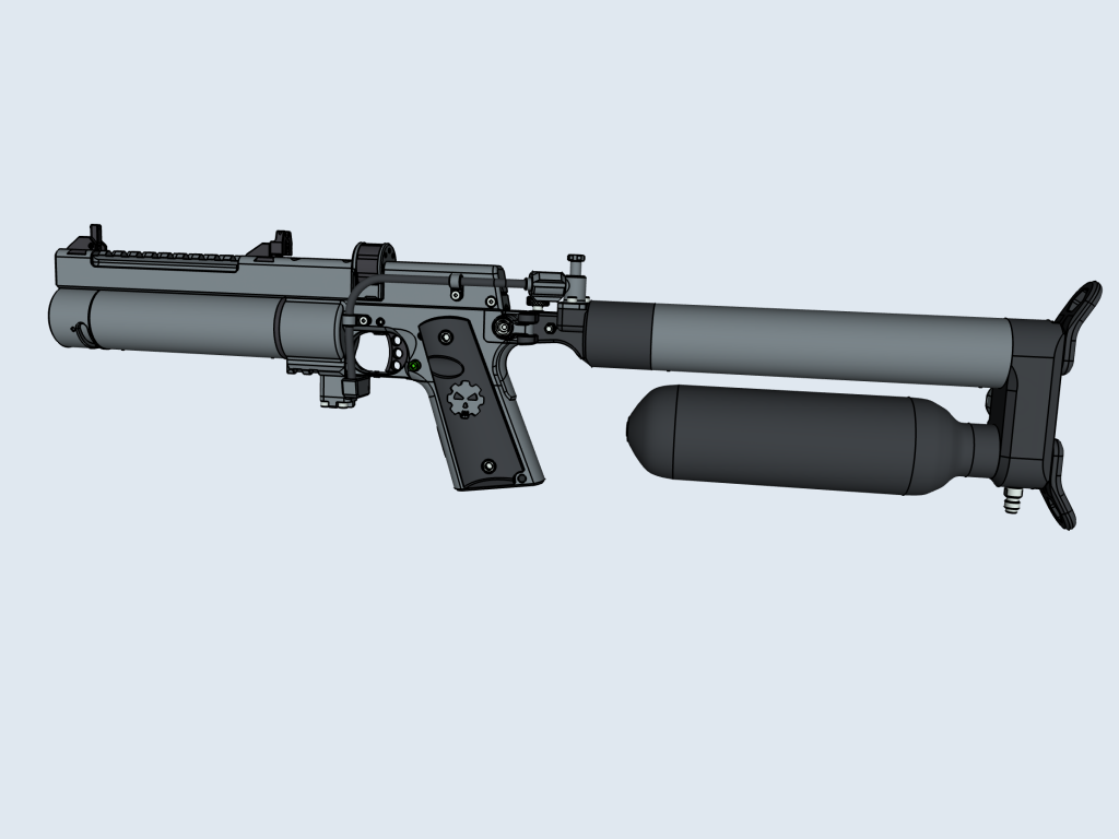

2. Accessories: Folding stock, folding suppressor and picatinny rail

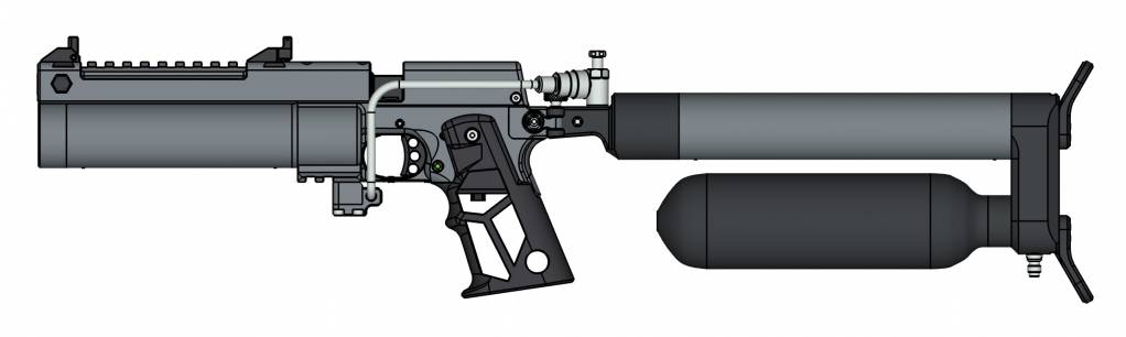

3.- Add a extra air tank.
This modular design was made thinking in the customer. Only buy do you want, and have the option to get the other accessories in a future.
The body of the gun is 7075-T6 Alum, and the hard parts of 304 Stainless Steel, the hardware (springs, screws, dowel pins, etc) is only Stainless Steel.

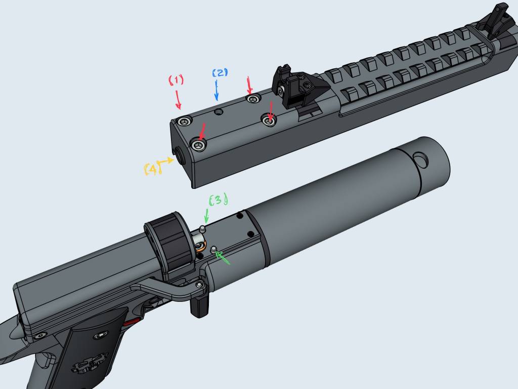

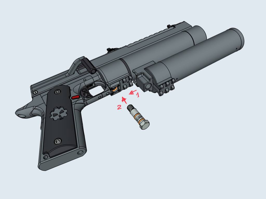

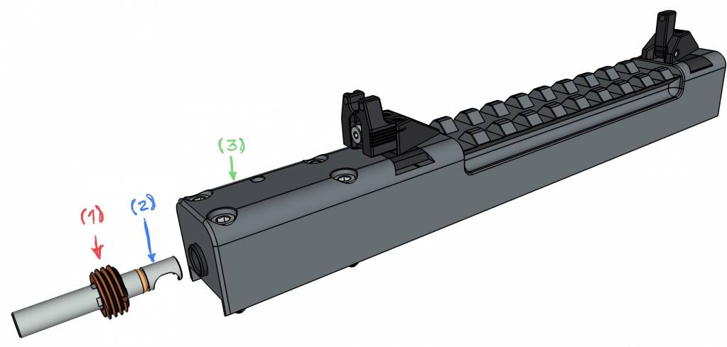

How is the barrel assembly attached into place?
The barrel housing is attached to the main body using 4 6-32 screws (1). Has two dowel pins to align the housing barrel to the mail body (3).
The barrel is slug liner 0.223 (4) and is press fit into the housing barrel. To align the barrel liner to the hole air port used a spring pin (2).

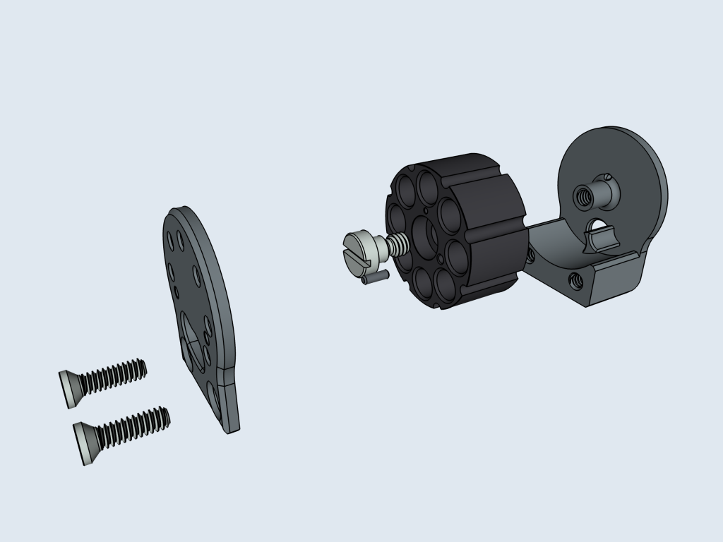

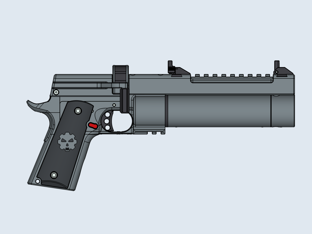

One final thing that i forgot to ask about before; the mag still has the mayan numbers on it or has this feature been removed from the second prototype?

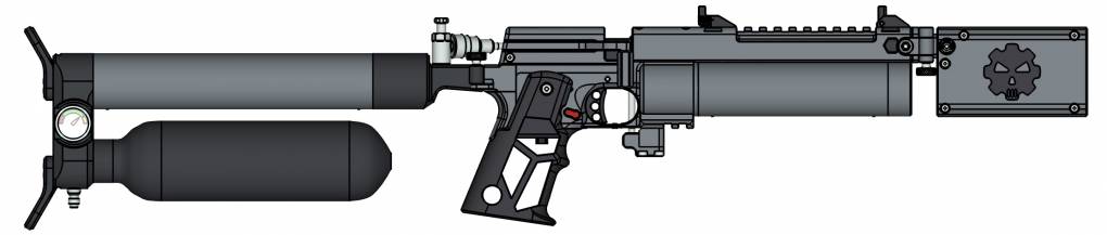

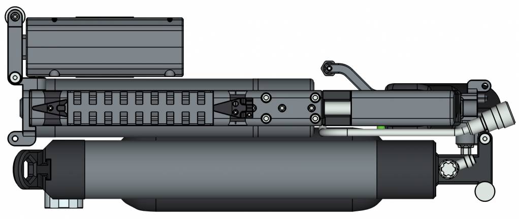

Cant you rather design extra bottle that goes into added rear tube and connect it to main tube via line and check valve. Pistol with that second added tube is 100% front heavy and need that stock anyways so could as well have the second tank combined with it. If you have check valve there and make that rear tube bleedable you could probably fit it inside of mil spec tube that you can just screw off after bleeding. Just my opinion.
I removed the Mayan numbers, but if them are necessary to identify the total of slug remainder I can add them
The magazine is made of 304 Stainless steel and use high grade screws and shoulder screw to have a robustly design.
The maximum slug length to be hold in the magazine is 0.500”.

It was a very nice touch!!! It helps notice how many shots are left and is also a feature that makes the tequila very unique!!!
