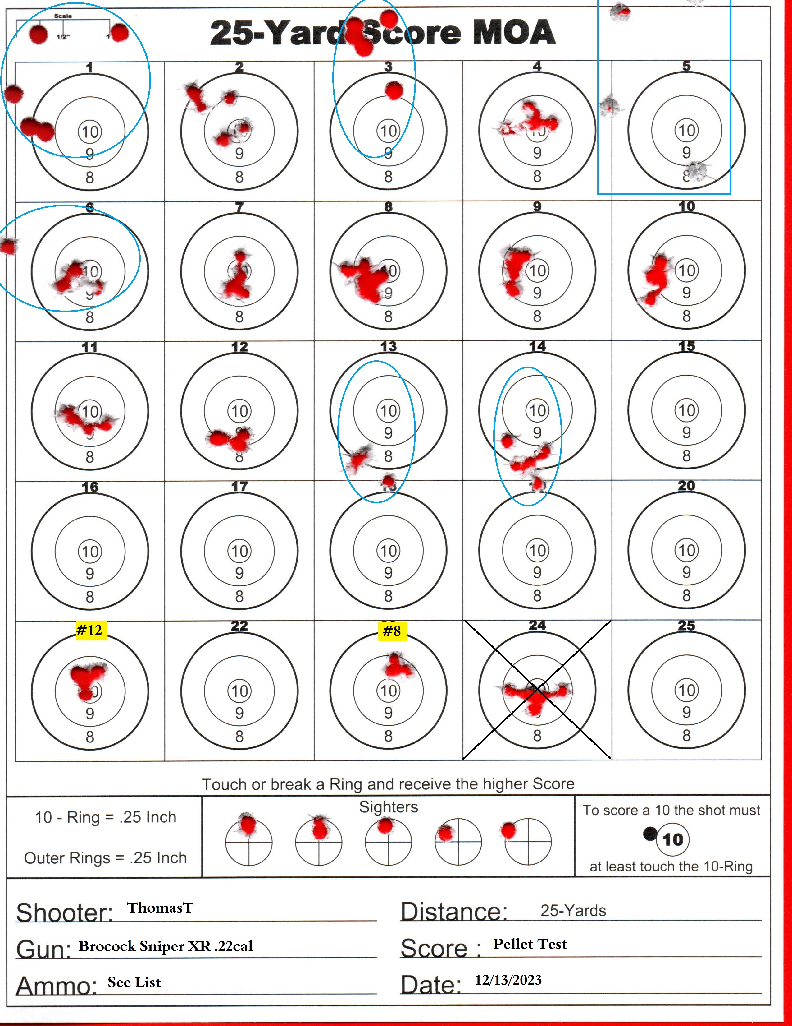

Hello everyone,
What a surprise and a bunch of information gathered today. Conditions near perfect and after shooting another paper target I decided to Test Shoot every .22 cal pellet that I have except for Slugs. The list contains, Domed, Hollow Point, Pointed Tip, and even Wadcutters. Weights from 11.9gr up to 25.4gr, See attached List below.
Range: Outdoor 25-Yards
Rifle: Brocock Sniper XR .22 caliber
Scope: Athlon Argos BTR Gen2 10-40x56
Wind: 0 to 3 mph
I am impressed how well the Sniper shoots such a wide variety of pellets. True, not all shot well enough for competition but other than #1 and #5 good enough to hunt with in general. The number above each target is the same for the Pellet shown on the List. I did re-shoot number 12 and number 8 to confirm their accuracy. I shot five pellets at each target. I will now do more testing on a select group.
ThomasT
Number Weight Brand
1 11.9 RWS Hobby Sport Line
2 13.43 JSB Exact RS
3 14 RWS Professional Line Wadcutter
4 14.3 Crosman Domed Ultra Magnum
5 14.5 RWS Superpoint Extra Field Line
6 15.89 JSB Match Diabolo Exact Jumbo
7 16.08 JTS Dead Center
8 18 Air Arms Diabolo Field Heavy
9 18.1 JTS Dead Center
10 18.13 JSB Jumbo Heavy
11 18.13 H&N Baracuda 18
12 21.53 JTS Dead Center
13 25.39 JSB Jumbo Monster Diabolo
14 25.4 FX
