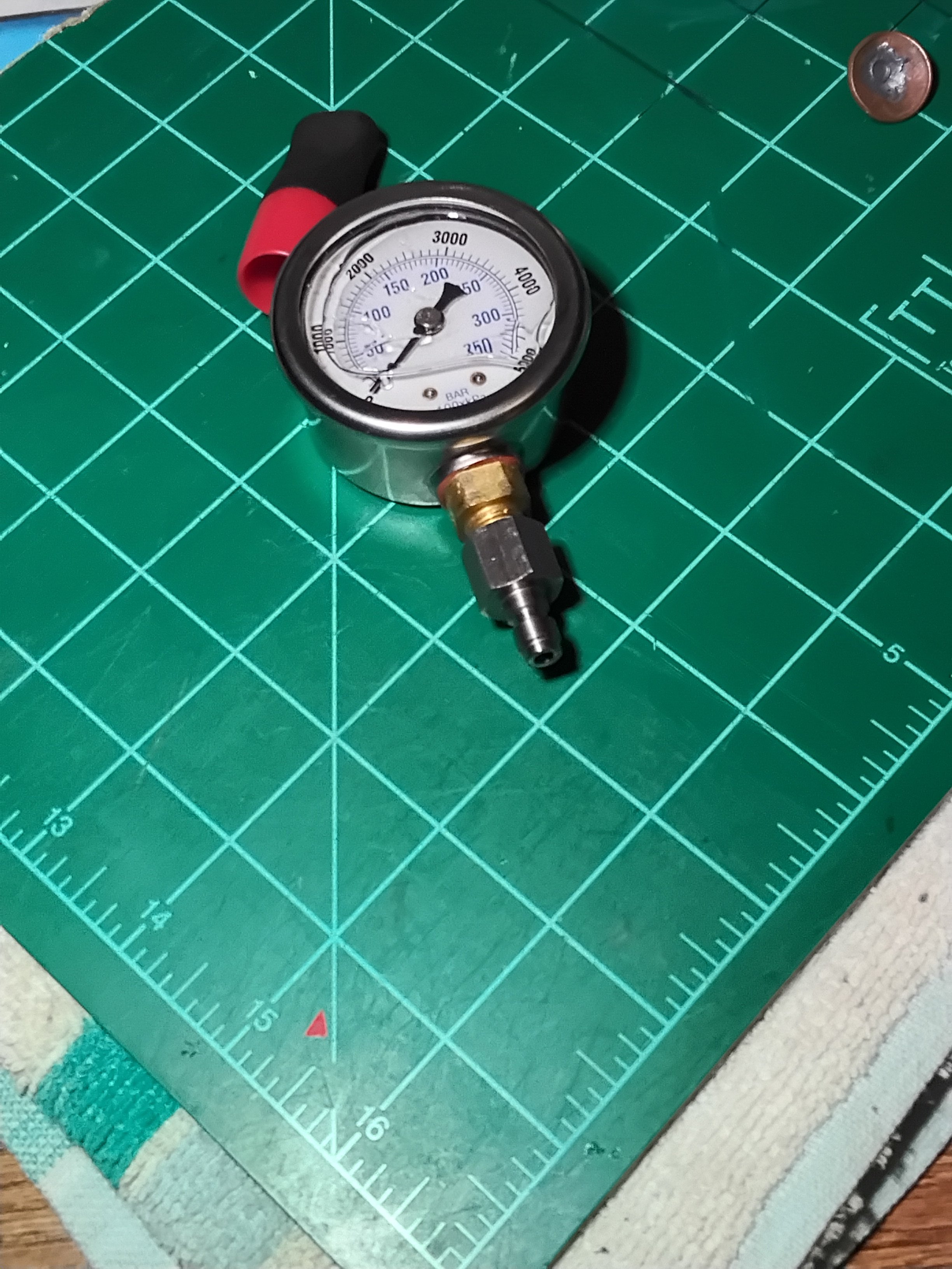

This is what I use. You don't need the most expensive gage as long as you use the same gage for all your testing
