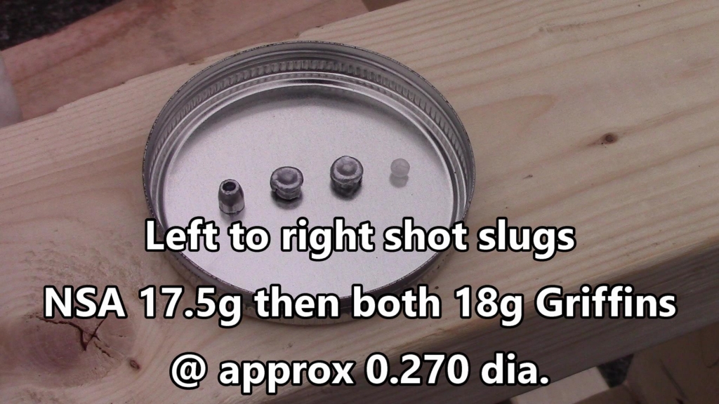

The .22's
1582330745_19659930325e507379a914d8.97797965_NSA & Griffin .22 cal LDC Shot Slugs.jpg

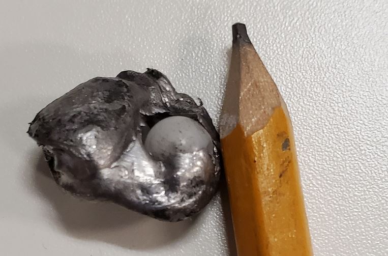

I picked up some 135 grain boat tail LDC.
I recovered one after shooting into shredder rubber at about 905 fps. (247 ft. lbs or so) Wow.
I am not sure about accuracy...the above was shot at 30 yards...and was as accurate as NSA amo. But the Griffin had a lot more expansion. It is possible it hit another pellet though. (UPDATE: It did since it weighs more than when I shot it).
