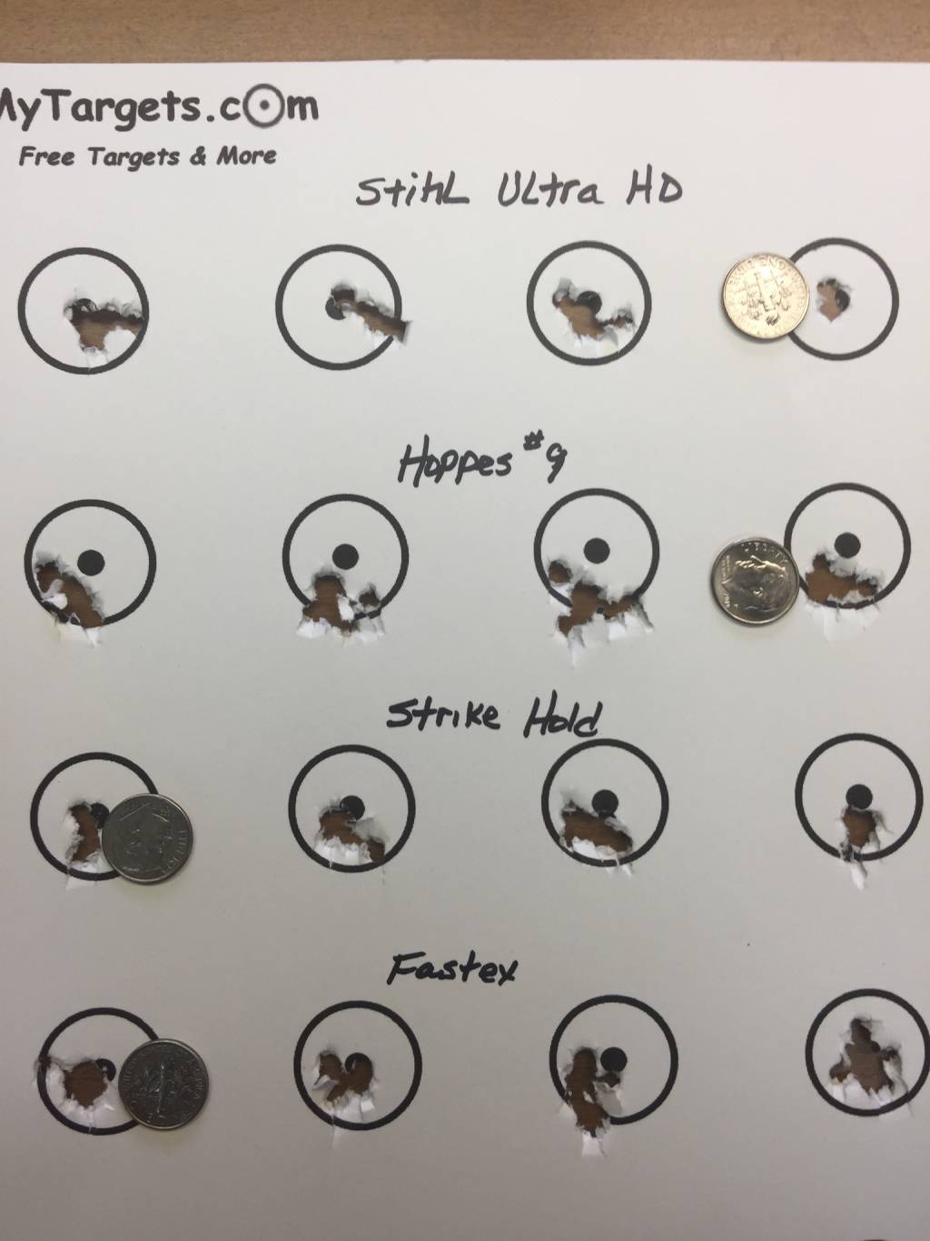

Testing info on 20 different lubricants

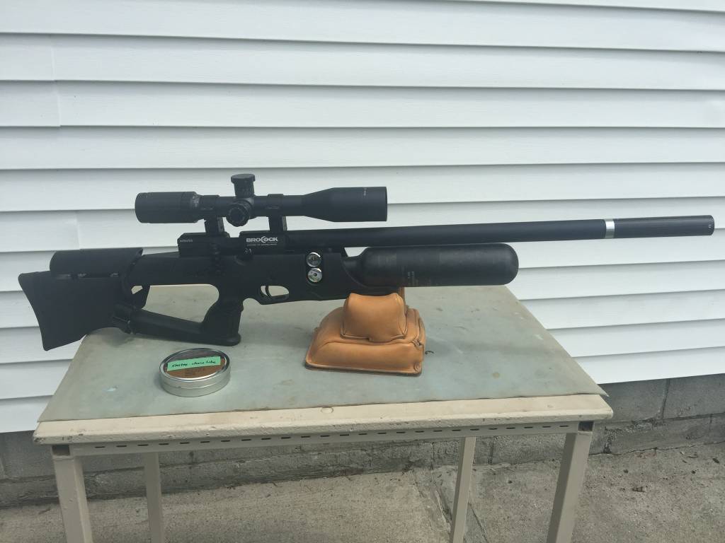

Had a bit of free time today and shot these groups at 40 yards, Hades 15 grain, Brocock Sniper XR, SWFA 6X scope, 765 FPS on power level two down from hi.
Ten shots in each target except for bottom right which has 20 shots in it. I was having so much fun I didn’t want to stop. The top right must have been when all the planets and stars were aligned. I couldn’t believe my eyes 👀
I’ve been using Lemon Pledge myself for a few years and similarly find that it is certainly less messy than other products. Strike hold is a dry lube that goes on wet and leaves a dry film behind. Since I was in a hurry I shot the above with the product still wet. I have some Strike Hold coated pellets laying out to dry and will try them in a few days to see if I get similar results.
The Stihl oil had the weirdest feeling of any oils that I have tried so far. It leaves your fingers with a very slippery waxy feeling. It’s difficult to describe in words and it stands out as the most different feeling oil of the group. I have been using this product for years as a sprue plate and mold pin lube on my bullet casting molds. It holds up better to heat than any other sprue lube I’ve tried to date.

Interesting chart! I'm sure it took you a while to compile all that information. It would seem that one could conclude that the top few products on your chart made your barrel easier to clean, or perhaps even prevented lead fouling. To me, that would be reason alone to lube pellets.
