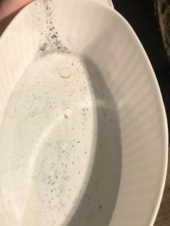

I use fp 10 to oil my pellets, Been getting crazy good groups cleaning my crossman hollows 22 6 dollars for 500 on amazon Im always shooting this avenger bullpup just pumping it but compressor coming. Look at the amount of shavings from factory when I used some dish soap an washed em around with my hands lightly an swirling em for a couple mins poured em into a sieve here is a pic, after washing them I take em to the shower where the shower head has a bit of pressure so for a few mins I shoot the jet while moving em around in the sieve removing the rest of the shavings if any are stuck in the skirt, After I do this I dry em an oil em using a old cotton tshirt I cut into a rectangle an drizzled fp over it evenly I grap 2 corners of it in each hand an just go up an down an they move around in the rag oiling all the sides evenly for a minute or so, After I really feel like I get a primium feeling pellet like theyr all nice no debree oiled up slip in my carm mag so easily past the lip cuz of the oil and I believe it creates less friction in the barrel as it rides down the rifling I mean Im hitting a group of pinecones about 3.5 inches clump 3 times in a row at 146 yards with these .22 14.3 grain crossmans tuned in such cheap shooting pellets really feel a bit more premium after the wash an the oil. See you guys talking about using slick 50 I aint heard a that is it better than fp10? I know fp10 lubricates good metal on metal.

Check the amount of dust/shavings from the crossman primier hollows .22
Awesome idea for testing! I can say I still continue to be surprised by the lubricity of FP10. That stuff is SLIPPERY! Interested to see further results. 😎
I know right fp 10 is so slippery, I notice its even also easier with lubed pellets to push the probe forward seating the pellet into the barrel as there is noticeably less friction.
