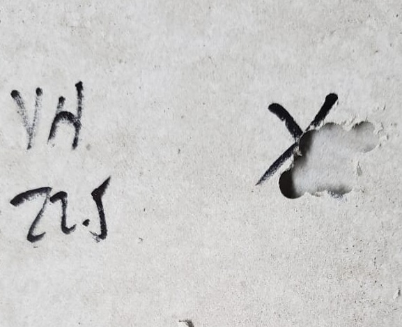

Actually if you check my last test post, success with 22.5gn VK and Slow! and Pellet liner! 1:19 will see I have to test more, but if is consistent is great due 3 reasons
1- is a pellet liner, so no need to buy slug liner
2- Speed is normal, no need to power up (840fps any stock impact can reach that)
3- Slug will be devastating on game, and of course the BC
But further test needed to be done! today I will try 75 and 100 meters, but I have like 20 slugs left only, and more in the way
I need to get a 1:16 liner, and polishing the 1:18 liner, fire lapping compounds in the way
NSA 21g 50m
This is an upside down world
Last 10 24gn, 1 to test speed 850fps, 1 to aim, and 8 went like this in 44yds with the pellet liner
Crank the reg to 140, last 10 22.5 gn in 84 yards now, no fine tune, pellet liner, 950 fps and

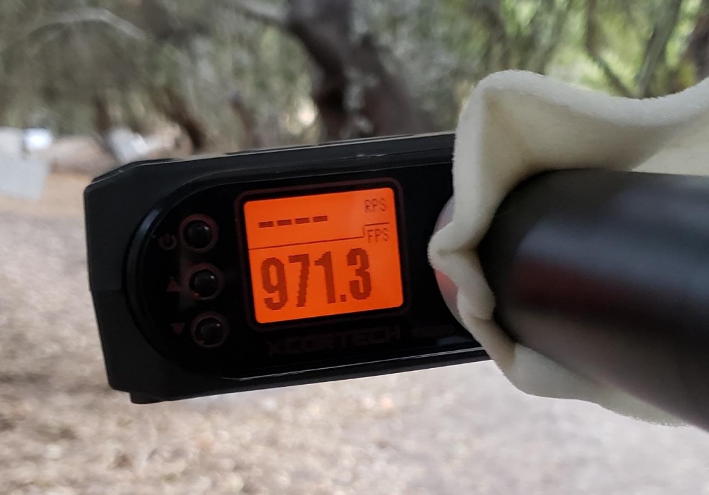

I crank the reg at 155, put a JSB monster to check speed, shoot it a couple of times and (600mm barrel)
1554726360_12704065775cab3dd8a18df3.17140351_478904bc-7ab6-48e8-95c3-b46008833cbc.jpg
So It can easy go over 1000fps with the new ValveTube and a 700mm barrel

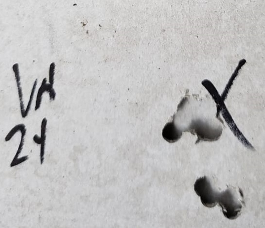

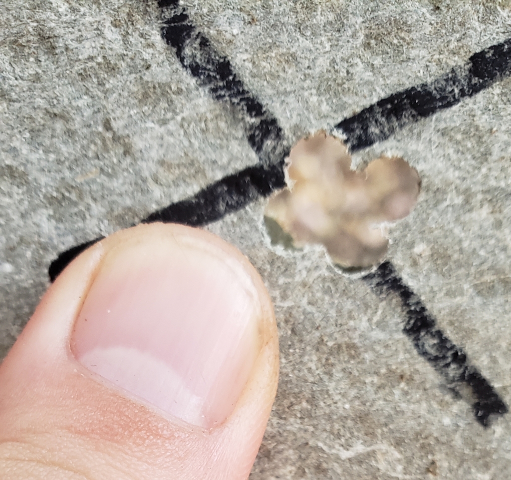

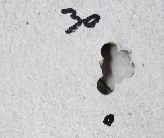

Anyway, shoot a couple of rounds before the light went out @50m 55y from 22.5 gr to 30gn and it looks pretty good, on 24gn there are 2 groups, no need to measure, each hole measure 0.22 ;)
