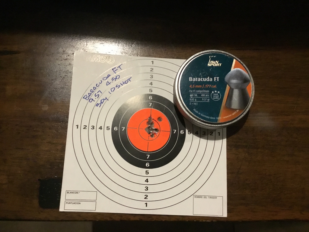

And finally the new pellets. Another pellet with “FT” in its name. H&N really focuses on FT as they offer several models with that destination in the name. So you gotta try them if you shoot FT, right? These even claim “hand sorted quality” who doesn’t want somebody else to do the dirty work? Count me in!
I’m impressed with these pellets. The group was slightly larger and had the one zinger at 2 o’clock but are the closest group to the Baracuda’s I’ve shot so far. My shootin buddy and I are going to do more testing tomorrow with his gun and I may take mine along and shoot a few more of these and just see.
