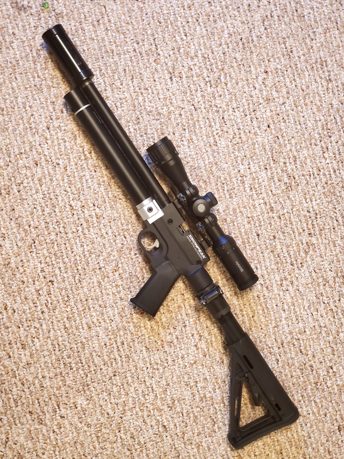

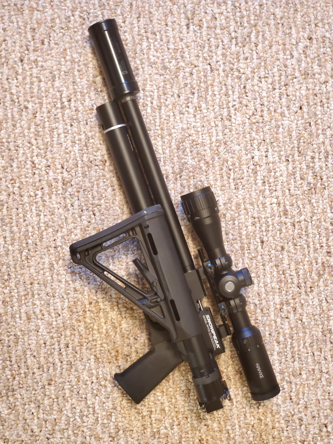

I prefer the PP750 anyway simply because it has the charging lever on the correct side. The furniture on the Notos is nice, but the folding AR conversion from Buckrail complete with Magpul goodies is nicer. With it and a removable moderator, the PP750 becomes a very nice backpack gun. Basically a poor man's Leshiy.
^^This has a full shroud length barrel and plenum/gauge block from airgunarcheryfun and makes as much power as the Notos in a smaller package

Thanks for posting your photos. I noticed your gauge block without the gauge. I've been wanting to remove mine but didn't know how I was going to do that until I saw your pics. They reminded me I bought a grub screw set off Amazon and I can remove the gauge!
Thanks again!
That PP750 is looking pretty good!

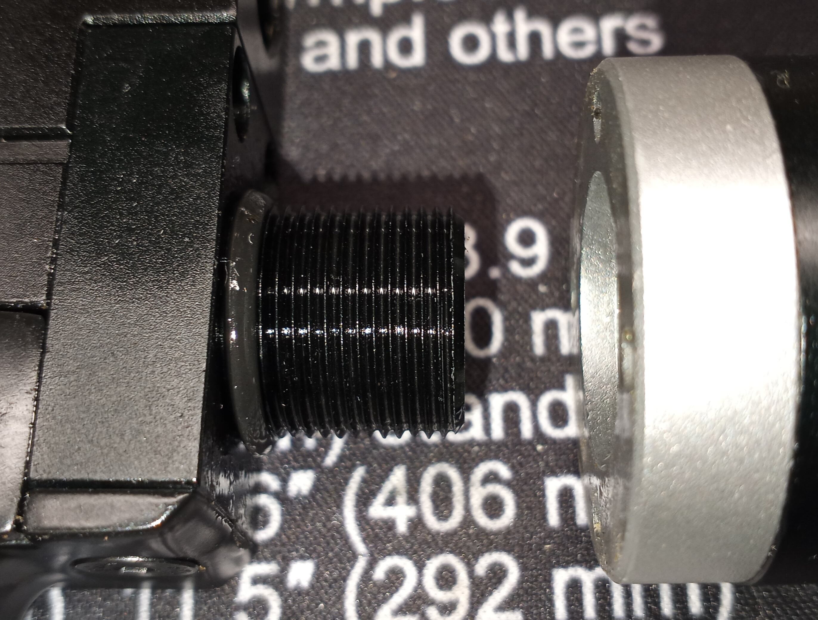

Hello, I hope you are well, I am thinking of updating my notos with a new valve and a carbon fiber tank, the question is the following:
I see that you placed a Z and I wanted to know if the thread measurement of this valve does not require something additional to connect the rifle block with the valve?
This information will help me a lot, greetings.
The aftermarket drop blocks/Z-blocks are threaded to M16 x 1mm female, the guns air block is male, they just screw together BUT the drop block needs to be tapped further to accommodate the air block.
The "secret" is that the blocks are not made to clock correctly to the gun, the blocks have to be faced on a lathe to correctly clock them and allow alignment and provide a good seal on the o-ring.
Here is the male end of the air block on the gun and the OEM tank.
