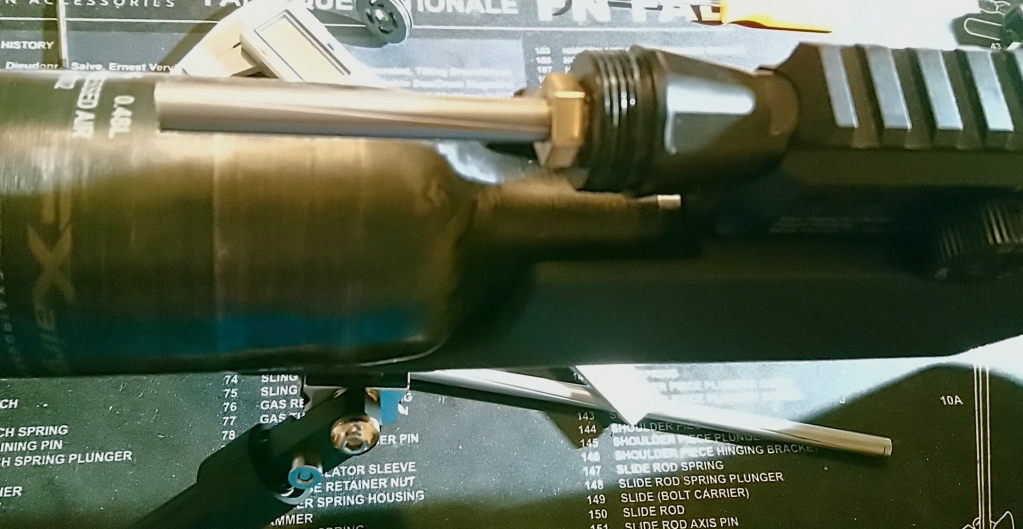

Did some testing on my own, as I had a spare 700mm FX pellet liner.
1571005530_8969086785da3a45aaff4e6.11938978_72237093_401302800545813_1520368240386113536_n.jpg
Test mule was a 15" (380mm) FX Crown barrel. 16gr JSB hades baseline was 670fps at lowest setting 960 at highest.
7" average was 535fps low, 800fps high
6" average 515 low, 760 high
5" average 495 low, 700 high
4" average 460 low, 650 high
With that info, 5.5" seems a comfortable length to achieve target speeds of 550-600fps

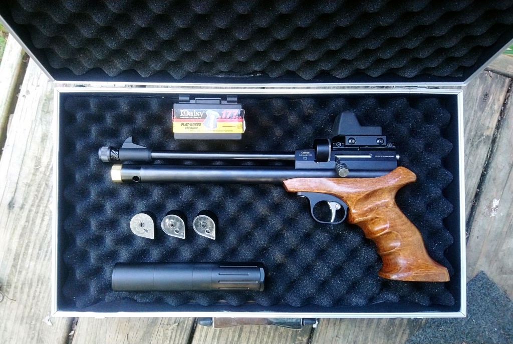

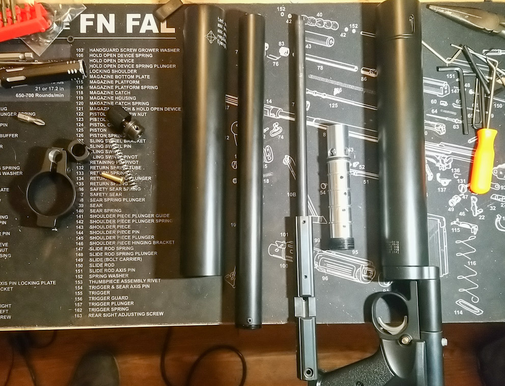

Look at the top of page 3 in the Trail/pack small game topic in the pistol forum. That's my pistol. I wanted a more compact balanced pistol which the PP700 is not, to tote with me when I have to go investigate a downed critter or when I am just outside doing stuff. I wanted something that I wouldn't feel guilty banging around unlike my AP16. The valve on the gun has an adjustable spring. What a wonderful feature on such a cheap gun. A small compact gun is going to have a small air tank. A unregulated small air tank is worthless. Your shot string would look like a tire going flat. You never mentioned what kind of platform you are building this pistol around. If you want to hunt small game, you need accuracy. A tiny air tank under a 6" barrel unregulated wont have enough shots to have a bell curve. Especially since you are swinging for the fence velocity wise.
Ah, OK. Looks like you put a lot of time and work into that pp700. Can I ask how you went about shortening the air tube? I don't have the proper tools, so just figured I woukd have to get with a local machinist.

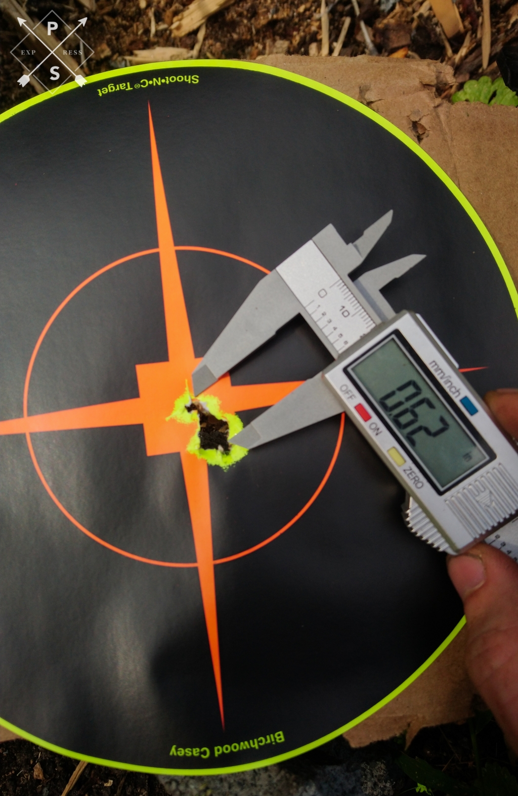

Here's a 5 shot string off my unregulated .25 pistol. 20 yards 625-670fps 25gr. It's not inaccurate. And I recon I could get more like 10 or better with shot placement like this in .22 the drop in POI after is very predictable on this 25. I'm fairly certain if the barrel was choked it would not be.
