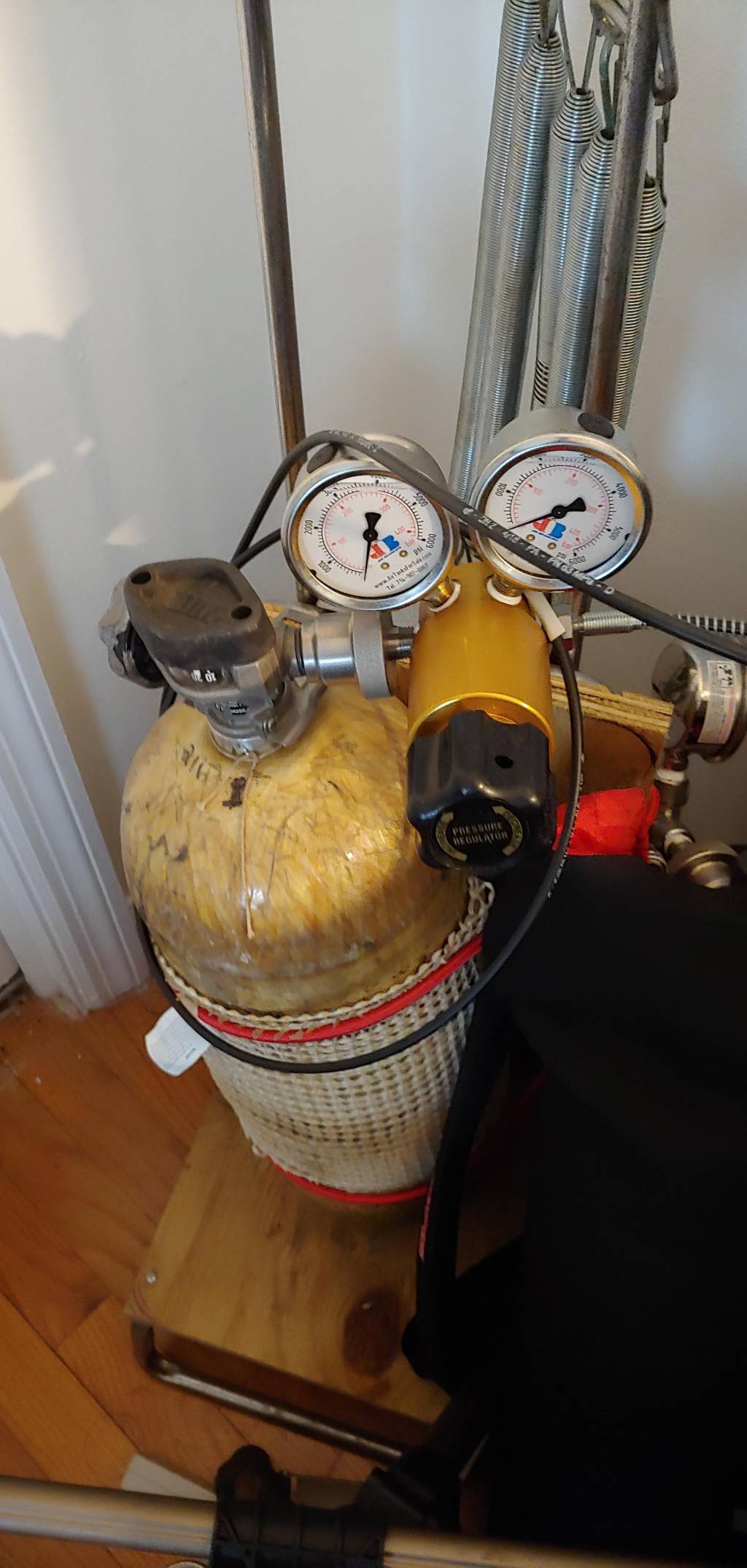

I use an Aqua Environment Co. # 415-5000. for $275
Bought direct from them...
You supply the gauges of your choice and adapters to attach to your tank and supply your Airgun...

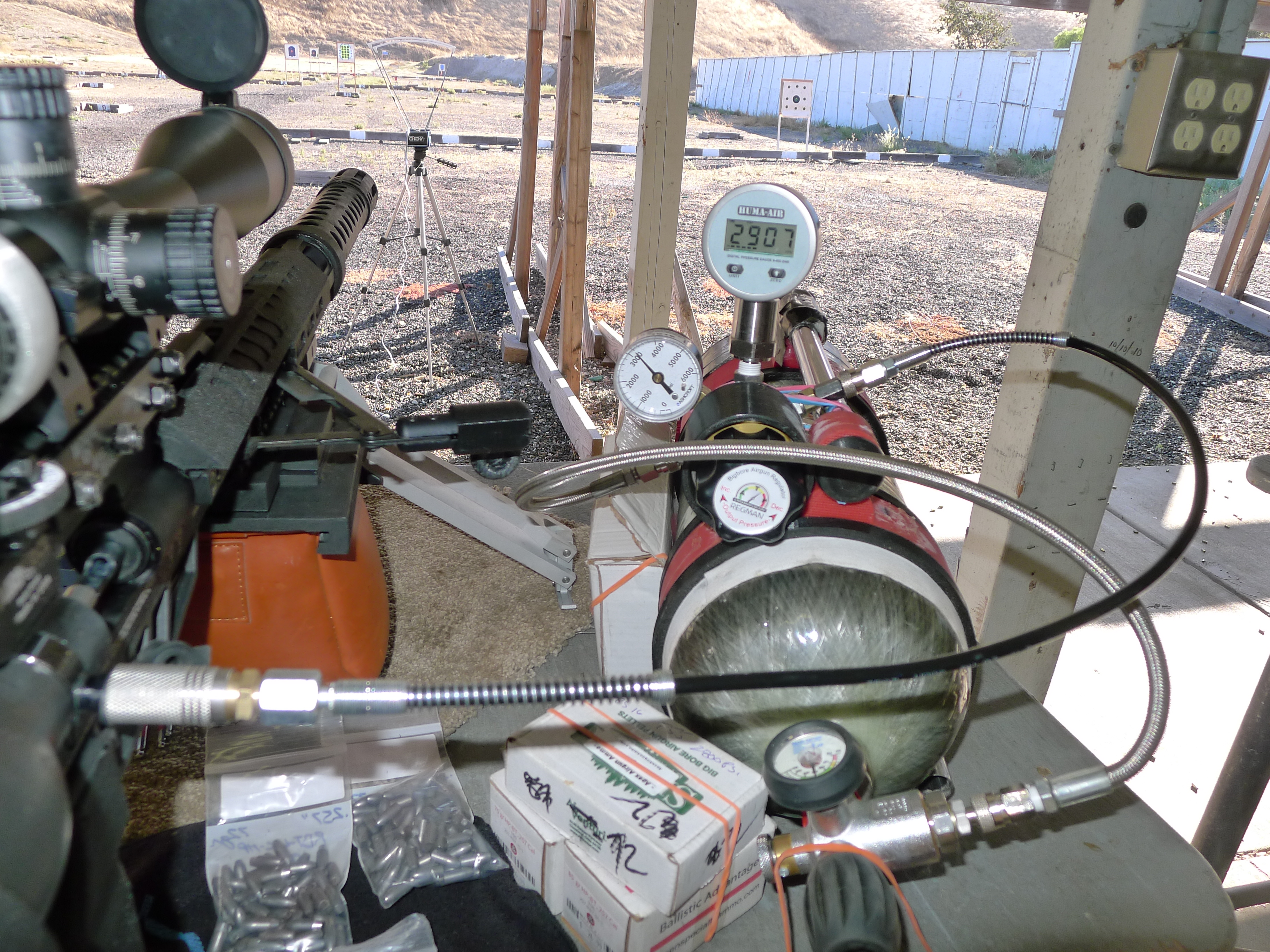

I think a tethered tank with a reg on it would be nice for long shooting sessions / big bore guns, but an extra $80 / 88 cubic foot SCBA tank filled to the max pressure on my gun should be plenty of shooting for my current needs with no need to pause and fill. I am sure the day will come when I will want a regulator for tethered shooting with a big bore of some kind....leaning towards 35 cal at the moment.
does everybody shoot as fast as they can ? like a mag every 2 minutes ? really i can only see a tethering for a match like Bench rest . but not at home or practice range .
My Gauntlet 30 will only do about 24 shots until it drops below the 2800 psi regulator and velocity starts to drop off, so for shooting sessions where I will be sending maybe 200 down range at 100 yards, a tethered bottle would be nice. Not sure how to calculate the number of shots before the tank drops below 2800 psi, other than trying it.
