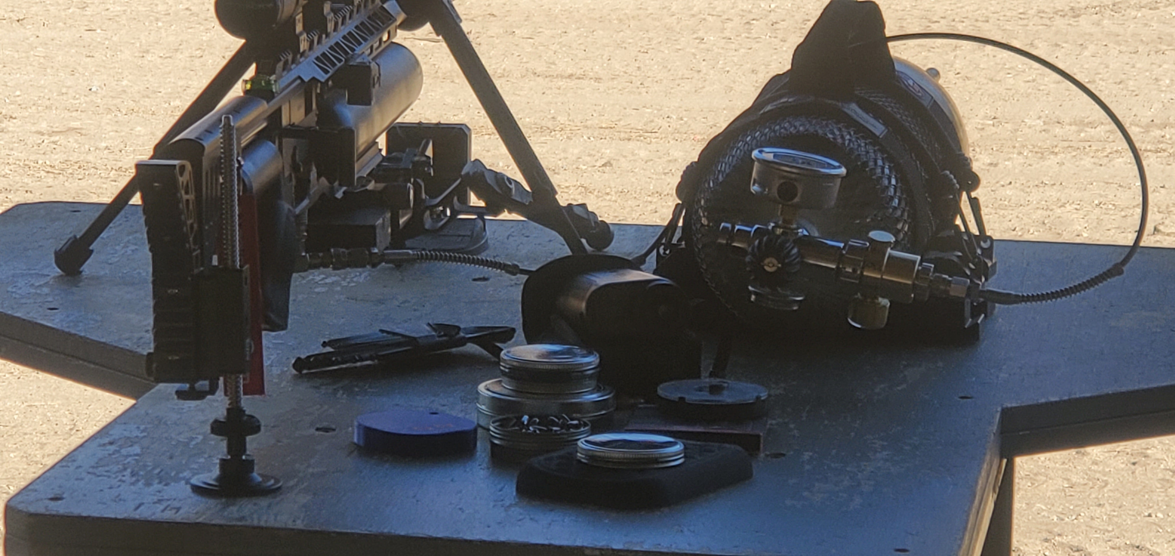

This is how much sticking out from the tank when it is mounted, me removing when not in use.

@bigHUN I was thinking of it being bumped or accidentally turned while sitting on a table and connected inline mid-micro bore hose like Tom has his in the video using a DIN-to-male-foster-fitting on both ends. I’d probably set mine up like yours with the reg directly connected to the DIN threads. Thanks for you input. I’ll make it a point contact Huma to find out the difference between the two regulator styles. Twisting the body seems like a good way to keep the reg more compact. I like the size of yours. If it doesn’t have to be big, why have a bulky regulator? The only thing that really concerns me is what’s offered for the price difference between the two models.

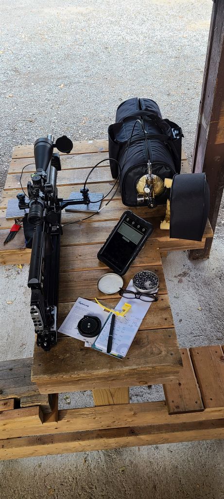

This is my 147cc scba tank, I never calculated the volume but I am refilling these after 5-6 visits to my club, usually about 150 shots a day. It can hold the pressure my rough guess 7-800 shots to drop below 180 bar??

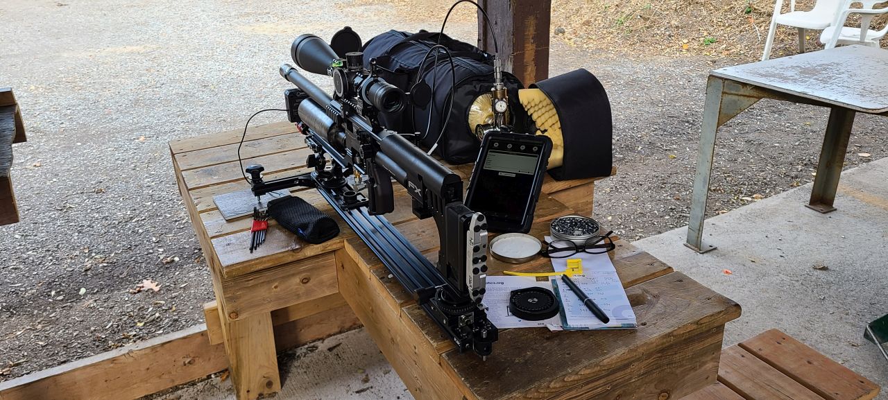

@bigHUN My situation is different. I shoot in various locations and I use a small, portable, folding, plastic shooting table. Because I don’t know how it feels to turn/adjust this regulator it’s hard for me to envision how this setup would hold up.
For example, I was looking at the length of Tom’s fill line in the video and wondering what would happen if the reg got knocked off the edge the table or something. He had his situated in the middle of a relatively long fill line, not mounted on the tank. What if it was swinging off the edge of the table and bumped one of the legs? Could that cause it to turn and throw off the adjustment? From what you’re saying and what he says about it feeling tighter under pressure it doesn’t sound like it, but I don’t know.

You just screw in the Huma to a DIN by the lower SST part (left arrow) with two fingers,
and the upper brass portion (right arrow) turns around 350 degree (360 minus maybe 10 degree), that is your preset pressure 120-180 bar in Medium setting (I don't remember offhead what is a preset for Low or High). In between two pieces underneath is a small dowel that you can remove if presetting to Low or High)
There is no accidental turning on it, you must hold between fingers and turn it, either the bottom Stainless or the upper brass piece )
What could happen, when you screw in the Huma CW (clockwise) you are actually turning both pieces the lower SST and upper brass, and the most CW end of a thread is the lowest pressure, assume 120 bars. If that happened you just turn the upper brass piece CCW back to 180 bar.
