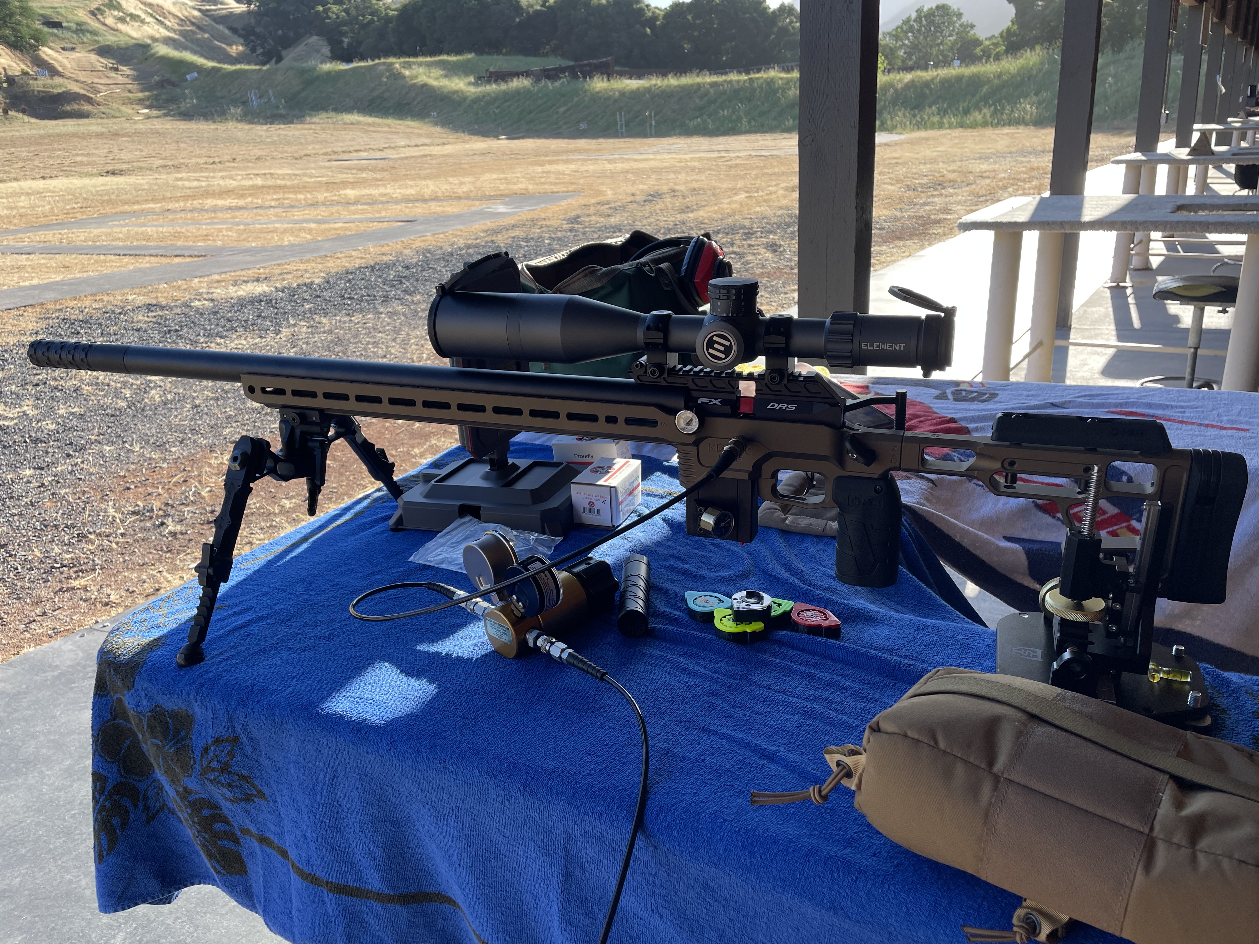

I tether all the time using that valve. Tank to Regman gauge, then to gun. No issues at all. Been doing this for a few years
