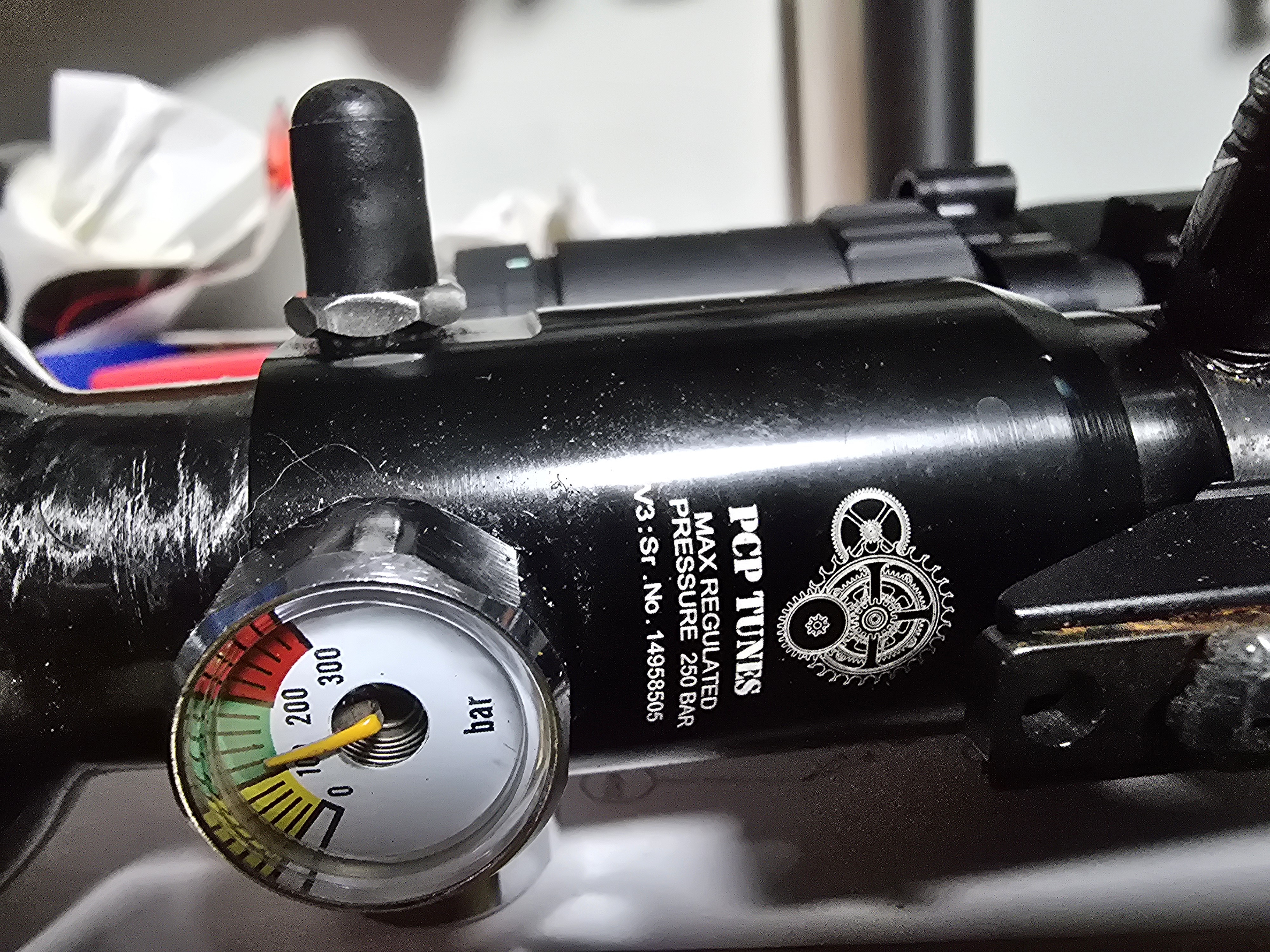

anyone have schematics to break it down and rebuild? mine leaks all the air out after shooting it a few times but stops once it is cocked to shoot again. searching the web and it seems they are non existent??

im going to say yes, gun came this way. i dont know much about airguns stillis that a plenum and regulator between the bottle and the gun?
I think your on to something there he has to cock it to take pressure off of it to see if it then seals up fasterI think that the plenum is filling up too slow after you fire the gun hence not enough pressure to push the hammer back . turning the regulator should help. Maybe someone will chime in that has experience with these.
Ater looking at the plenum / regulator idk if id use it one spot says 250 bar the gauge shows red after 200 bar just my opinion
Its hard to say there may have been a return spring in the valve that some one left out for power reasonsyea it came as shown. as soon as I cock the gun it seals but if I don't it sits there and empties the tank. and this is literally every few shots it does it
From what I can tell it's a 200 bar gun unless you do the carbon fiber tank and then you can run it at 250. this was a built gun so I assume the gauge just never got changed to match
I agree hopefully some one with more knowledge will chime in on the v3ok maybe you can back off the power wheel a turn so the hammer spring will have less preload but if it were me id figure out how to adjust the regulator someone on this forum knows all about that v3 regulator you got
