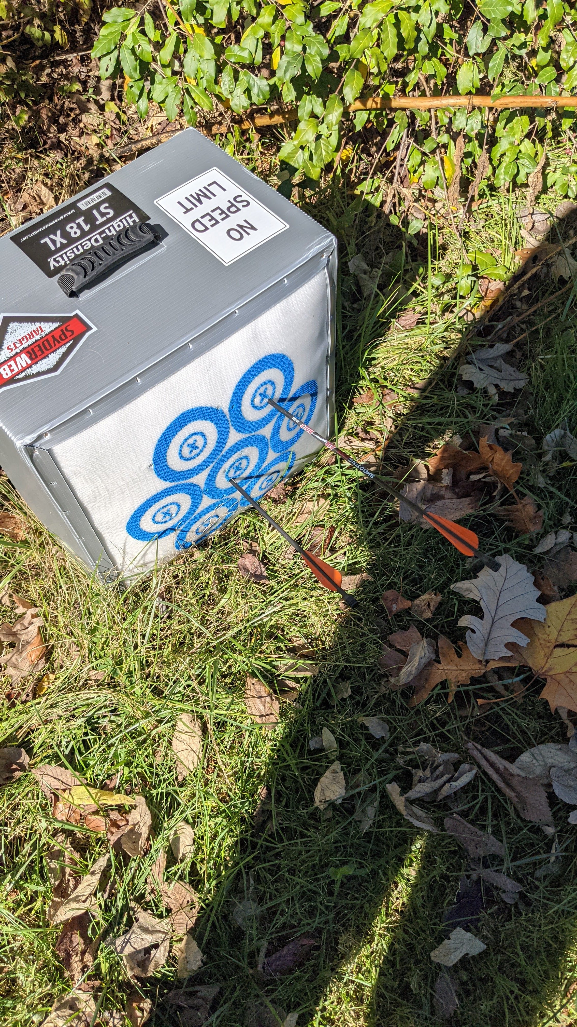

get a spyderweb target. My "no speed limit" one will stop my 300fpe (power tuned 909s) air bolts at around 6".
Reactions: Ezana4CE
