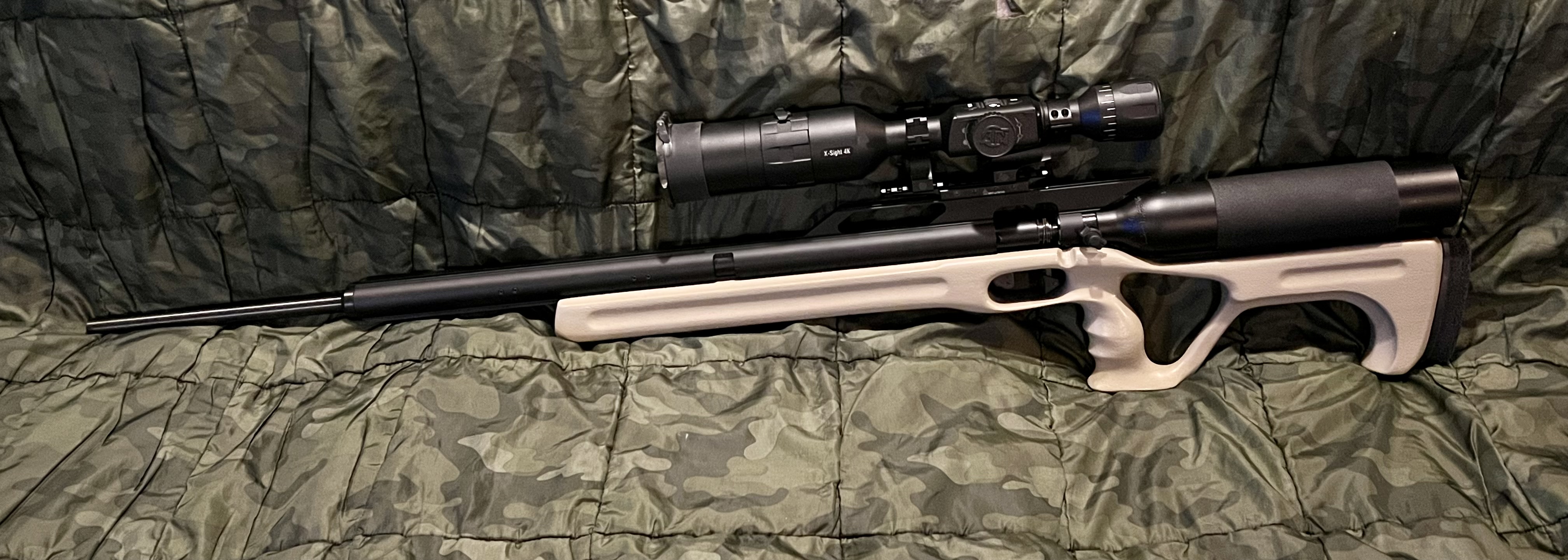

This is a pic of the .457 before modifications.

I like the current stock as well. I have a 257 texan in a ranger stock, another .457 in a ultima long walnut stock, so figured I'd give the recon a try. Hopefully it will be a good mix of benchrest and field use, if not, I'll just swap back to this tan stock it came with for field carry and recon for longer range if needed.
