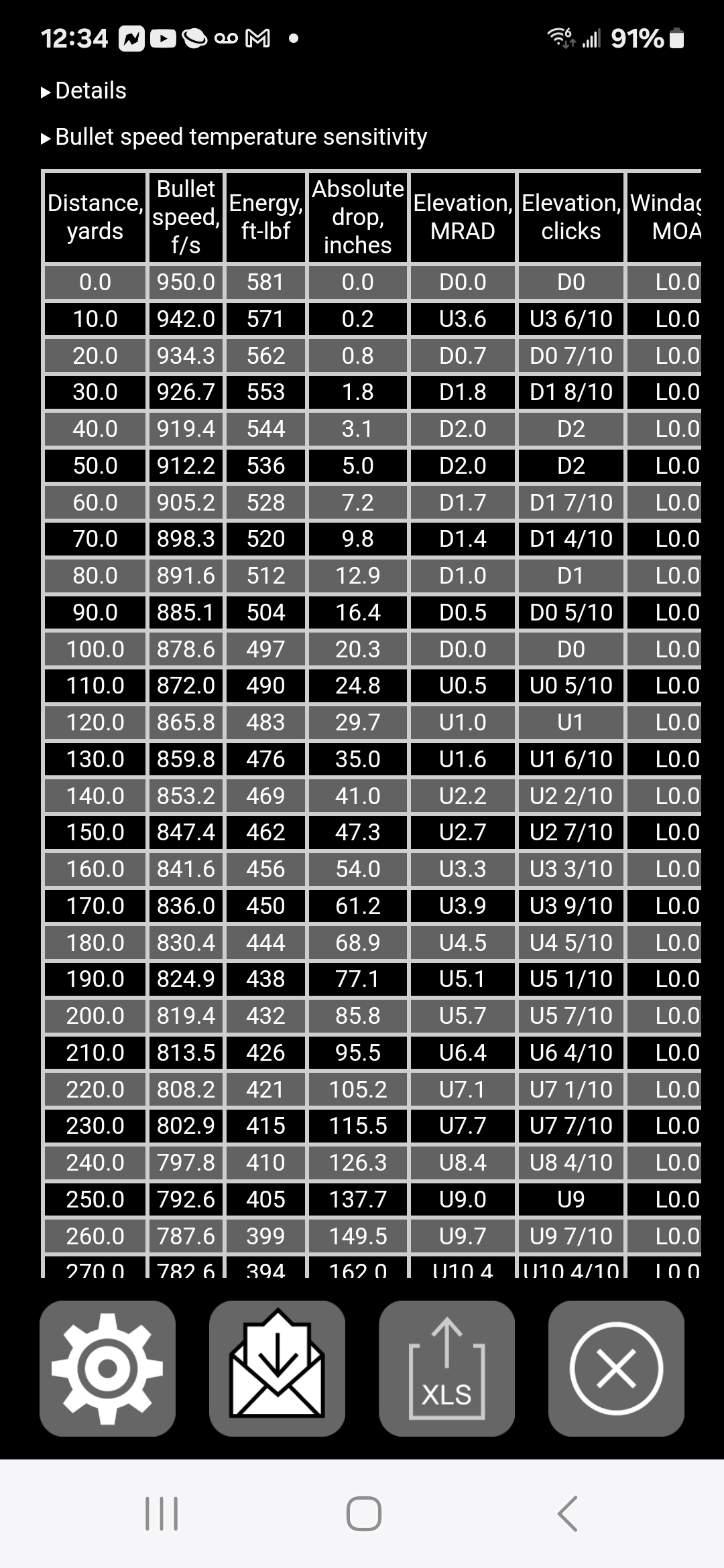

Does anyone have idea of what trajectory ofa texan 457 ss with a Nelson 290 hp slug out to 200yds if zeroed at 100yds? Thank you
You need to buy a chronograph..There getting pretty cheap...I use www.JBMballistics.com for drop chartsAirforce texan. Vortex strike eagle ffp 5x25x56 1 in rings 290 gr Nelson hp slugs . Haven't shot it yet so I dont have any fps
I have 1 on the way . How do you think it will look closer if zeroed at 100? And thank you so much. I will be shooting it alot and will be hunted with alot as well on whitetail.You need to buy a chronograph..There getting pretty cheap...I use www.JBMballistics.com for drop charts
I would zero your big bore for 50 yards...I have 1 on the way . How do you think it will look closer if zeroed at 100? And thank you so much. I will be shooting it alot and will be hunted with alot as well on whitetail.
Is there anything else I should know before shooting it? Thanks so muchI would zero your big bore for 50 yards...
Keep your barrel clean.....Is there anything else I should know before shooting it? Thanks so much

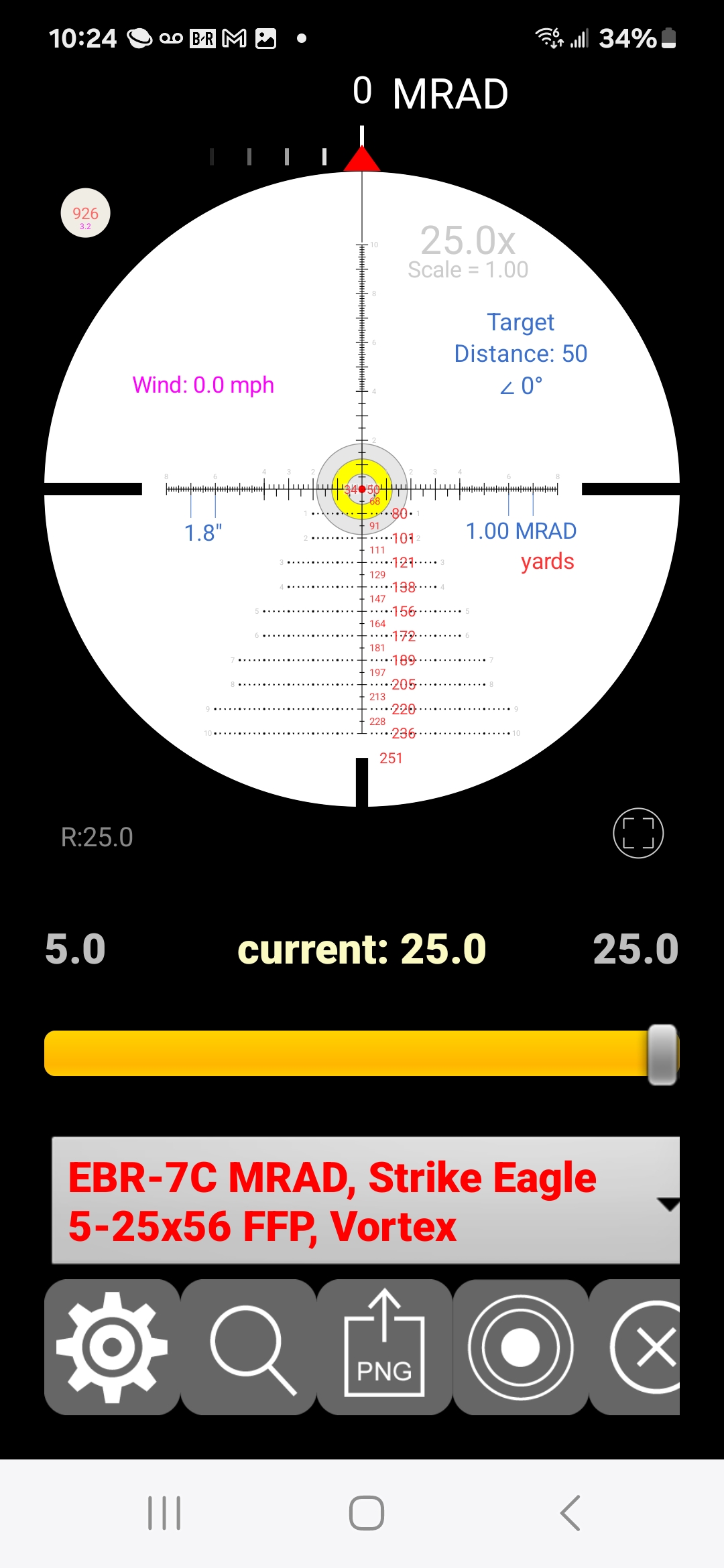

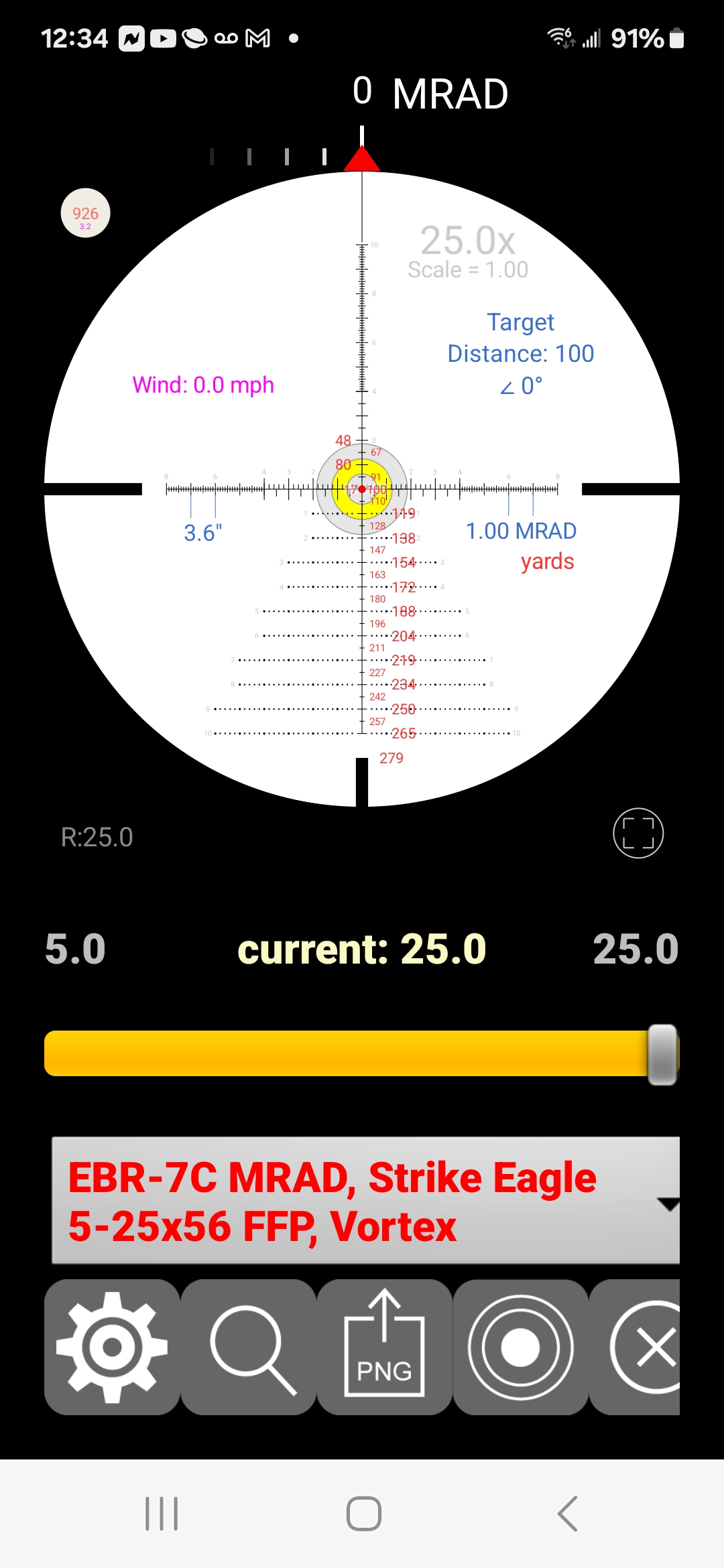

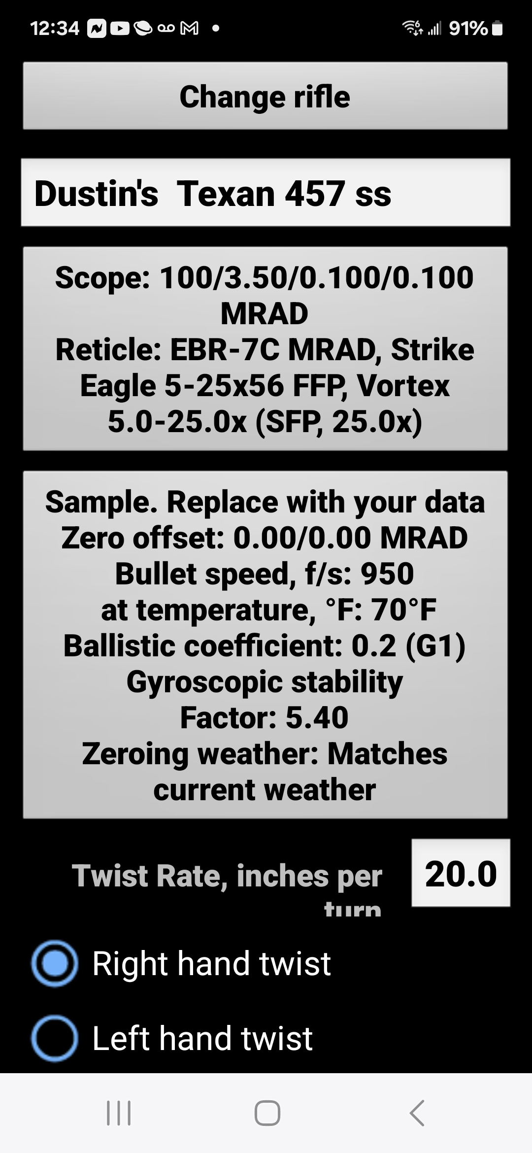

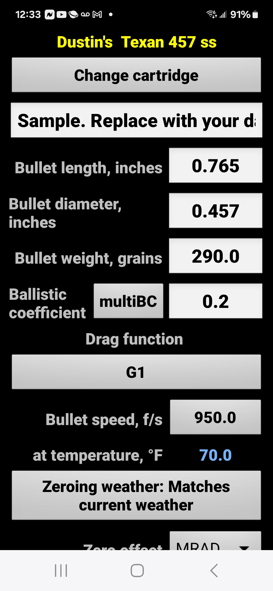

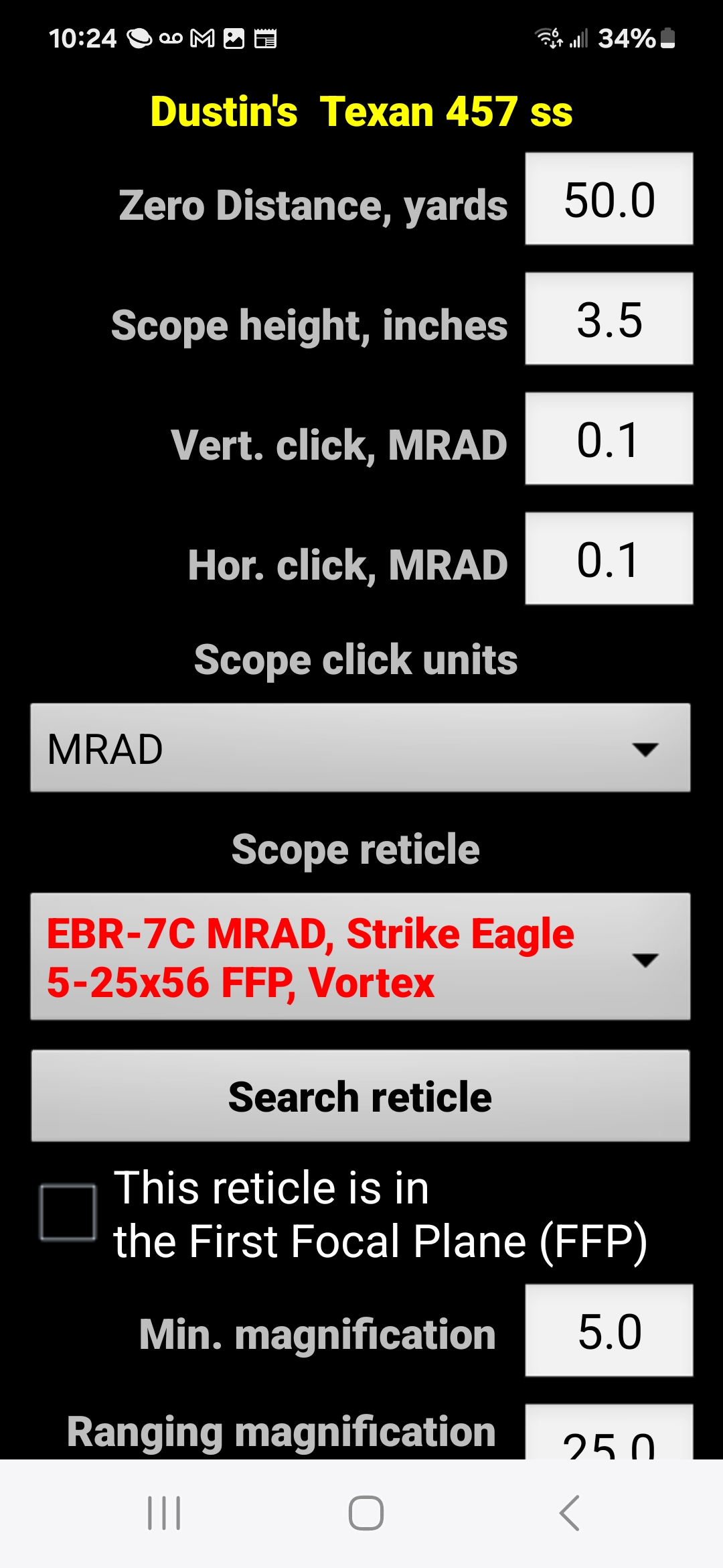

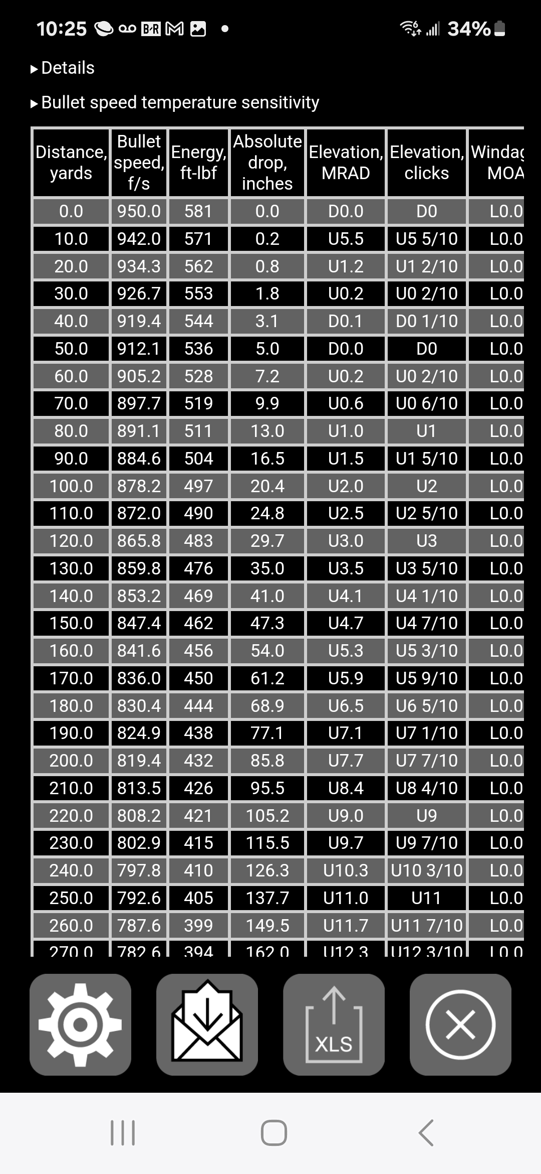

Thank you. Have you found that cooler or cold air has much effect on trajectoryThe data IS zeroed @ 100 yds. See reticle and cheat sheet.
