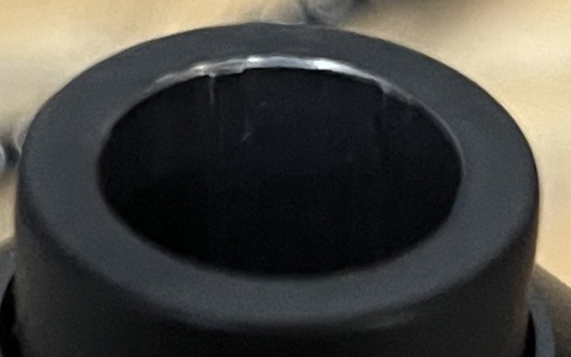

Light reflections can make things look like they aren't. But, if that is actual crown damage don't accept it, don't try to fix it, just send it back on their dime. If crown really looks that bad, a trained monkey could do better.
I opened your pic in another window and it is much bigger, this is just the crown area from that much larger pic.
Yes the crown.sucks. but something I learned in the airgun world is most manufactures just chop the barrel off on bandsaw and there you go. Shooting powder burners and working in barrel factory I've crowned slot of barrels. Yes its important. With airgun s seems like the crown isn't quite as crucial as powder burners. Maybe less pressure . its easy to crown the barrel but I'd say what you can't see inside the barrel is most of your problem.
Maybe this is a.good thing a.visual imperfection that Airforce cannot deny. Your barrel is definitely poop like mine. So chances are the next barrel shouldn't be worse. At a minimum your barrel with need crowned and than lapped either by hand or fire lapped on slugs. starting at 120 grit. To get any kind of decent repeatable accuracy. If you go the warranty route I hope you have better luck than me. I would only send them the barrel. Shipping is expensive for the whole Texan $75.00 that you don't get back. Here to help anyway I can
