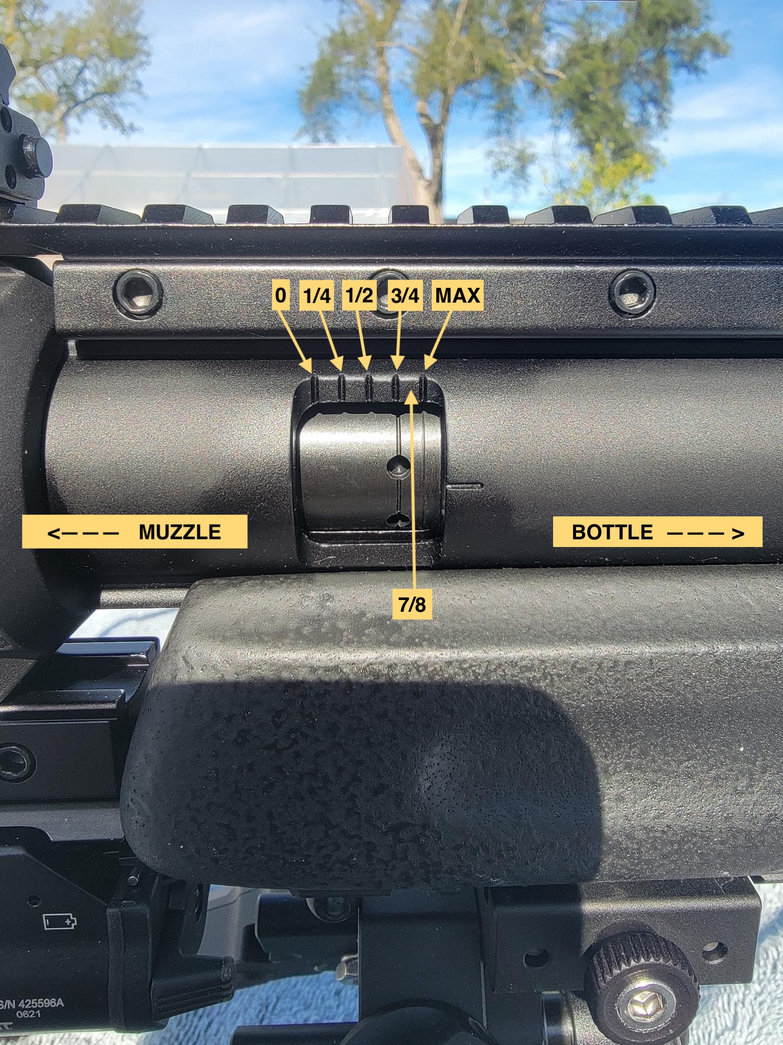

Now, your fill pressure and power wheel when tuning will give you the results you seek. In my .457 CF TX2 long barrel, I shoot a variety of ammo but right now I am using my 324 grain solid nose cast bullets. I fill to 3450 to 3500 psi and wheel at 7/8. See pic attached. I size my cast bullets at .45720 which is the groove diameter of my rifle.

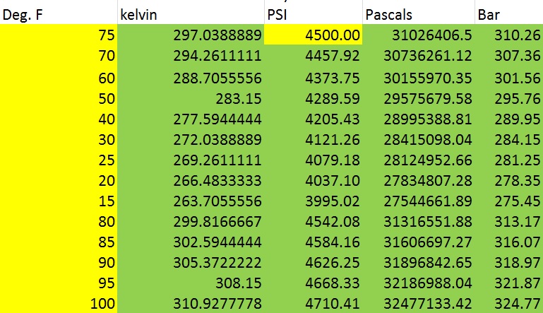

I think hot temperatures suck worse, have to leave house with very low pressure in my Texan so it doesn't heat up enough to get into valve lock. Just plugged 4500 psi fill in my spreadsheet I set up for hunting with my Texan to check expected temp swings in my planned hunt and what pressure to fill to before going out. Yellow background are the variables I type in, green is calculated. All formulas for pressure/temp calcs in closed system are in kelvin and pascals, so have to do the conversions. The formula is very simple, just look up the conversions from one unit to another.
P2=(P1 * T2) /T1 Temperature and pressure are in Kelvin and Pascals. Alternatively, it is linear, at least for realistic temps. Change is just a tick under 42.1 psi for ever 5 degree temperature change.

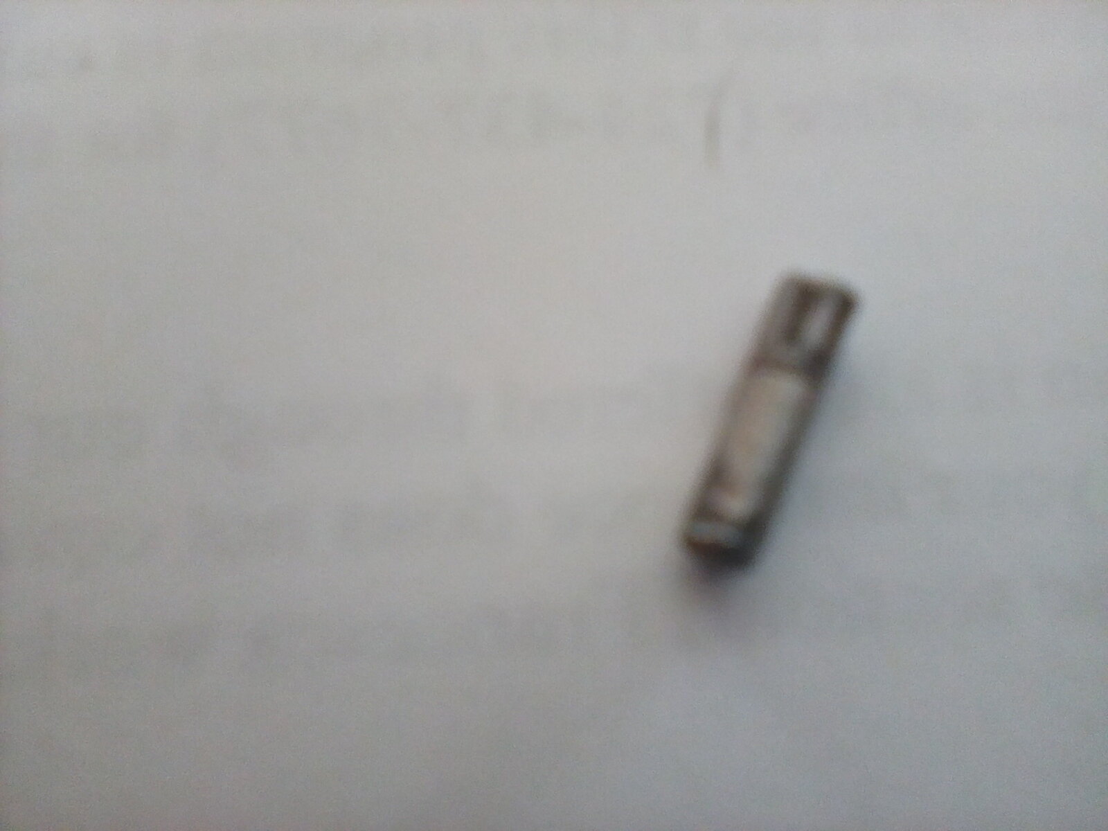

When I hunt I leave my Texan in the car and then fill it. When target shooting like I do taking my scba tank tethered I loose some a good number of shots from pressure drop. I do take my 5500 psi Scott tank fill it put outside in cold and let temperature drop the pressure and fill again. Helps but pain in butt... Yes just running tank on gun in heat of summer black bottle and sun definitely raises pressure. We can't have it all with airgun s. Maybe one day we will. I hope to one day get a air driven booster pump and be able to fill up my Scott 5.5 5500 psi tank and will much more room to play... I wish I could run the African Air Ordinance valve on my 50 and get 900+fps with a 650 grain spire point boat tails.. But the way my Texan breaks in stock configuration don't now if its really possible for long term. My Texan has wore out the pin going through the sear now...Don't imagine more powder will do anything but break it faster.. Here's a picture of my worn sear pin.. I had to.find the problem... Don't think Airforce techs are able to diagnose problems... Just skilled enough to change out all the internal parts. Here's a picture of the wore out sear pin!!!! Yes definitely more powder with the 50 than this small soft pins can handle...
Did you ever consider having a machinist make you a sear pin out of a better material?
I have two more.from.Airforce... Maybe harder pin would be better. But better yet it needs a larger diameter pin .. This completely locks up your handle and makes gun non functional... For the price and supposed reputation of.Airforce this is a scrappy deal. I'm sure I'm not the only to have this problem. I just diagnosed and found the flaw in there design. Maybe it ok for under 400 foot pounds. Definitely not ok for the 50 cal. Come on Airforce they can do better!!! I don't think the techs at Airforce even now. They just change out all the parts for warranty. So.at best this crappy small pin cost you $75.00 in shipping to Airforce to fix. That is if they don't make some excuse not to warranty your gun.. For $1200 I shouldn't have to correct there engineering problems.. Not impressed Airforce.. They should spend less.money on content providers making B.S videos and more on actual testing....😥

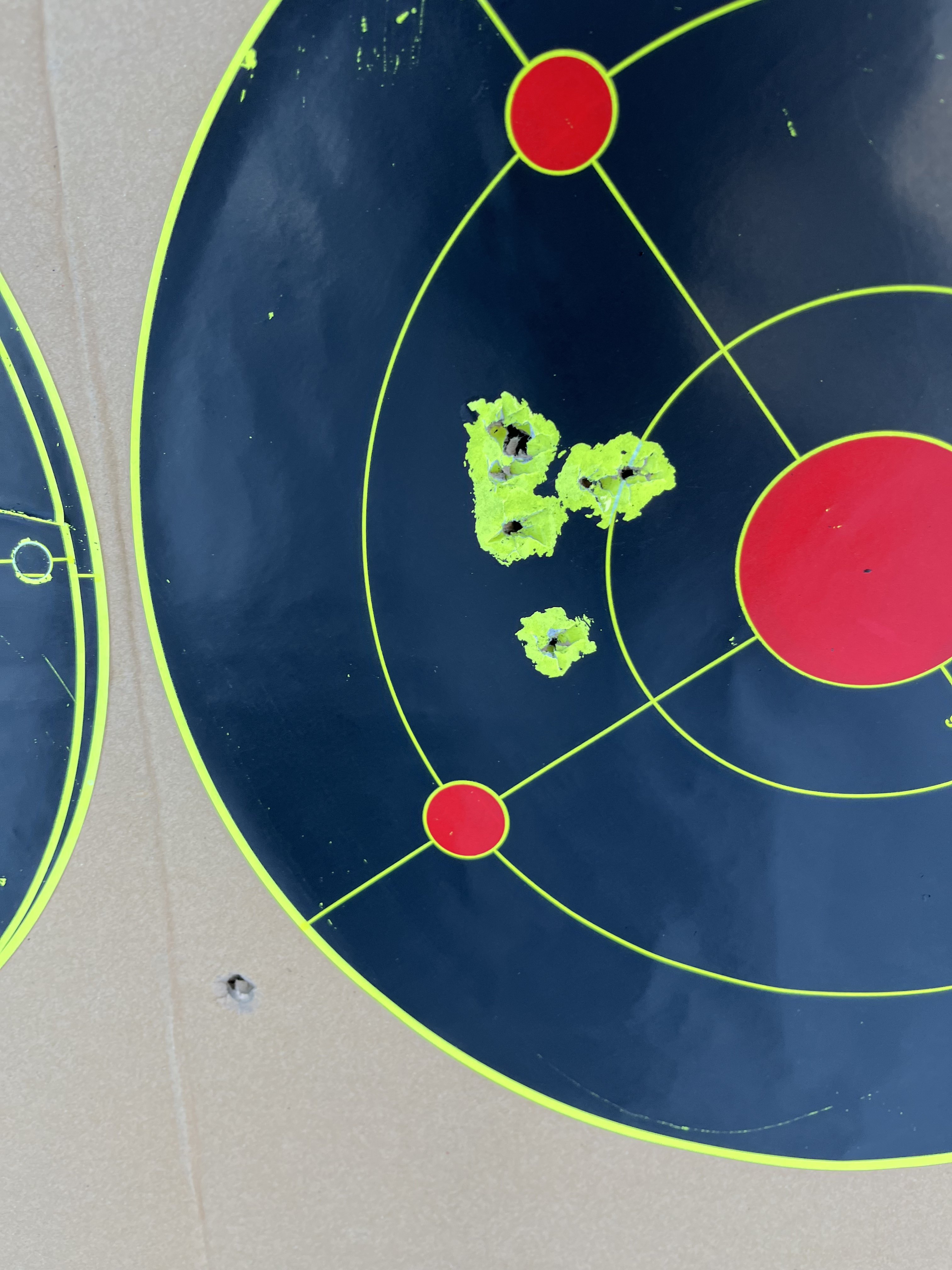

View attachment 328738Todays 60 yard group at 3600psi. I maybe over estimating the usefulness of the Texan.

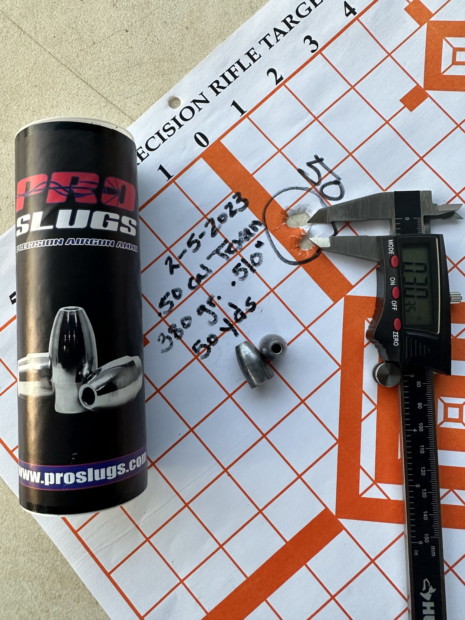

I'm definitely NOT an Airforce fanboy, but I'm breaking in and doping a new .50 cal Texan also. Check out my thread for my range session today. All of my groups were with 388 grain, .510" hollow points topping off with a max fill of 250 bar for each shot. I didn't get good accuracy until I hit the 388s and was ready to turn my Texan(s) into tomato stakes.

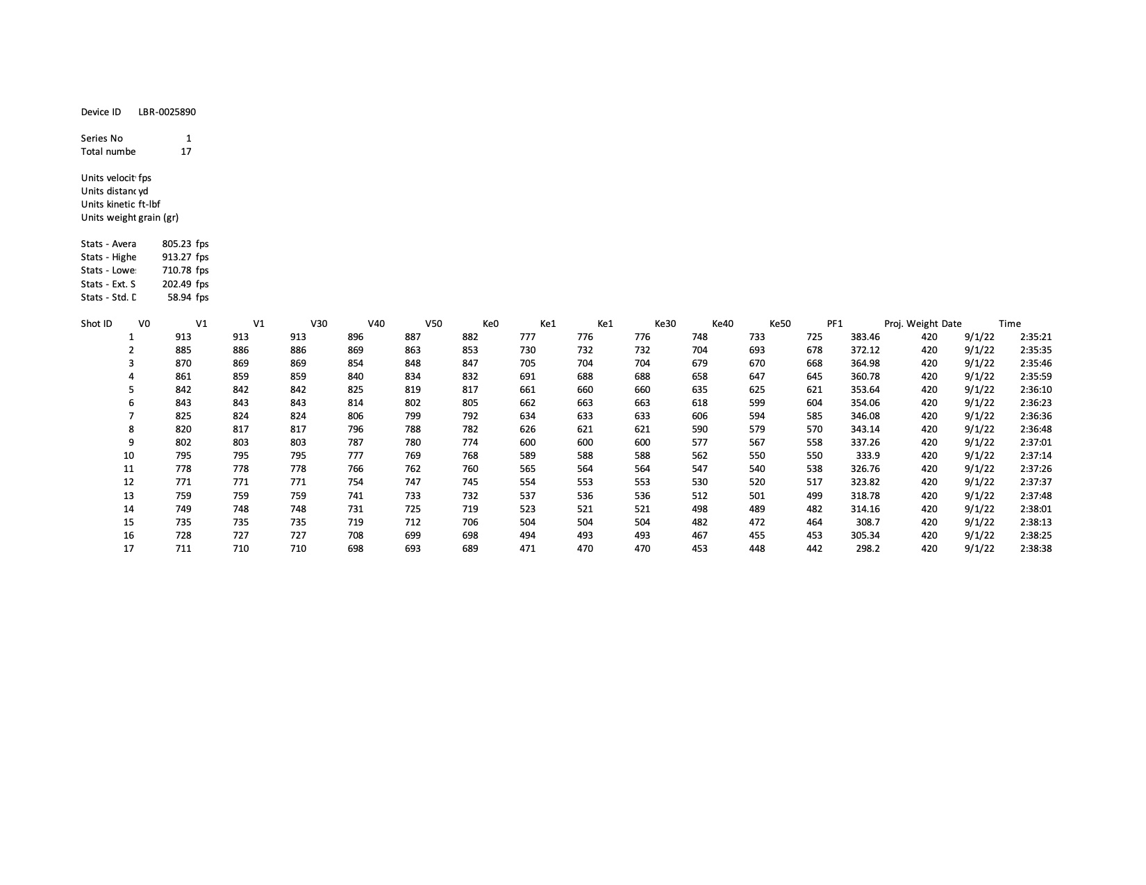

The 50 cal texan will work well with the TX TWO valve and stock barrel, only thing changed on this rifle is a 1.1 liter tank instead of the tiny .5 factory tank. Yes, this is 17 consecutive shots no valve lock. The 50 cal Texan rifle was really made to shoot 400 grain bullets. This shot string is with 420 grain .510 powder coated bullet. The entire shot string grouping will be inside a 3 inch circle at 50 yards. I set this up for hunting and yes I have added a custom Mad Dog stock. Yes I did fire lap the barrel nothing was done on the crown nothing done to the chamber.
Start at 300 BAR stop at 2000 psi
