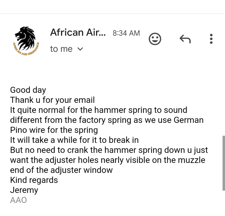

Just got a reply from Jeremy at African Air Ordinance
Reactions: RM.510bigbore
Now that's funny! Jeremy is instructing you to set the spring tension to minimum for max power... LOL
He just confirmed what I told you... there is no ability to tune the rifle with that ridiculous hammer, the massive length creates excessive spring pressure at the power wheels minimum tension setting and the massive weight makes the rifle feel like an old black powder flint lock, where you pull the trigger and two seconds later the projectile leaves the barrel, ok... slight exaggeration, but I'm telling you the factory hammer will give you the same velocities as the heavy hammer, reduce the lock time and enable you to tune the rifle properly, which should gain you anywhere one or two extra shots before velocity drops off significantly. I wont mention it again... don't want you to think I'm being pushy and I'm sure that you will eventually figure this out on your own.
