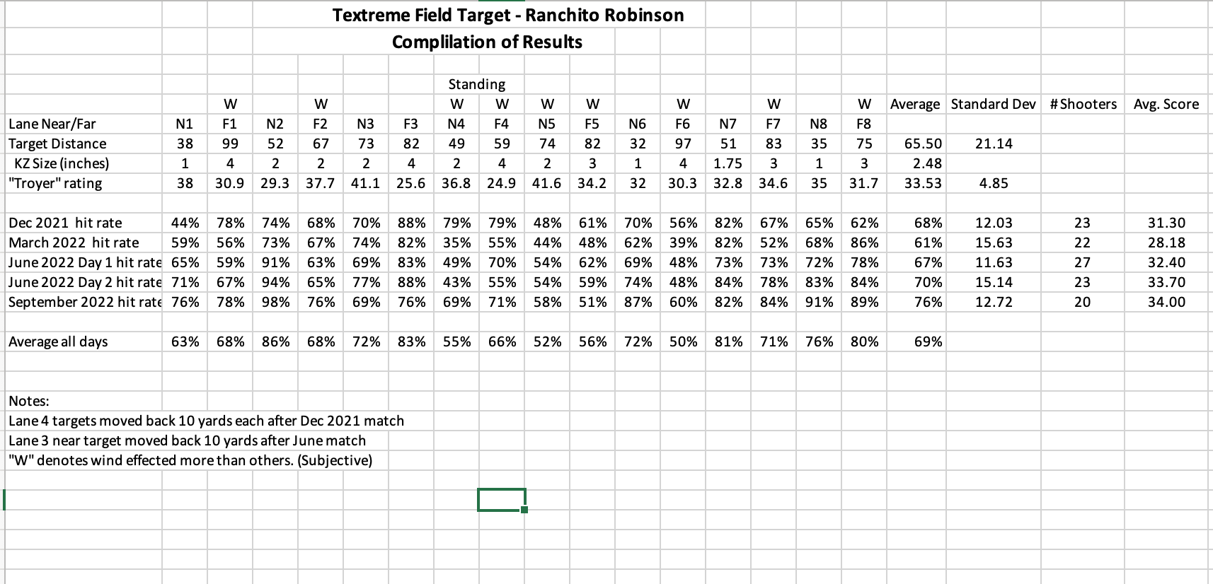

Textreme Field Target - Compilation of Results Dec 2021 through Sep 2022
Y'all chew on this. The image below is a compilation of results from quarterly Textreme Field Target matches held at Ranchito Robinson, Clifton, TX. These matches were held from Dec 2021 to Sep 2022. There was a two day match in June and I reported the two days separately.
Art "Podna" Womack
Team Wolfpack
@art.of.airgunning

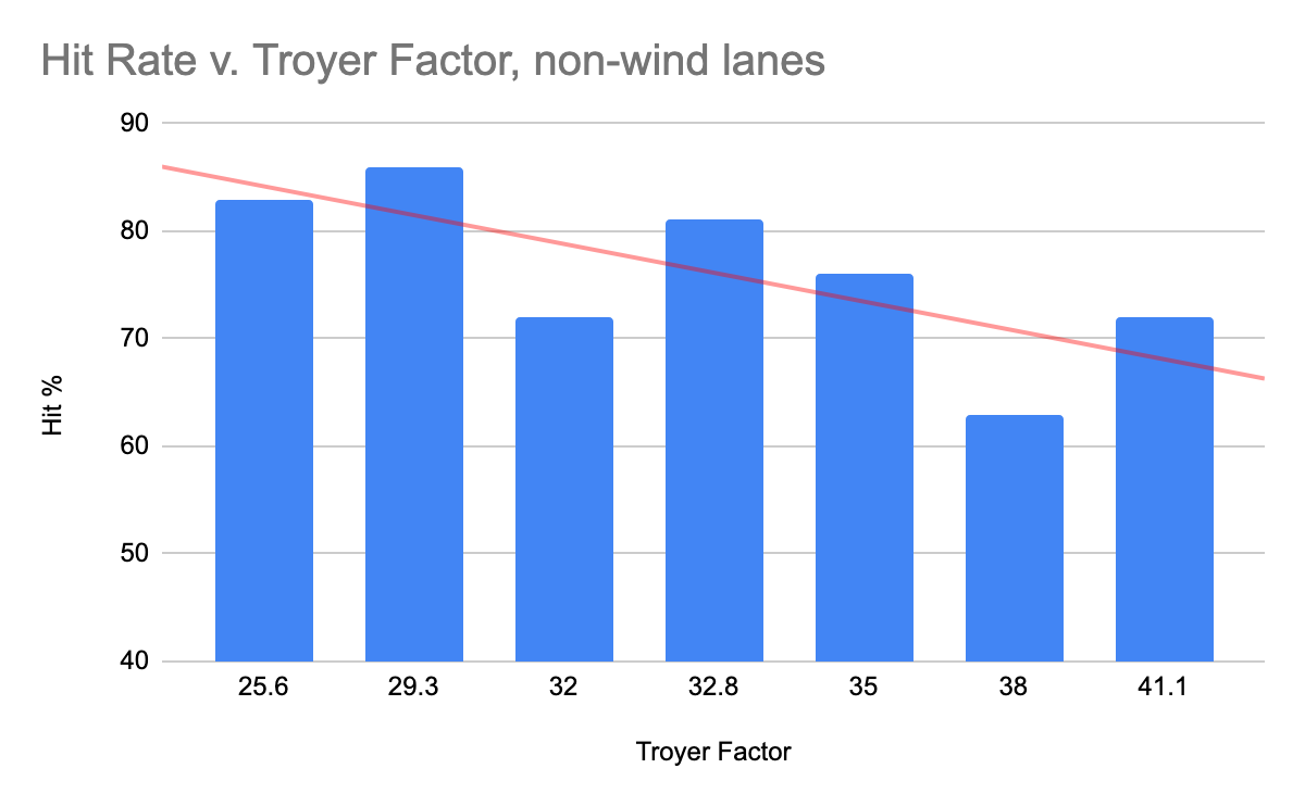

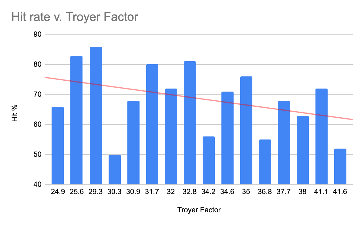

Interesting, Art. I took the data and graphed some of it. You would expect the hit percentage to decrease as the Troyer goes up, and it generally does:
But there's great variability. The trendline is questionable given the wide variation in some of the lanes. If we take the lanes listed as affected by wind out of the equation, you get a pretty good look at the relationship we want from the Troyer measurement:

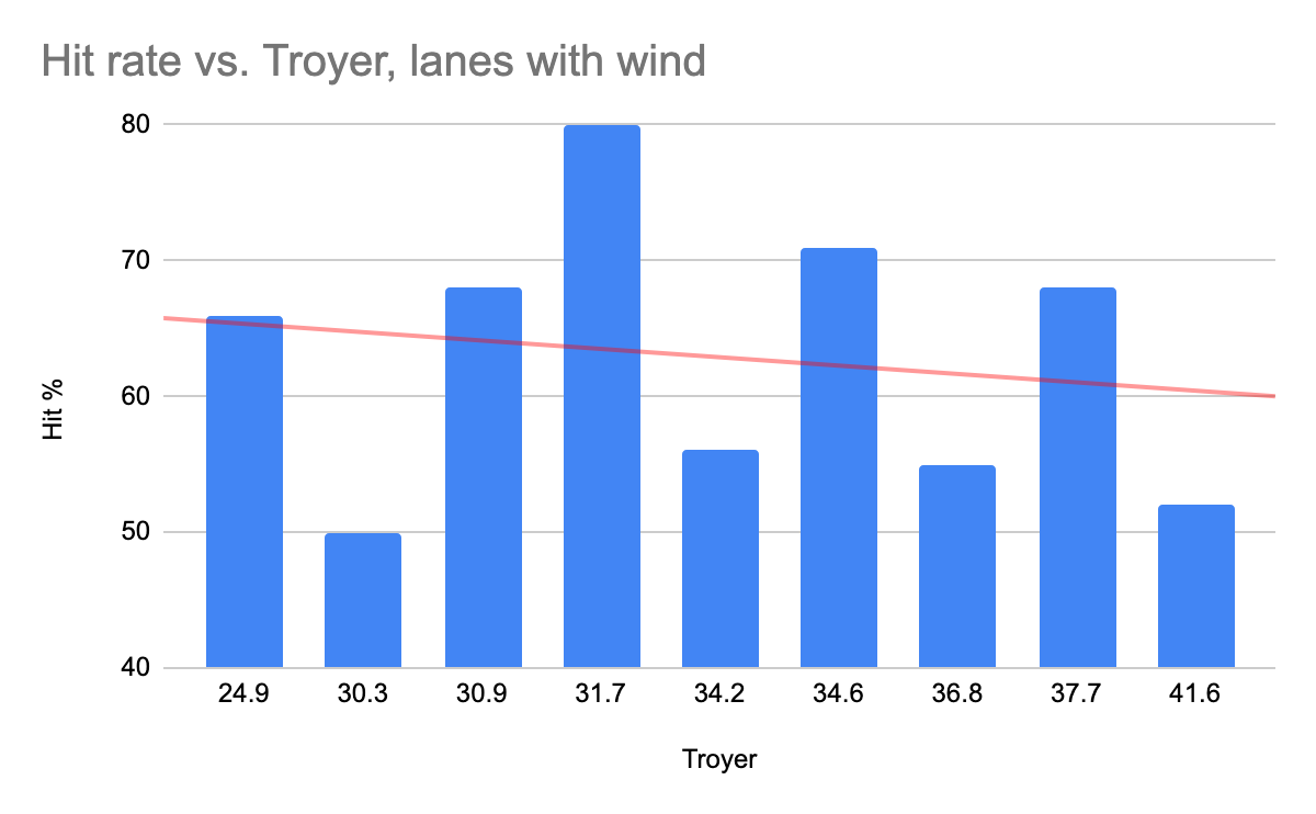

But if we look at just the lanes impacted more by wind, we lose much of that relationship. I'm not sure I would have even drawn a downward trendline here, given the variability in the data.
There is still a generally decreasing hit % with increasing Troyer, but not much, and there's significant deviation from that.

1) while the Troyer calculation for extreme field target distances holds, it is much more accurate in the "non-wind" lanes, and far less predictive in the lanes affected by wind. If we are trying to standardize the Troyer measurement for courses in different geographies and locations, this could mean that a Troyer calculation for an Extreme Field Target course that was windy throughout many lanes would produce a Troyer factor that was not useful to compare to other less windy courses.
2) Based on this (limited) data, perhaps the Troyer for Extreme Field Target distances needs to account somewhat more for wind given it's increased effects on pellets shot at > 55 yds.

As usual, Art has AGAIN gone way beyond the call of duty assembling all this data. Although I'm ALLERGIC to puzzles (of any kind, always), even at first glance I can take more from Art's data than anyone else because I know which and when I moved targets farther out in order to not only keep my shooters guessing and prevent them from posting perfect scores, but AGGRAVATE THEM as much as possible!🤬
Said 'repositioned' targets invariably show up in the data with a precipitous fall in the hit percentages the following match, then followed by a relatively steady increase in hit percentages as shooters acclimate to the increased difficulty(s). An excellent example is the standing lane 4. Those targets were moved farther after the December 2021 match.
My point is this. Wind and shooting conditions are not the only variables illustrated in the data (hit percentages), but also target and course evolution from match to match; almost invariably toward higher difficulty(s). As I often say, "There's a method to my madness(es)!" In this case, forcing my shooters to improve by presenting them increasingly challenging courses. Many of them attend EBR... better prepared, thanks to that sadistic TEXtreme match director.😱
