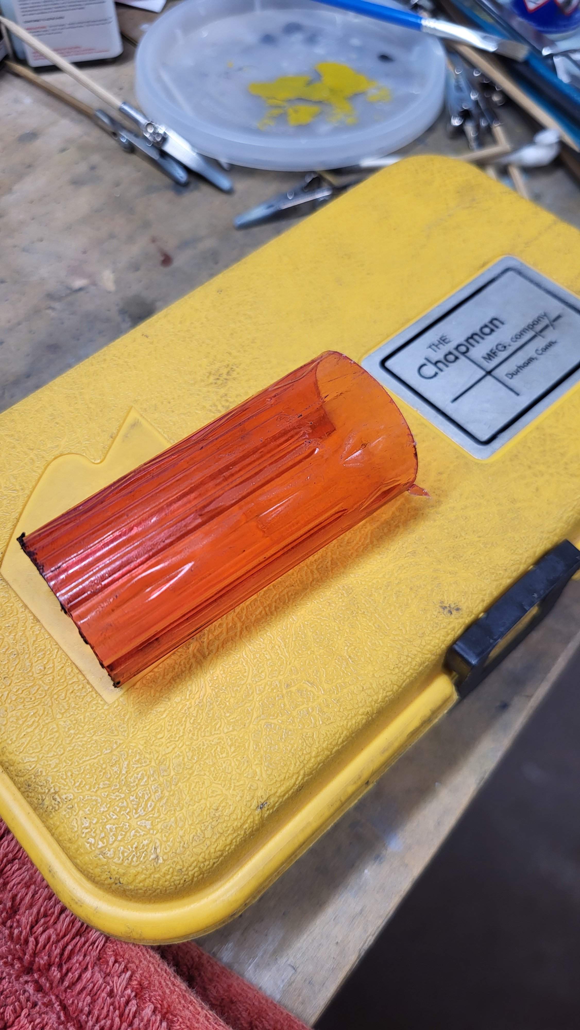

I want to thank KWK for a tip he gave on another thread. He mentioned that bubble tubes worked well as homemade piston liners. I ordered the same ones he recommended and tried them today. I'm really happy with them so far. I cut up one of these bubble tubes and made a piston liner. They were easier to use than cutting up plastic drink bottles or the ptfe sheets I was rolling. My 22 HW95 had a little bit of twang left in it and now it's completely gone. I'll have to order more bubbles
for future guns. This was a great tip. Thank you KWK.
