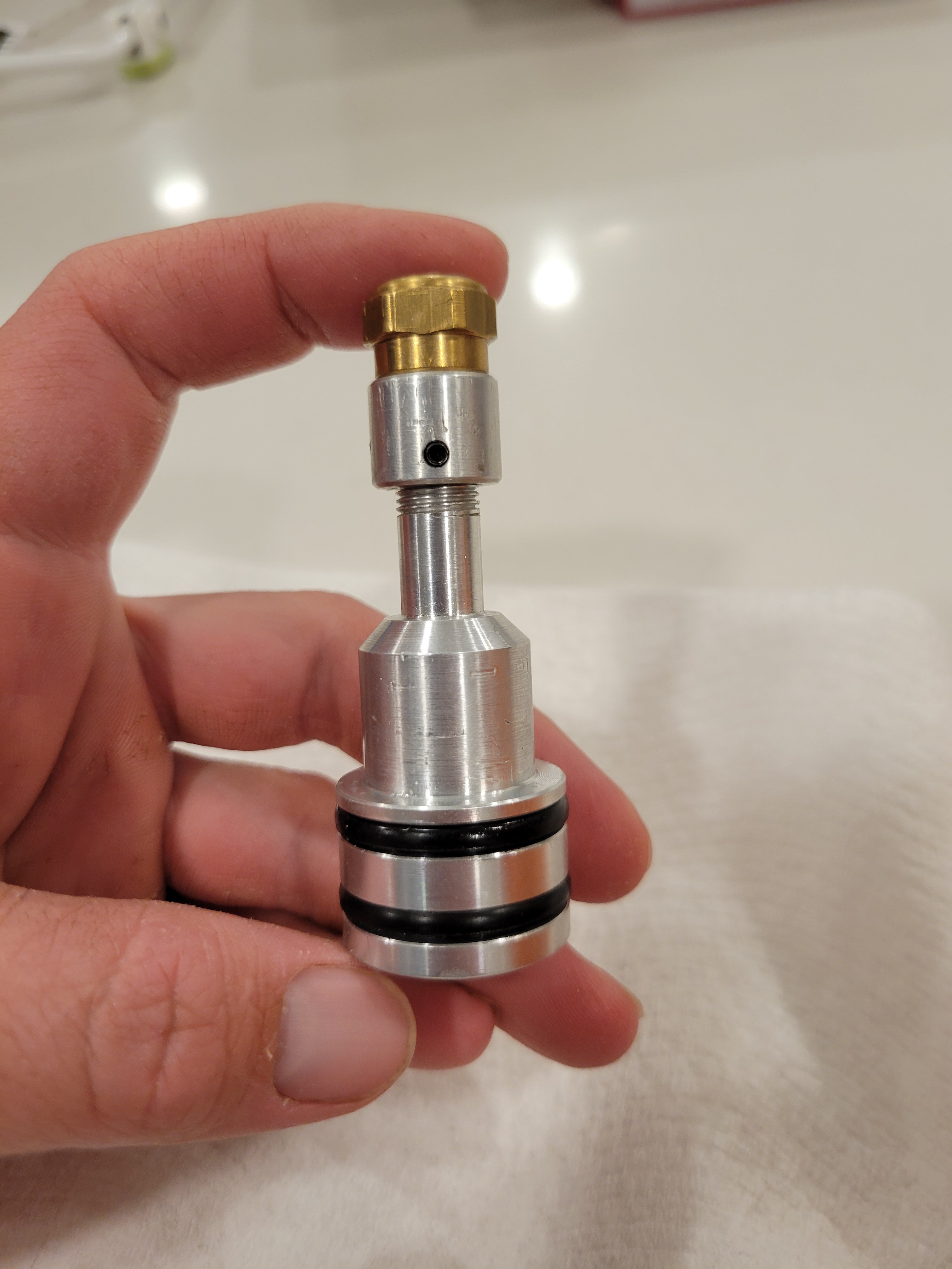

Air out Reg vent hole ... Inner spool x2 o-rings, and/or the other o-ring under the tapered bottom cap. ( So 3 critical there + a 4th under adjuster cap. )
So do I remove the whole top part? And the circlip on the bottom to get there?
With calipers MEASURE the over all lenght before turning / unscrewing the cap/screen end !!
Take out set screw and unscrew it. Under it you will find an o-ring sealing the seat from air bypassing it.
* When reassembling shown section, screw back together to measured distance & fine turn rotation by making note where the threads have been damaged by the set screw by looking threw the threaded hole of said set screw.
