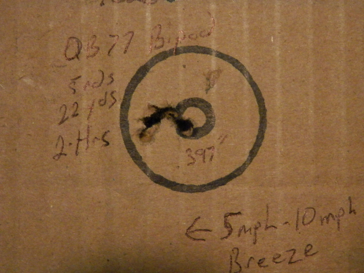

Weighing in on the co2 side of things, I found that I get better groups if some time between shots is given. When hunting, the first shot is always a cold shot, so it seems logical to sight it in cold. The group below was shot over a two-hour period.

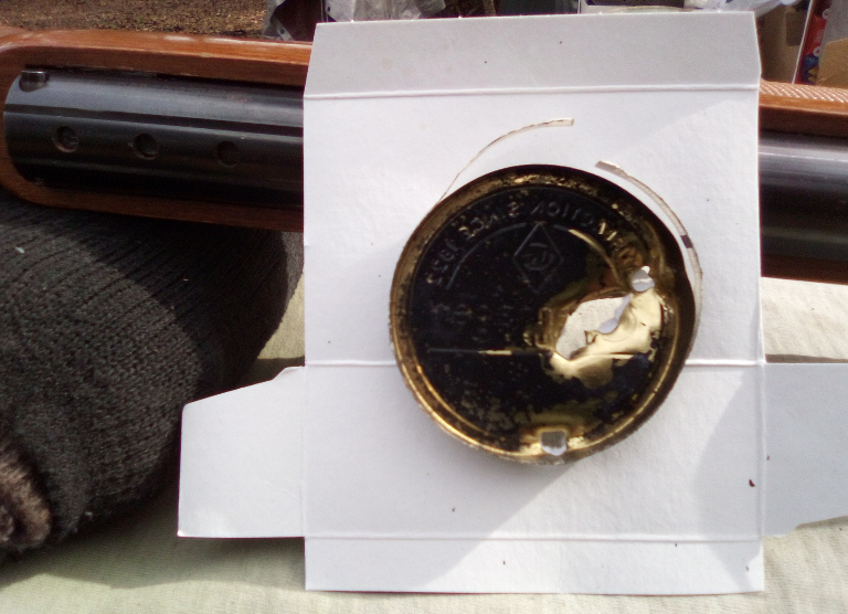

Naa, the worse first shots cold were in the receiver like spring, lubes, seal . Also I can suspect dirty barrel . Things thicken and thin as temps change on anything.. honestly the worse cold poi miss cold was using krytox as the spring/piston lube.
First shots cold off the unheated shop rack ,50° +/- , cp-hp , 50 yards, irons ( no scopes or peeps) R9.
I guess could be better , then I could be worse too..🤤

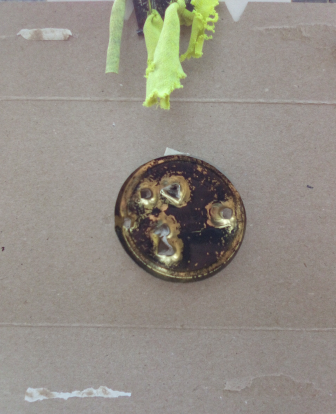

Another quick 5 @ 50y ,irons, cp-hp a few min ago. I could say consistent?
