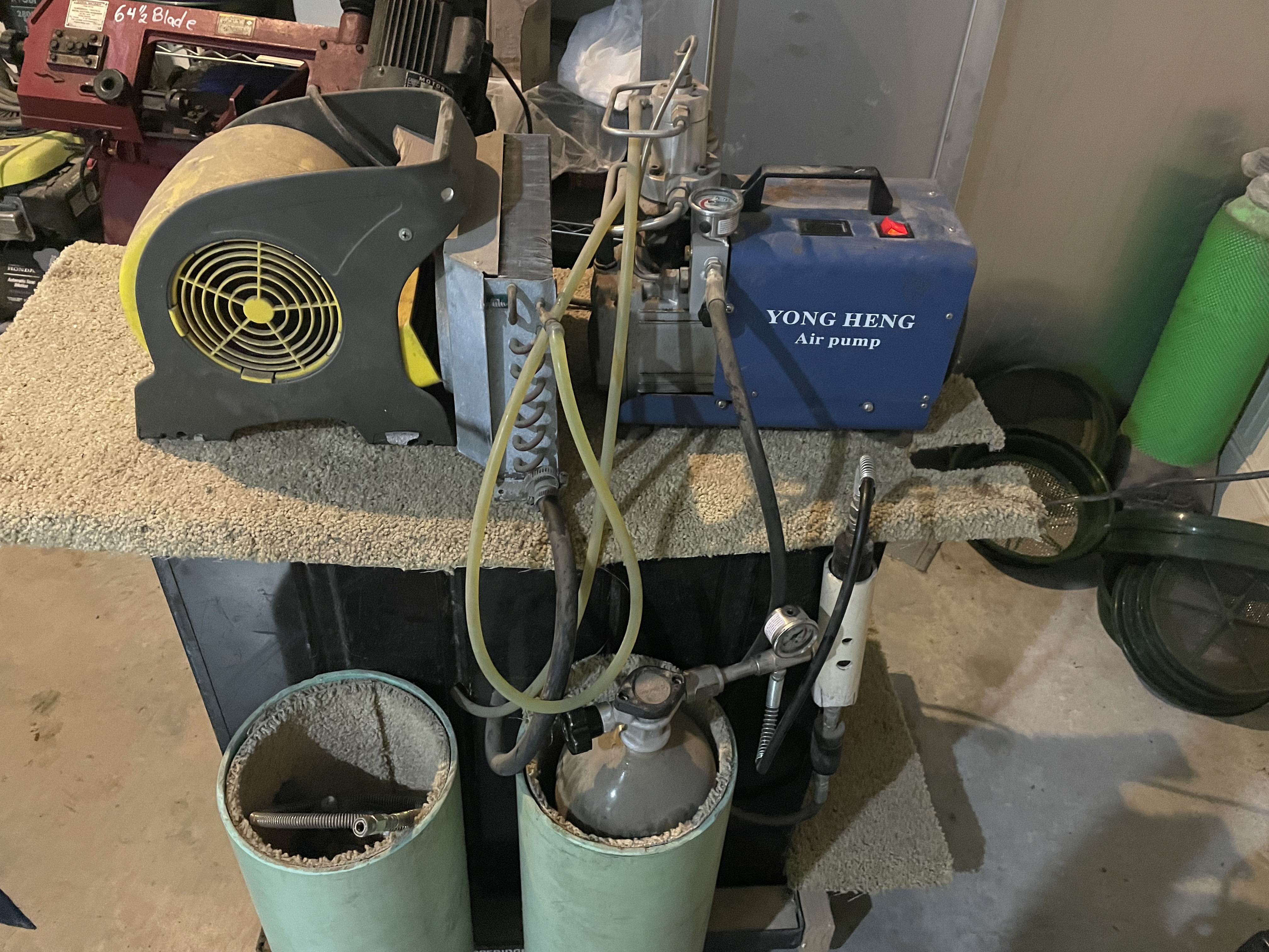

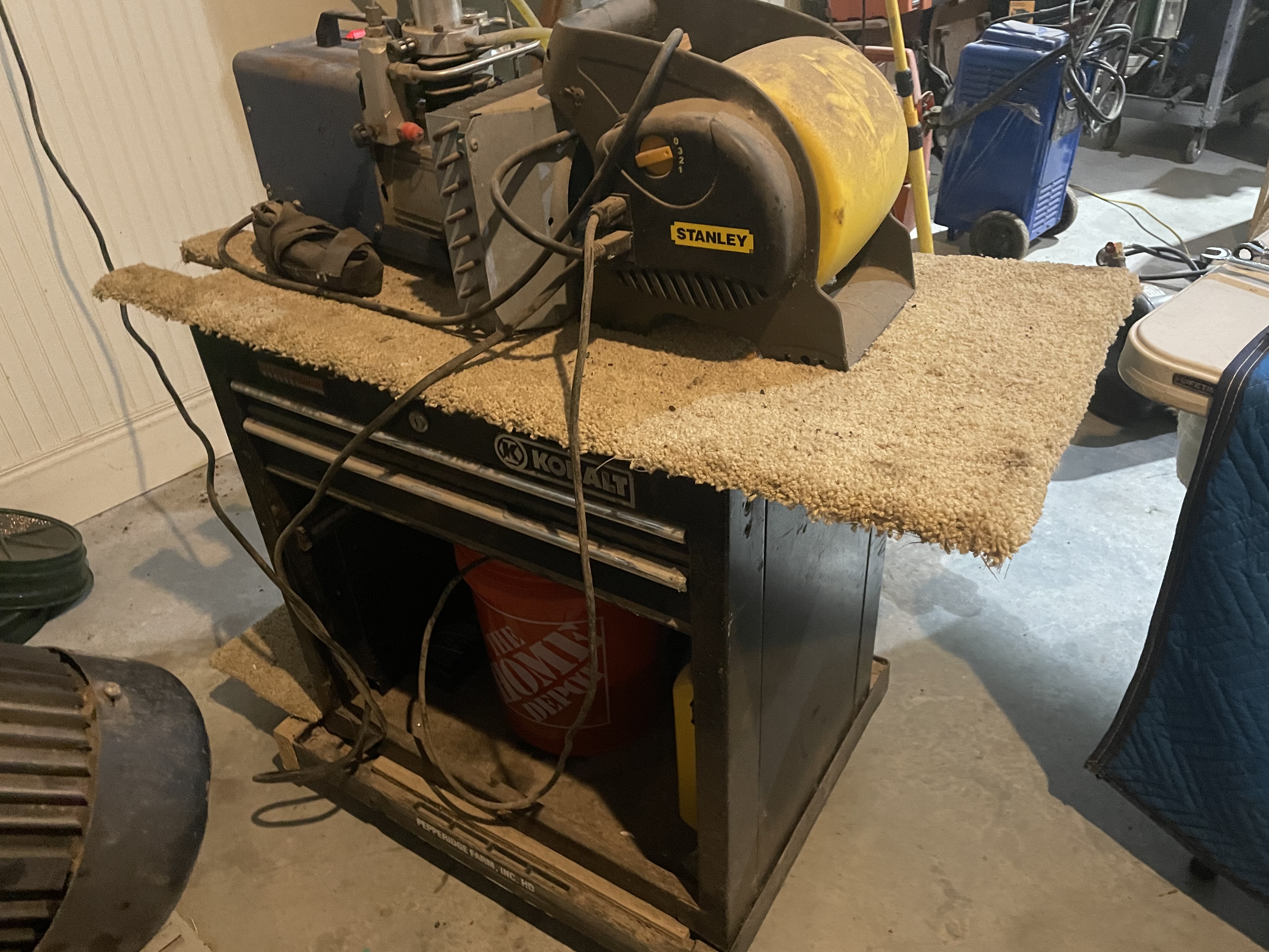

Saturday morning and raining in the lovely but HOT state of Texas nothing to do so thought I would shoot this out. Was filling one of my 66 SCF bottles this morning it had been sitting for 2 years in my shop and it bursted a disk so empty. I have 2 large bottles and a ninja so I dont have to fire up my compressor much in the summer plus I dont like to get sweat on my guns just me. When I got into this I as many of you had to maybe not tell my wife the real cost of this hobby. The comp. back then was I think $499 sometimes $450 with shipping. My first pcp was a Dragon Claw 50 cal (air hog) hand pump was out of the question. As I am sitting there watching this old comp. fill this 66 SCF bottle from zero I could not help but notice now it is rusted and really just how good of a job it has done for me. I have 5 big bores and 2 small 30 cals. The only thing I have ever done is replace a few burst disk on the thing. I have done some mods/add ons or whatever I thought I would share if anyone wants to know. Some my ideas and some from fellow airgunners but the proof is in the pudding. The radiator is off of a tiny window unit found on side of road. Just a little habor freight cheap fan. I put a bigger water pump I think was $12.00 on closeout home depot. 2 pieces of pipe lined with carpet to set bottles in for safety while filling ( expired bottles not advisable) I put Royal Purple coolant additive in my predeluted antifreeze. Just mounted on top of a cheap 2 drawer rolling tool box so I can roll out of the way. I use a couple of air filters with water absorber and cotton filters. Hope this helps someone when making a choice to spend a bunch more money than needed
