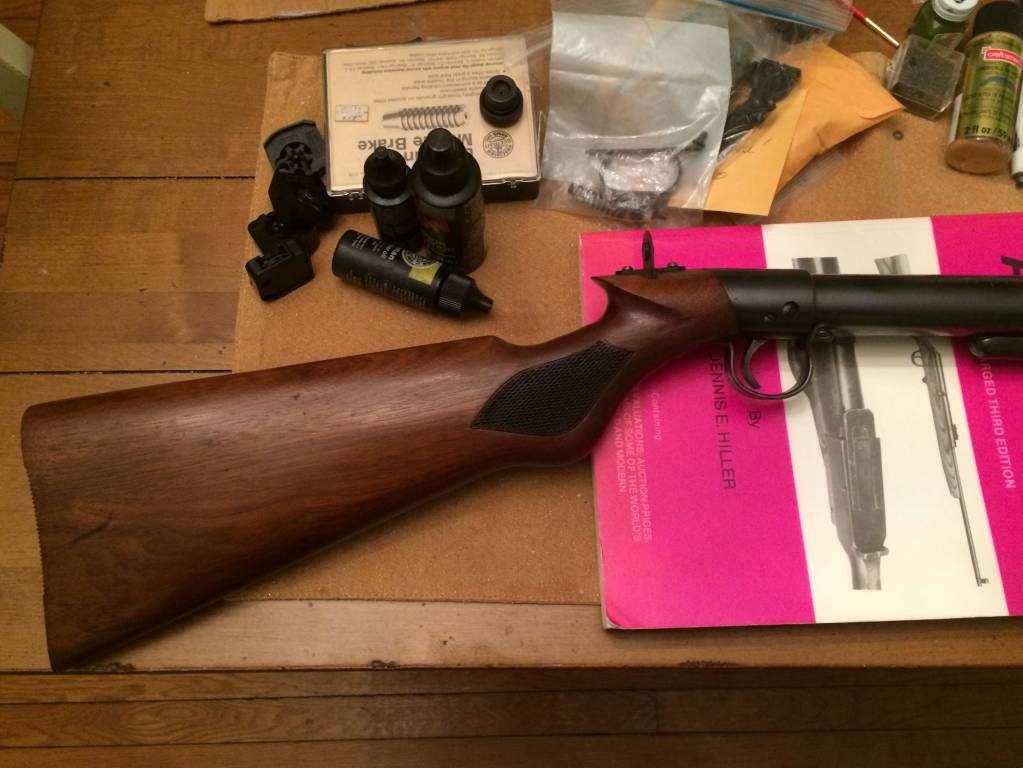

The Beeman C1 stock BSA prewar

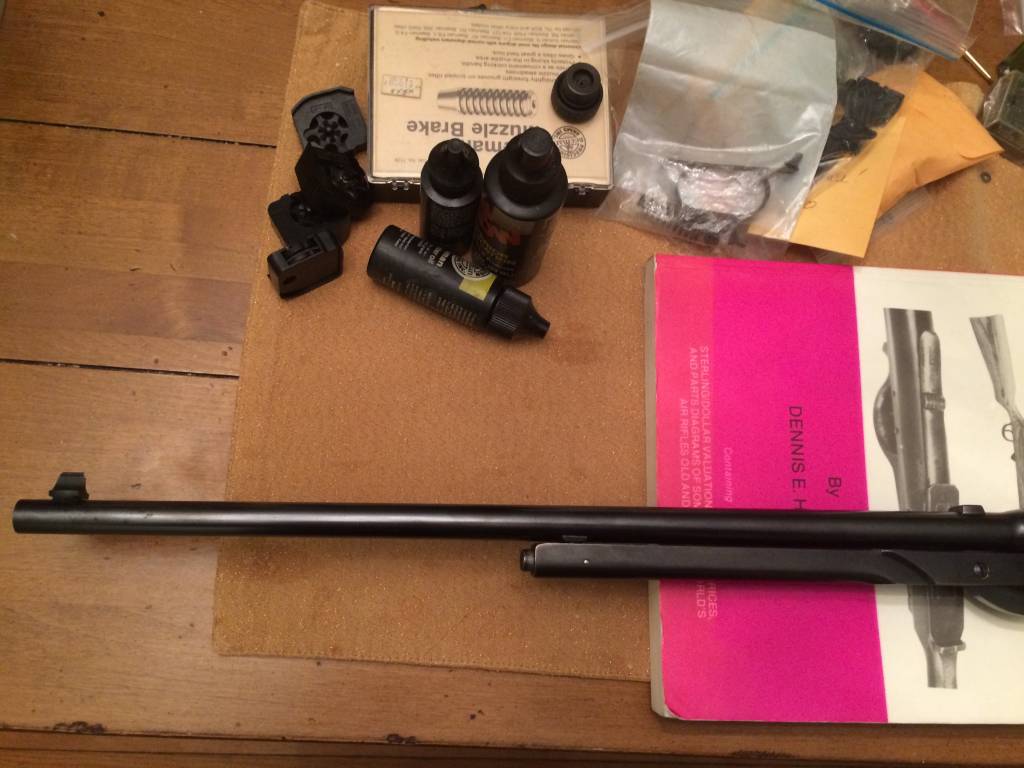

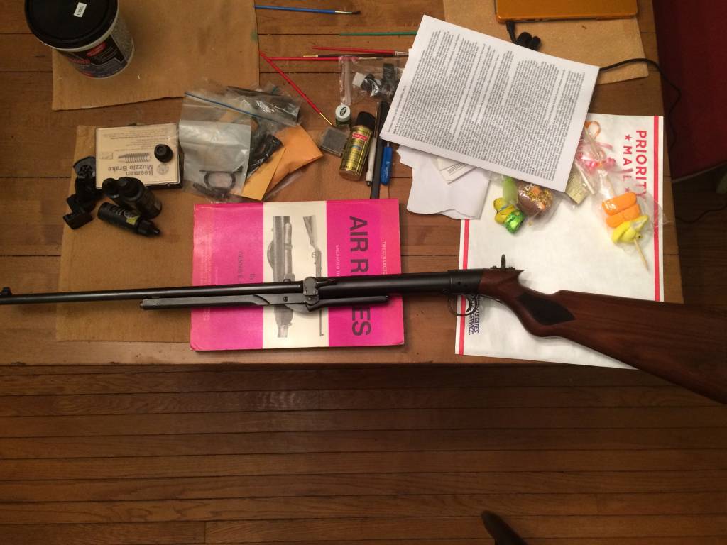

C1 is far from the first straight stock on an airgun. BSA called it the "straight hand" stock. Popular shotgun stock design. The straight hand stock was an option on the prewar guns. {WW!) This one is a rare 1919 Light pattern made from leftover prewar Improved Model D parts. Only a few exist. No other post war BSA models had the straight hand stocks. This is the lowest # Post war light pattern I've seen L373. It shares the 2 hole trigger block, cast trigger guard, and sights used on later Light patterns. 1919-20 The rest was made before 1916. This is as I acquired it. The cocking link was missing. It's in fine working order now. Rebuilt. I found it on eBag several years ago. I sent the seller a message explaining how hard it would be to locate parts and restore it to working order. And that I am just the man for the job. Included an offer that he accepted. It's one of my favorite prewars in my collection

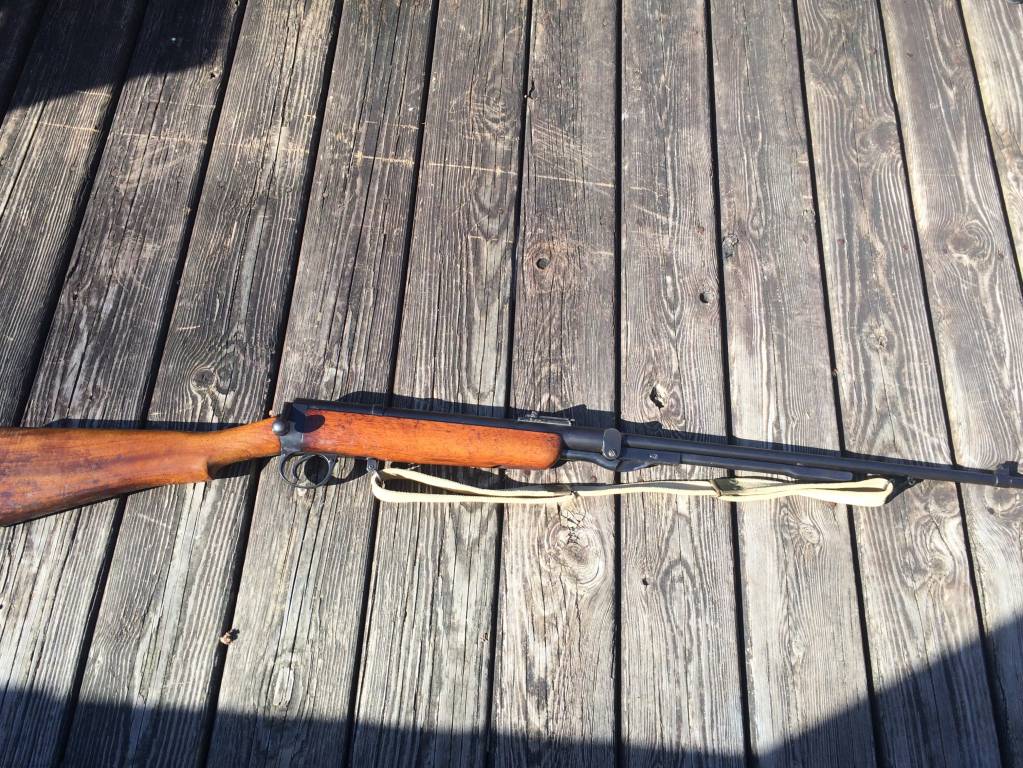

Side button cocking lever

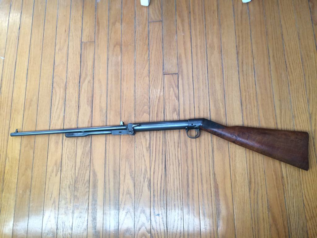

This 1910 Light pattern Improved Model D has the more common "pistol hand" prewar stock

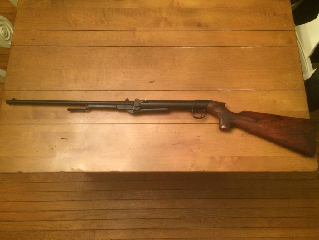

bayonet cocking lever as seen up until 1911

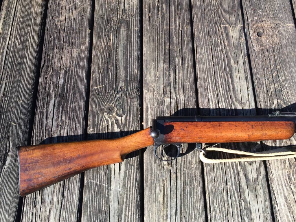

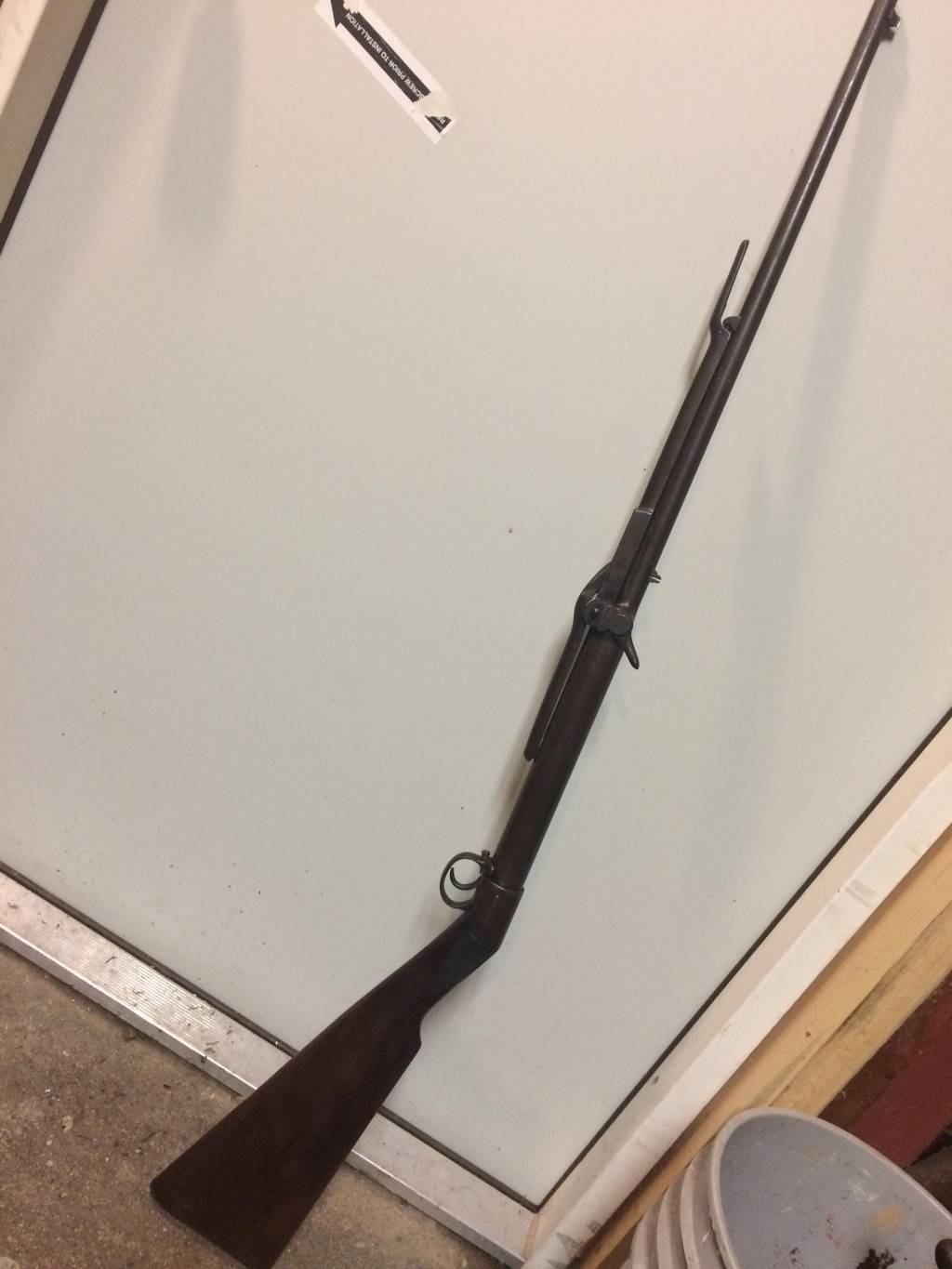

This one is a 1907 model "BSA Air Rifle" sixth batch with optional straight hand stock. This one has Improved Model B upgrades but not named as such. Ser #15000 something. Also rebuilt to shooting condition. New home made leather seal, sight adjustment screw, and repaired front sight. The seal was missing but that didn't prevent someone from shooting it until the piston was hammered and stuck in the cylinder. Still has the original oval section spring. Good for another 115 years.

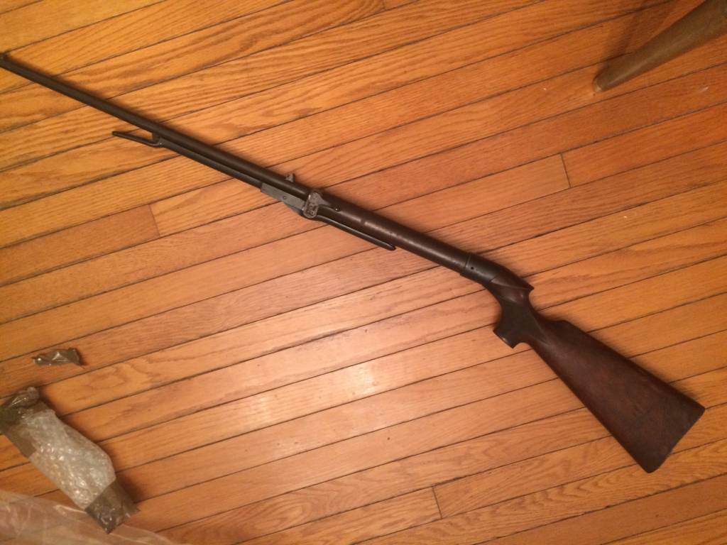

This is another project. 1906 "BSA Air Rifle" Second batch. I have to find a trigger and guard. Make a new trigger screw. And trigger guard screws. I might rob another gun's trigger for now. I have a similar guard I might modify to fit. I will be searching for a trigger again😐. I'm constantly scouring for spare BSA parts. Make a new seal and fit a spring. I can't wait to shoot it. It's in pretty good shape.

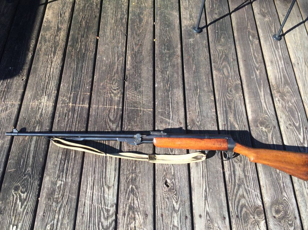

Here's another stock style on a 1911 Military Pattern. Same as an Enfield stock. These guns replicate the feel of the early "Long Enfields". 49 inches long. They were never approved for Military use. Training. One reason I believe is the Long Enfields were not satisfactory for trench use in WW1. The shorter SMLE was adopted for trench warfare. BSA had plans for the shorter Military pattern air rifle but none are known to exist. They were even illustrated in advertisements. But apparently none manufactured.
