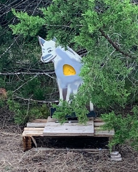

A triangular kill-zone of 3-4" presents a target realistically smaller than it looks; forcing a decision whether to aim at a point more forgiving of windage error, elevation error, or compromise.

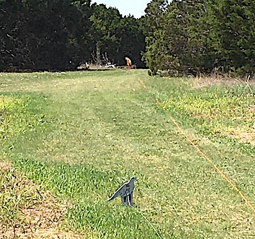

To paraphrase, PISTOL Field Target at AAFTA RIFLE Field Target distances.

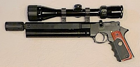

My EPFT rig-
Ataman AP16 with vintage Bushnell Trophy 4-12X rifle scope, Huma Mini mod, and Pachmayr coco-bolo finger-groove grips. She averages sub-1" five-shot groups at 50 yards with 18.1 grain JSBs at 628 FPS/15.9 FP.

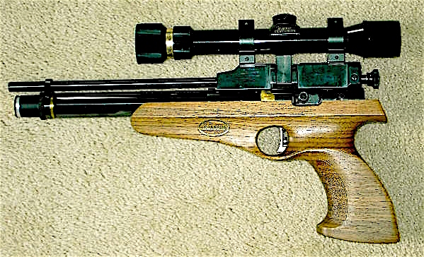

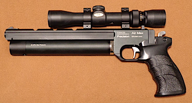

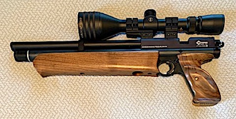

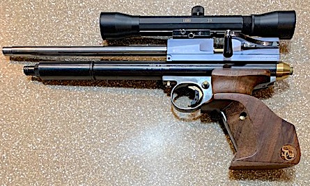

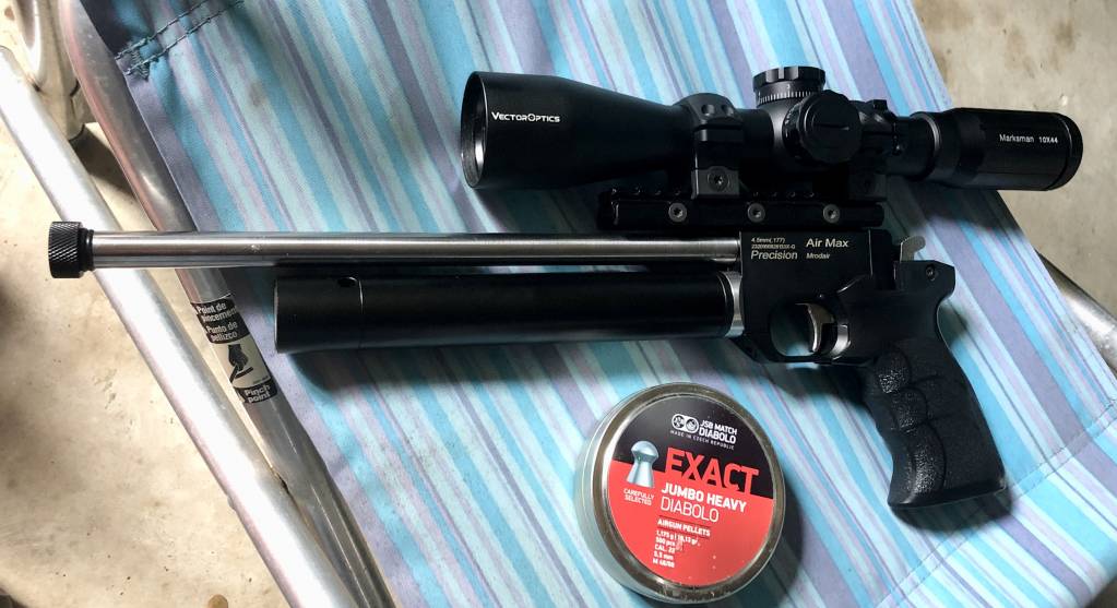

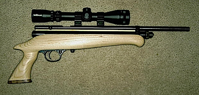

More common air pistols with EPFT potentials would include the Benjamin P-Rod, the awesome vintage Falcon PCPs, the Chinese PP700 and PP750, and any number of customized Crosmans.

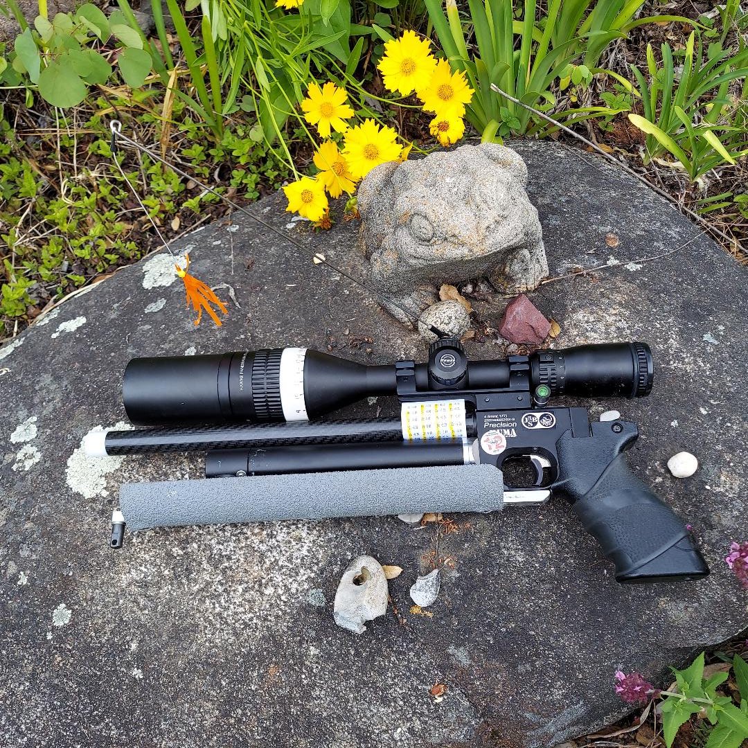

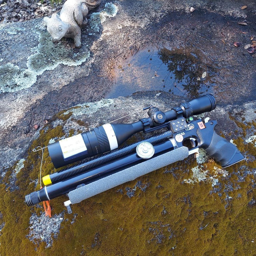

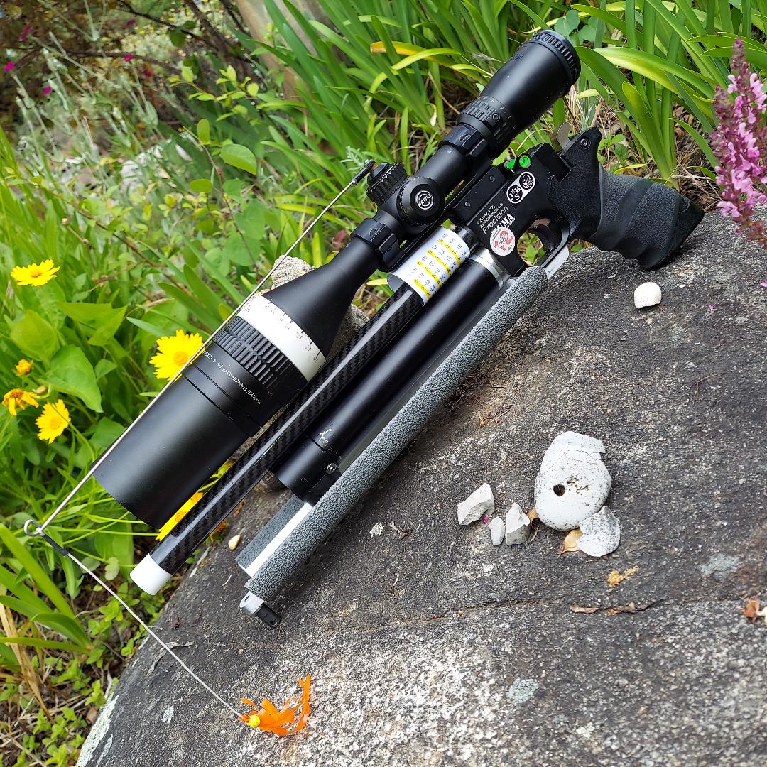

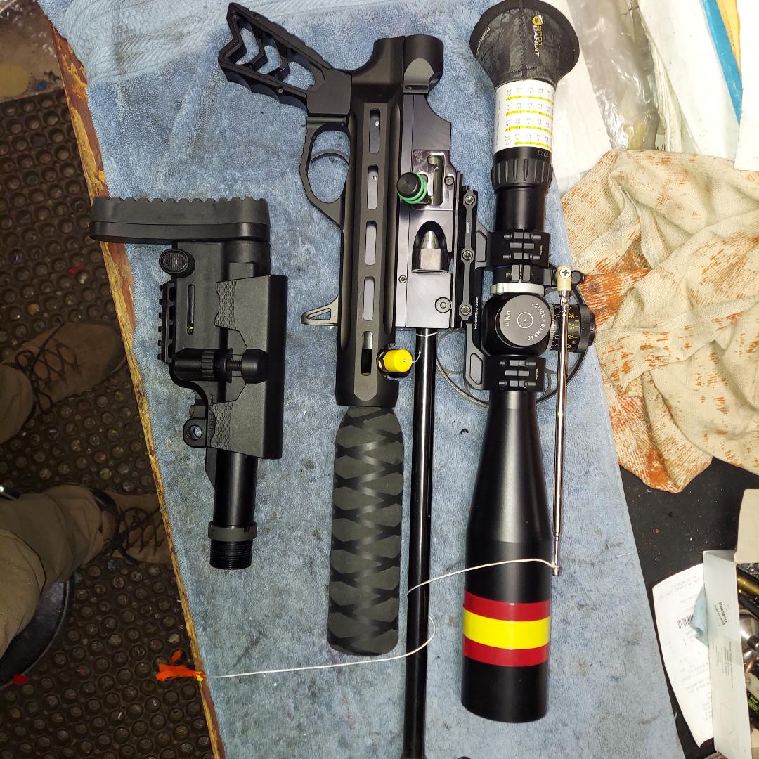

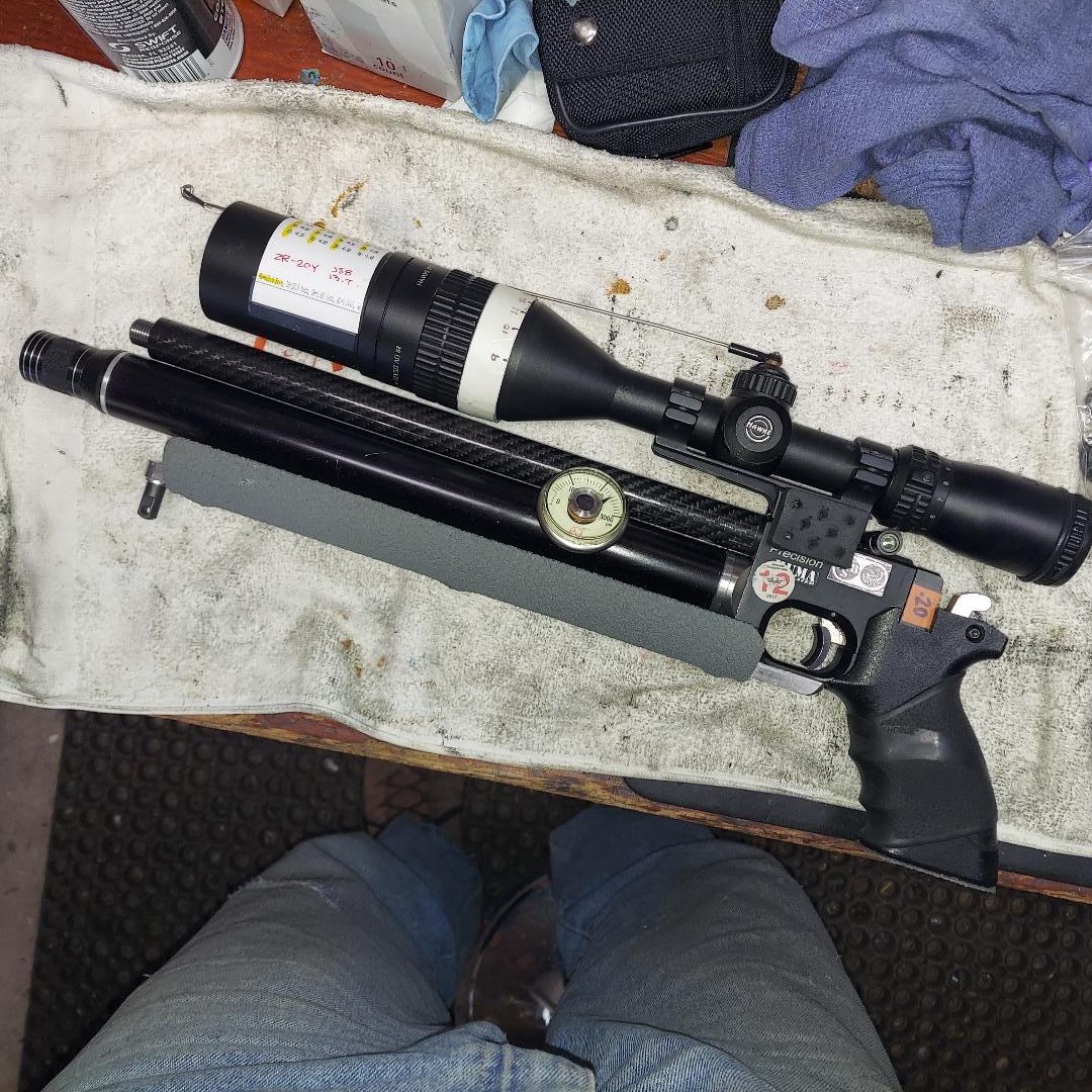

Put the PP700 back to FT duty with a few enhancements :p
Re-barreled with a Legal full 15" LW .20 cal with a tensioned shroud. Full length Rail/Grip added being attached at trigger guard having a rigid spacer up front between tank & rail. Back on went the excellent HAWKE Panorama 3-12 AO ( ranges really well for an AO scope ) Small side/side wind flag on turret cap & bubble level finish it off.
On 95 bar ( HuMa regulated ) we can make @ 45 shots at >12 fpe. At 130 bar we can make >20 fpe for @ 18-20 shots.
So a Legal PFT for AAFTA or Extreme PFT pending how adjusted :love:
Updated to longer air tube .. got 5" more doubling + the volume.

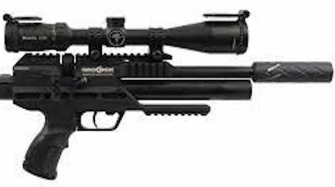

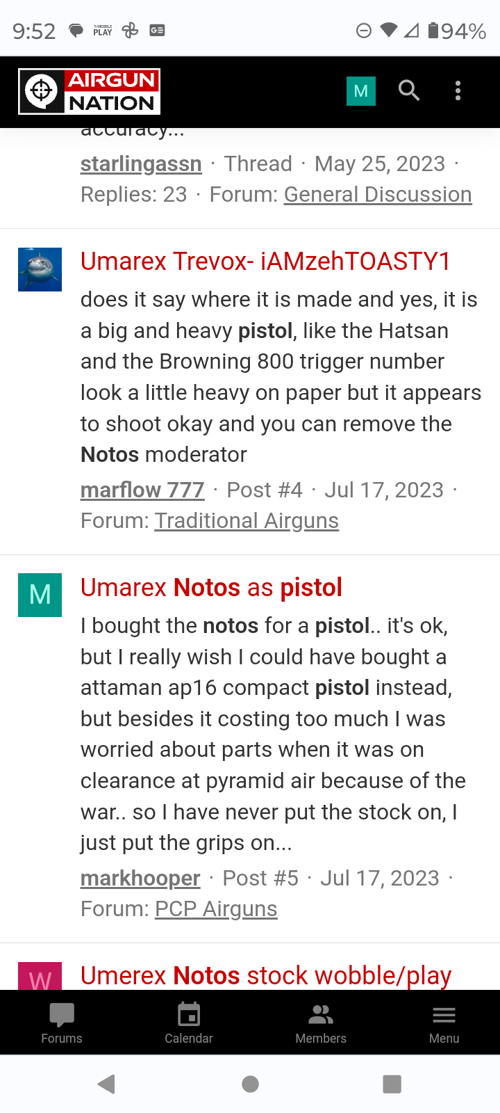

seeing that i will never compete i have a question
a Umarex Notos can be made into a pistol under 12 inch barrel and has power and accuracy to spare could it be use in the Pistol configuration
take a look at the thread I'm attaching pictures of it.. below the post by me is a great post on the pp750 which is very similar to the notos..
I plan on doing that with my notos and also making it so I can screw on the factory moderator.. just going to take time and machine work..
