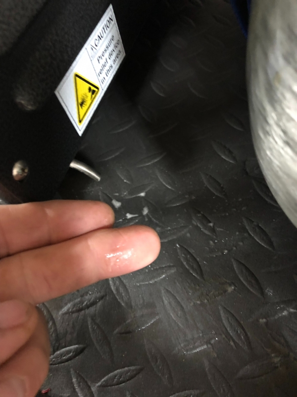

Just under 15 minutes for a fill to exactly 4500 psi at the tank, compressor only got up to 133 degrees F, and my finger shows that auto purge is doing its job with the moisture evac.
im going to have to revisit the auto purge time frame set. I had it set for 15 minutes, and I may drop it to every 5 minutes instead, cause it seems all my top offs have been under 15 minutes and I don’t want moisture sitting in the compressor if I can help it. Might as well, since it has this auto purge feature.
