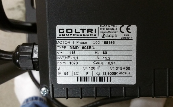

I’ve got a question about the daystate 110 hopefully one of you guys can answer. What kind of amps are they drawing through out the airing up phase of a bigger tank, ie a 98cf? I suppose what I’m really asking is what size of breaker your using 20A or 30A. I thought I read somewhere on here that it took a 30A breaker. I’m assuming, and you know what that will get you, that it will have to be a dedicated compressor only circuit. I’m not an electrician but know the basics, garage hasn’t burned down yet!! Thanks, as I’m considering one myself down the road.
The label on mine (4 stage) reads 15 amps.

If you run the compressor at no load the motor might pull say 8 amps but the closer you get to 4500 psi the amps will increase to the 15.2 amps rated on motor tag. If breaker rated at 15 amps it will trip. In newer houses it is code for washing machine to be on a dedicated circuit rated at 20 amps. This may be inconvenient but you want have to run a new circuit. If you want to run a circuit #12 wire with a 20 amp breaker. The rule for breaker ratings is load in Amps x 125% = breaker amp rating. You size wire accordingly. Number 12 wire is good for 25 or 30 amps depending on wire coating materials.
15.2A x 1.25 = 19 A. Hope this helps , Metalmaniac
Rated. Breaker Needed

I had to run a separate circuit for a sump pump that drew 18 amps just for a brief period when it kicked on then dropped back down. I used number 12 on a 20 amp breaker and have had no issues. I was just curious about these compressors as I thought it might draw more than a sump pump. Thanks for the feedback and Cohan for the pic of the tag, that’s what I really needed in hindsight.
