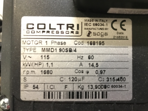

The one I bought last month says it draws 14.5 amps. I use it on a 110v 15amp breaker in the garage with no problems. Picture below.

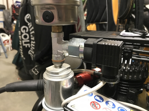

FYI Picture of the auto shut off. Might be an easy up grade for those that don't have one. Don't know how it is wired though.

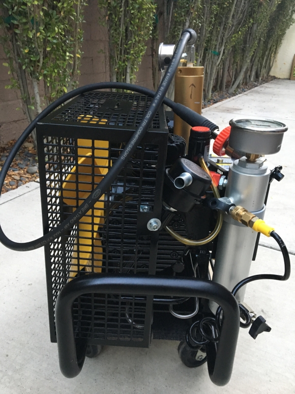

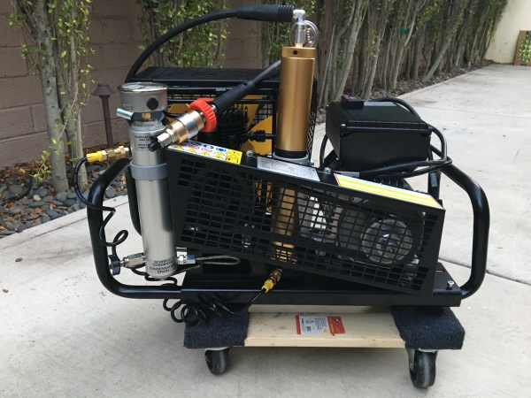

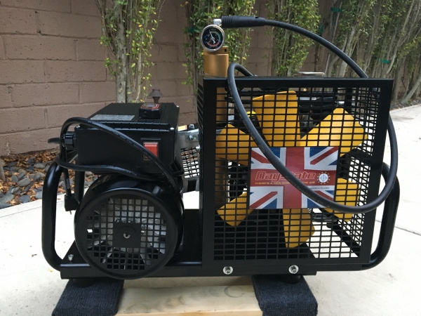

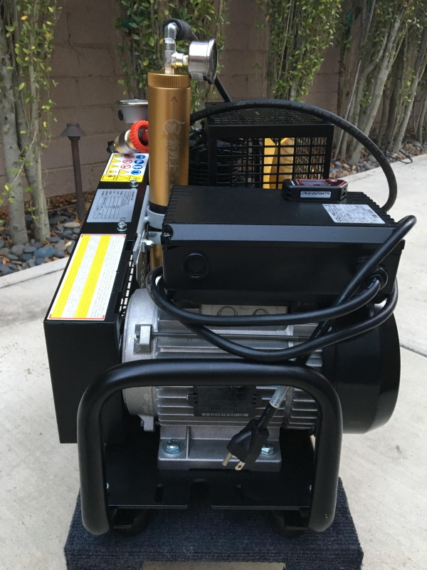

Been using the LC110 for a couple weeks now. Still working great. Added a few items.

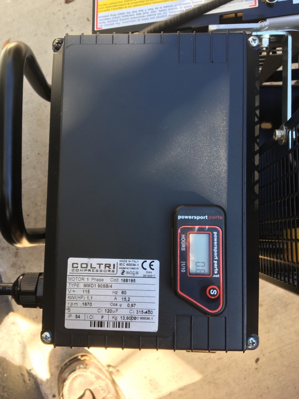

1. Run time meter. Mine didn’t come with one.
1540662976_20898015145bd4a6c09399c2.00547206_78EAB289-97DB-40EA-9DD2-031118760E38.jpeg

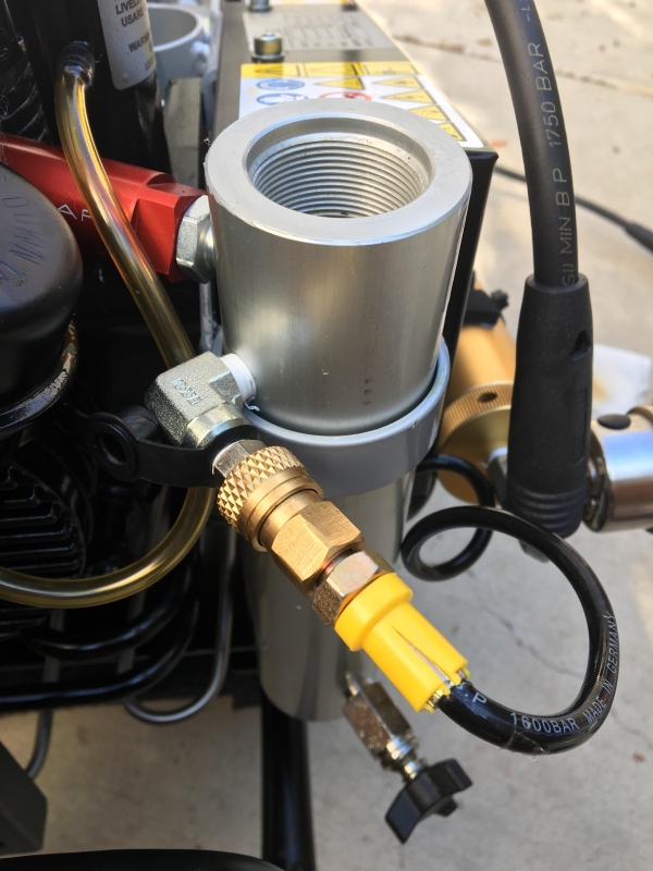

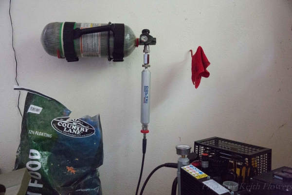

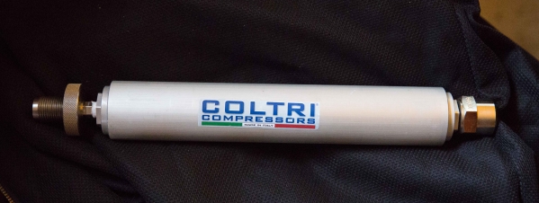

2. Added the “gold” filter with 13x Zeolite molecular sieve sandwiched between two one inch cotton tampons.

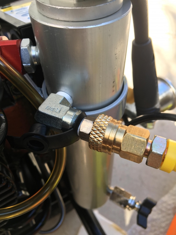

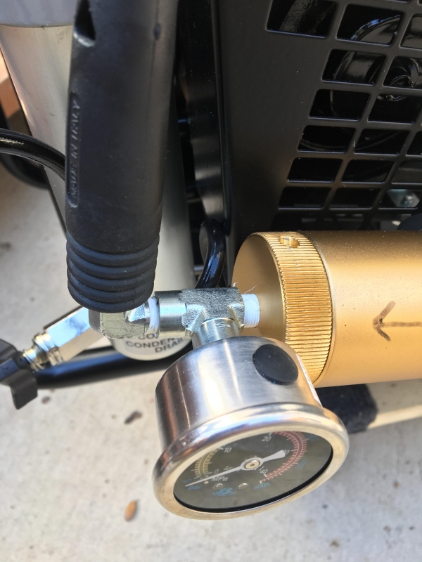

Installed 90 degree "elbow" with male foster, and pressure hose with 9000 psi working pressure - 1600 bar burst pressure - do the math on that one! :) FYI, the hose that is supplied with the compressor has a 1750 bar minimum burst pressure - 25,381 psi!
1540664288_16514530875bd4abe0d998d7.37771248_F601AC88-B04C-4158-BFDB-640BAAA9F183.jpeg

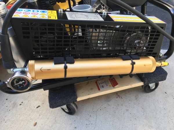

Tie wrapped gold filter to compressor cage that covers the drive belt. Inlet lower than outlet.
Used gold filter setup from my two cylinder Tuxing. Installed elbow fitting that came with compressor into the "T" fitting along with the gage and the outlet of the gold filter.
1540664412_12354442125bd4ac5cdfe985.17475140_A3F5650F-6269-433B-BFCB-5E4E249D599F.jpeg

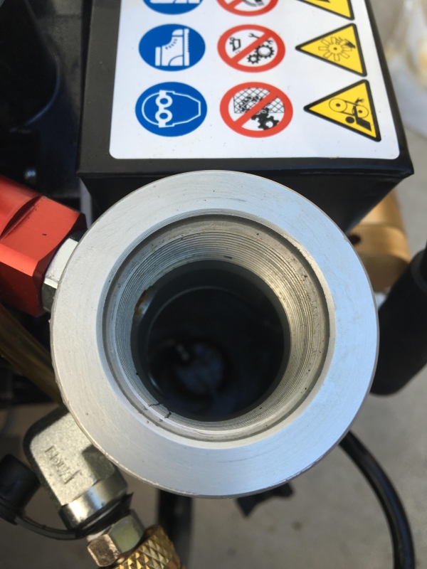

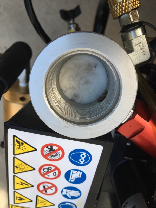

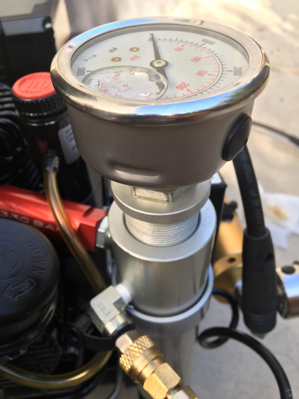

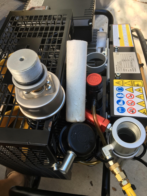

3. Inserted 5 inch section of cotton tampon from gold filter spares into vent chamber under the pressure gage. It fits very snug. Five inches seems correct since you don’t want to cover the outlet port, and it only goes so far into the tube because of inlet “blade” at the bottom. This gives a small plenum at the bottom for the moisture to collect (and be vented periodically while filling), and doesn't block the outlet port, since there is also a small plenum above the cotton tampon.

Mine takes twice that. I've been checking for leaks and problems haven't found any. Don't know what to think. I'm going to just keep running the thing time isn't a problem as long as it gets there and NOTHING BREAKS
I ran mine today and it did better. Perhaps there is a break in period? This unit is not the unit the larger more expensive compressors are but its probably all any one of us needs for our own individual use. Like most every thing else to get 20% better you would have to pay twice the money. The only real advantage to the 220 volt unit is it apparently is considerably faster. If you are filling a tank every couple weeks it likely not justified. The cheaper ones might be ok but with this one you don't have to be concerned with water cooling. A good middle of the road option.
I just got a new LC110 this week. The compressor topped off an Omega 75cf tank and my feeling about it is all positive. It is quieter running than anything I’ve used before. It is located in a crawl space and it runs slightly warmer than my previous Bauer 220V. It also produces a slight smell when running but probably it’s from break in and new paint needing to cure. It tripped breakers on 2 different 15 amp home circuits as it approached 310 bar before the auto shutoff activated. I recommend using it on a 20 amp breaker circuit if you have one. available. The compressor is mounted on a lawn cart in the crawl space under my house.. I installed a 20 amp outlet next to the compressor using a 5' of 12G Romex connected to the 20 amp washer outlet. It eliminates the need to use extension cords to reach other 20 amp outlets and doesn't trip the breaker now. In his AEAC review Steve Scialli connected a LC110 to a long extension cord which typically has 16 gauge wire. It was used to film the compressor review in his yard. It is inadvisable to run any type of air compressor on an extension cord which has less than 12 gauge wire and is longer than 25'. Contractors know this will bog down a compressor due to amp draw overheating typical light duty extension cords.
@humdinger, The only explanation I can think of is that the 4 stage LC110 draws slightly less current than the 3 stage. From what I remember, Steve's unit tested on AEAC was a 4 stage unit. @kahr40 unit above photo shows 14.5 amps, whereas mine shows 15.2 amps on the label plate. Enough difference to trip a breaker that is close to the limit.
