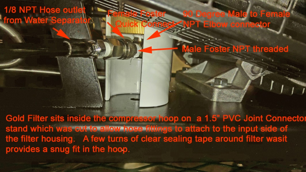

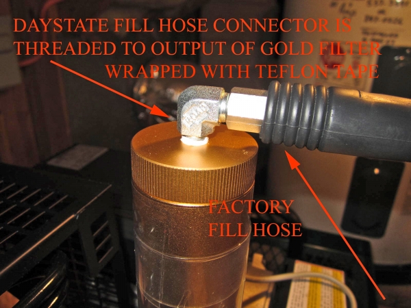

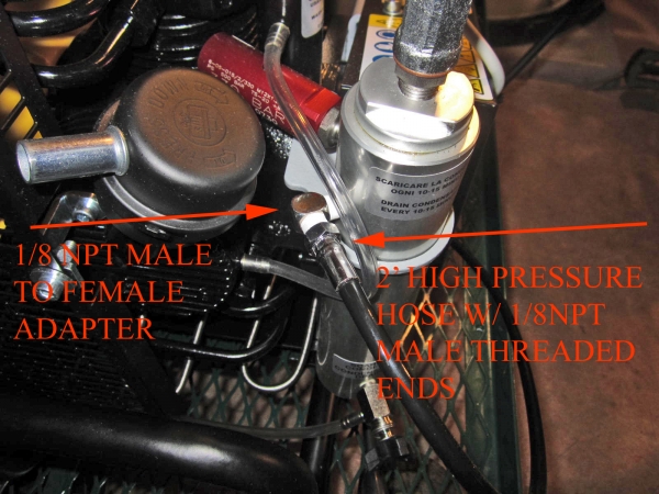

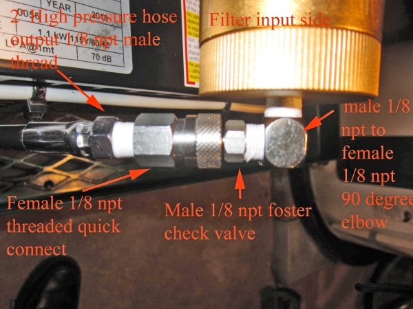

The compressor hose and it's 90 degree connector is moved from the tower and threaded into the output side of the gold filter using teflon tape. The existing 300 DIN on the fill hose can still be used as is if you prefer. It can be unthreaded from the compressor's fill hose and replaced with a Grainger adapter, part #6W433. Then you can attach it to a female threaded foster quick connect, or female threaded male foster if you prefer. I used two 90 degree 1/8 npt threaded male to female elbows at the output of the water separator tower and at the input side of the gold filter. I threaded a male foster check valve into the input side of the gold filter. I connected a 2' high pressure fill hose that terminates in 1/8 npt male threads between the tower and the gold filter. One side is threaded into the street elbow on the water tower. The other end of the hose has a female quick connect which connects to a male foster check valve threaded into the 90 degree npt elbow on the underside of the gold filter.

I've added photos to the previous post to clarify for anyone who is interested in adding a gold filter to their LC110 setup. I realize that the gold filter has M10*1 female threads and anyone is welcome to add male M10*1 to 1/8NPT female adapters to the gold filter. However, the male 1/8 NPT fittings used with teflon tape fit the gold filter female threads extremely well and seal air tight. I did a pressure test on the connections and they hold pressure indefinitely if threaded on tightly and sealed with teflon tape. Use these fittings at your own risk but they are effective for several who have used them. I was skeptical myself but learned this from Centercut and it works.
