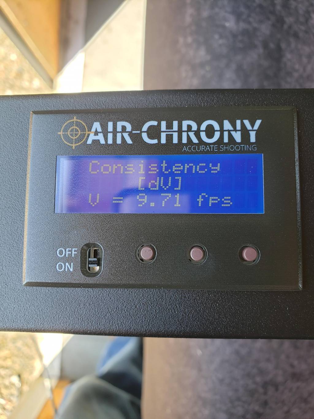

I used Marks method tuning my .177 Red Wolf at 12fpe over the weekend, over 45
 shots I was able to get under 10fps spread and 2.5sd on the string without spending much time or pellets.
Now on to my .22hp Red Wolf. I was having issues reaching 970 at 202bar with 25.39 gr pellets, the best I was getting was 910fps at 202b. Mark gave me a few pointers to increase air flow. I replaced my seals and valve core as mine was showing wear in the stem area. With the changes I can now achieve 970fps at 175 bar. On to tuning it up this weekend. More to follow in a few days......

.22hp Red Wolf 480cc bottle shooting 25gr redesigned tuning for today.
Today I tuned up my 22hp to 970fps using Mark's tutorial. I was able to gather my PL settings in about 15 shots. I took the numbers and programmed them in, filled the bottle to 251 bar and started shooting. I was able to get 47 shots off the fill, with a 12fps spread over the string. Very happy with efficiency and spread for the first tune, going to tickle the numbers a bit more and should be in the single digits. The adjustable fill regulator will make it much easier once it shows up. I get the 970fps from 250 to 175 bar.
