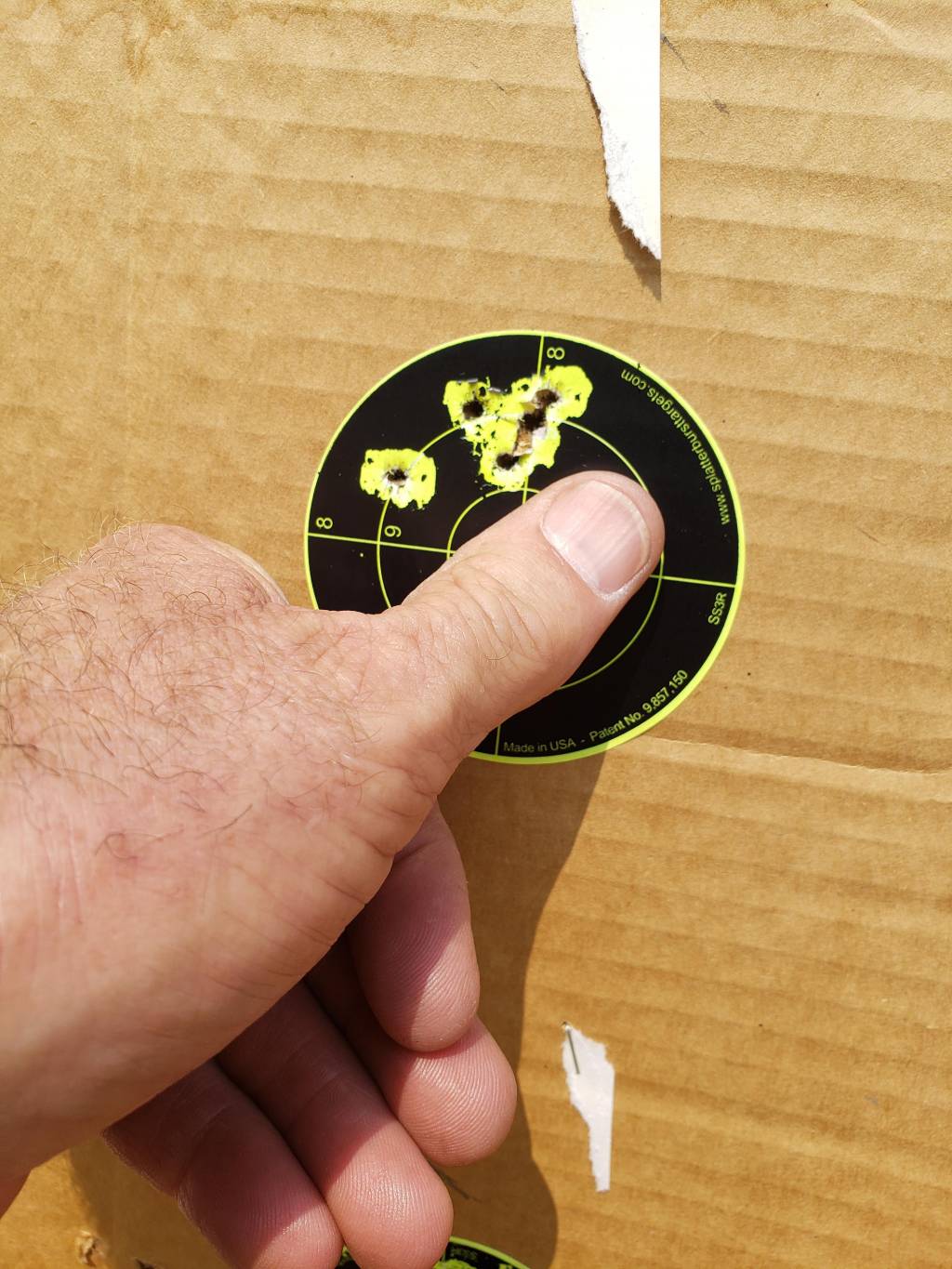

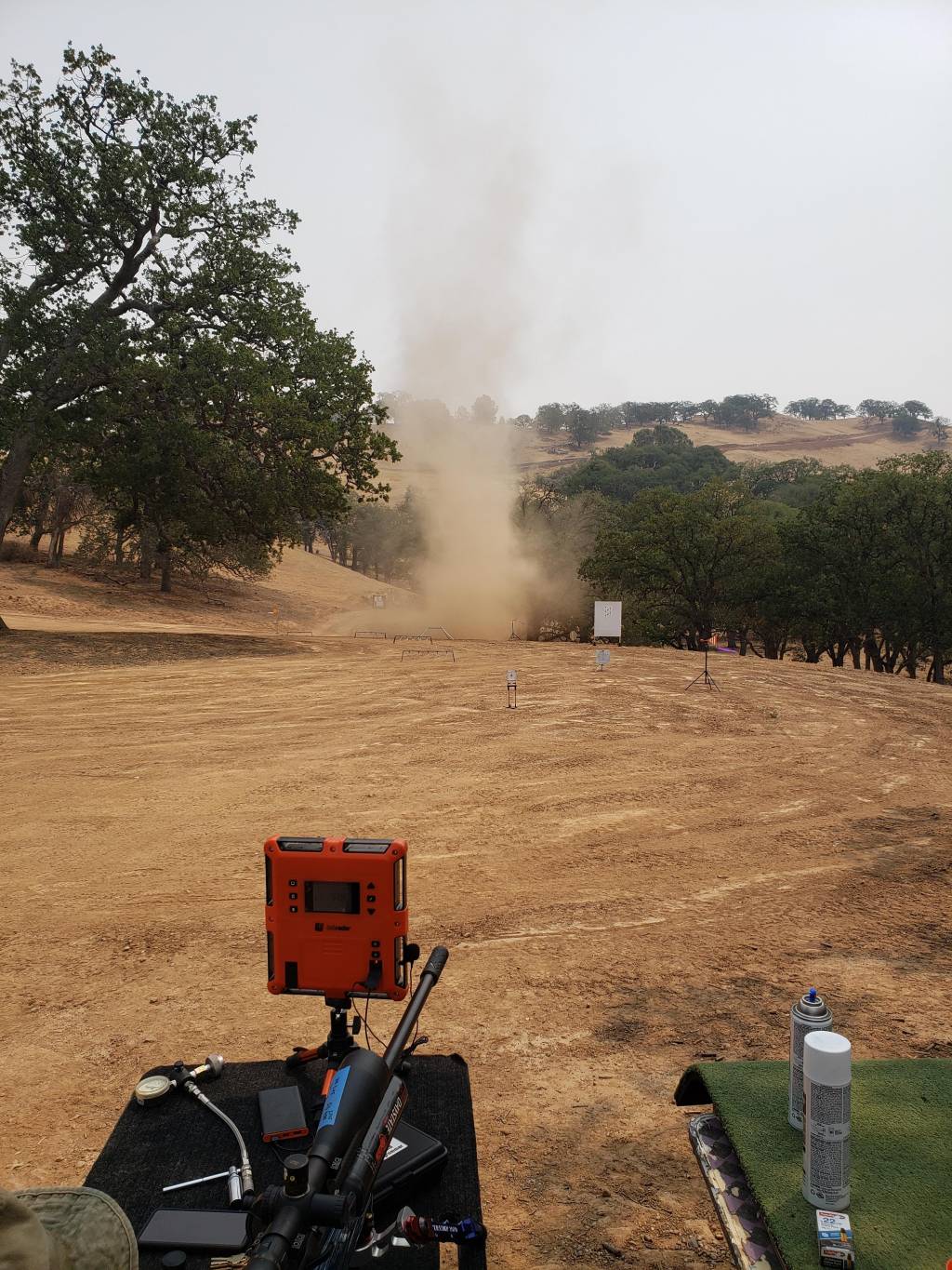

Snuck out with the the guys this weekend for some tuning and shooting at 100 yards. Happy with my current tune slinging .22 redesigns at 970fps for 56 shots per fill . Swirling winds but put down some decent groups...
