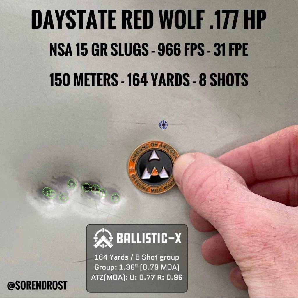

The only thing that did cheer me up was Soren shooting his .177 HP Redwolf at 164 yards with slugs and an 8 shot group way less than 1 MOA, Soren is waiting patiently for his DELTAWOLF in .177 HP to arrive!
