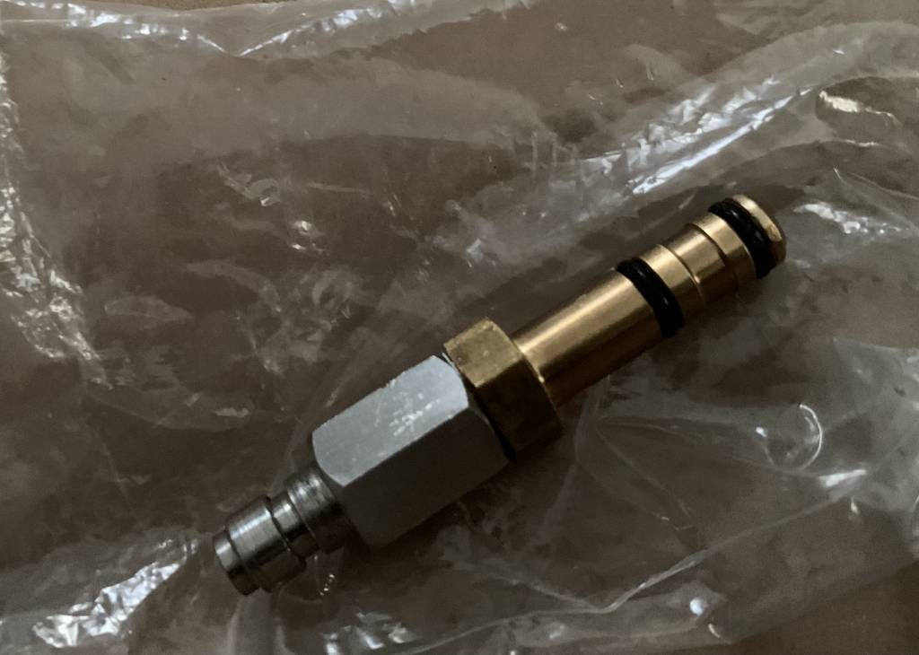

Here’s what I was referring to for your guys that may not be able to picture what we’re talking about. The foster fitting (male nipple) is the silver portion. The fill probe is the gold part.
