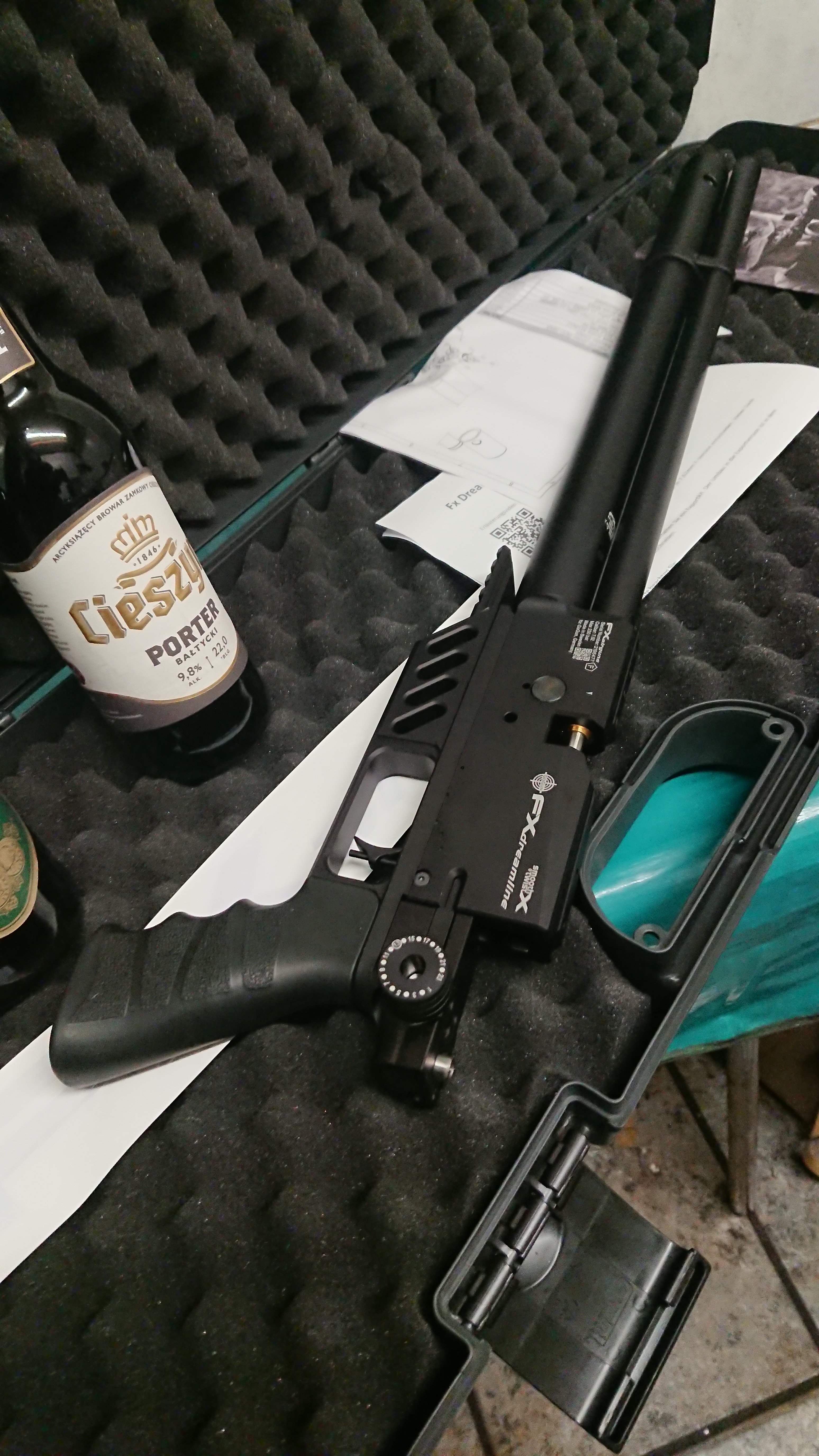

its finally here.. i put it together- meaning back to its original power instead of 5.5fpe because i was in holland and could do that legally..
anyhow- i changed the port dial wheel, added the hammer weight (there was none-just a piece of plastic tubing :LOL: ) and cranked up the reg to 110 from the restricted 60bar..
but one thing was there that i did not use because there is no use for it in my DL..

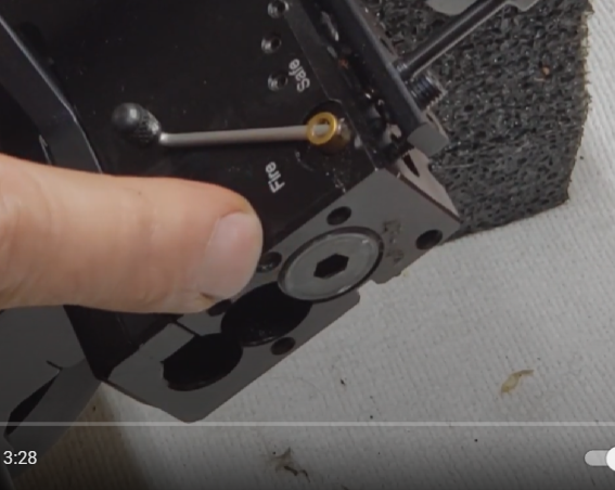

its this black endcap that you see on this guy video- he even explains that its to put a tension or preload on his spring..

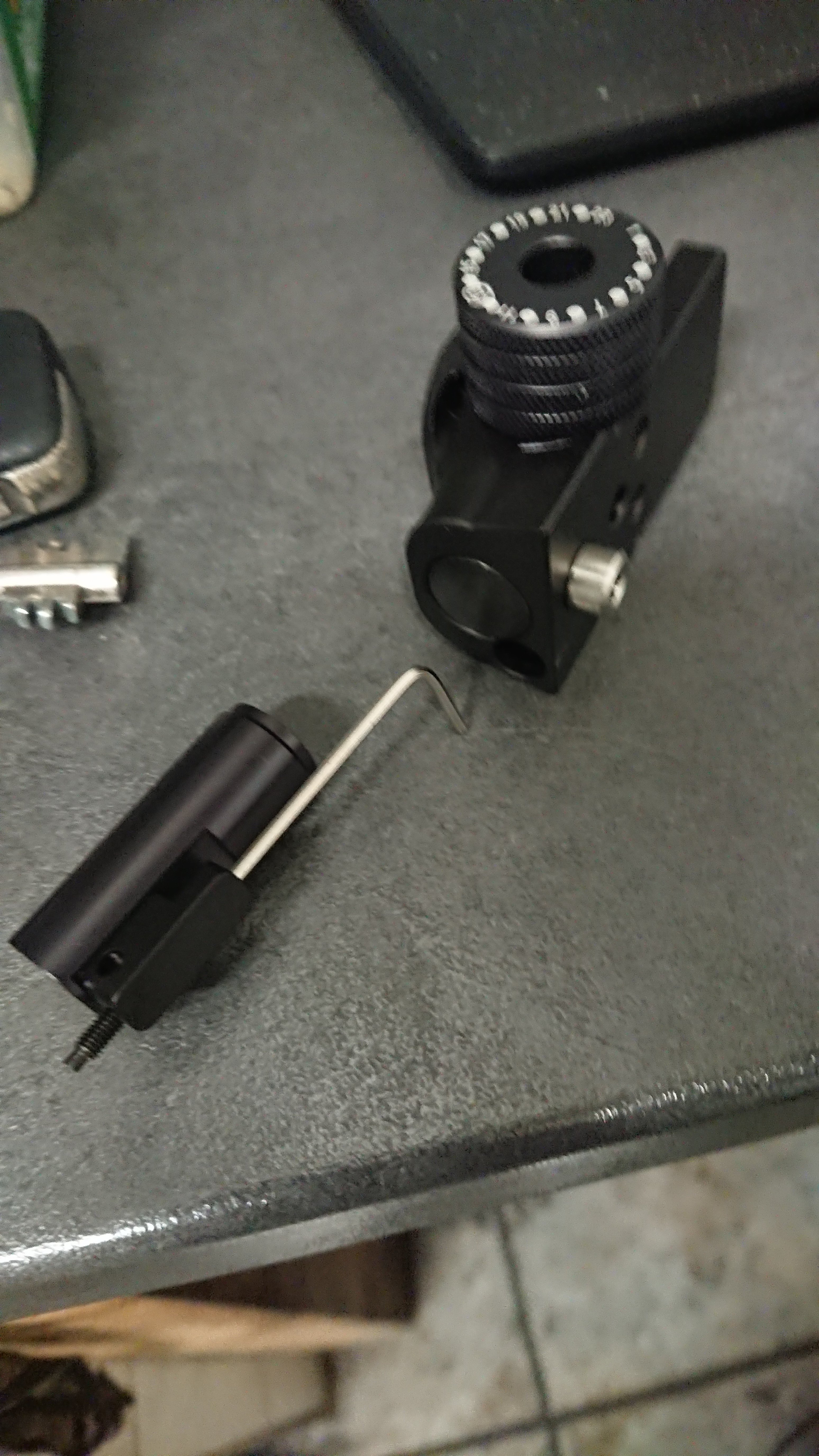

well- i have the tensioner with a dial (hammer power wheel) to put tension on the spring so i can not put this black endcap (with torx hole inside) because that's where my tensioner goes through ..
so, what's the deal with this endcap- i think the fx puts it in the high original power kit if i want to get rid of the hammer power adjuster and just cap the spring manually for tension or what is it for??

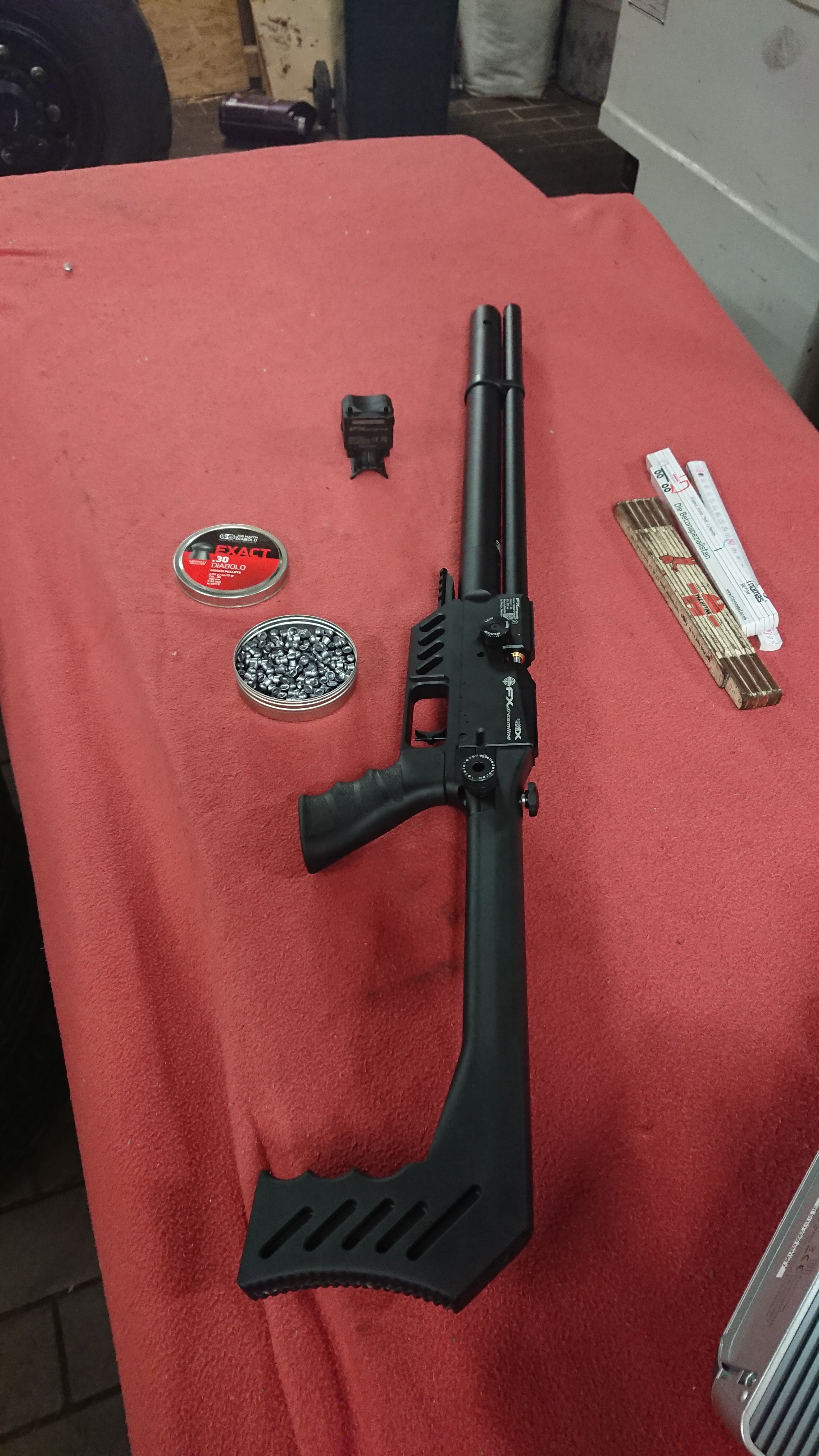

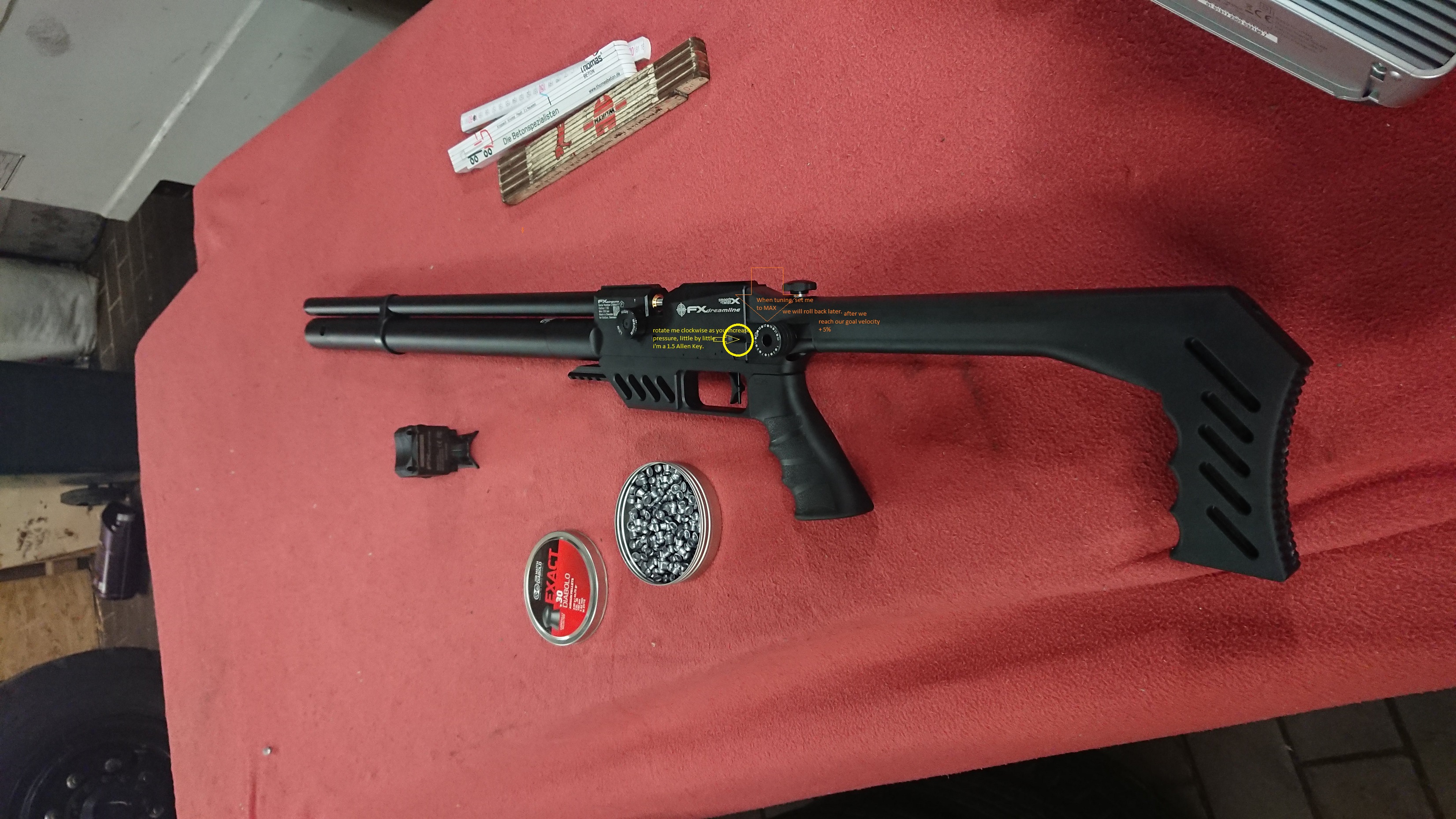

here is mine before i changed the parts..

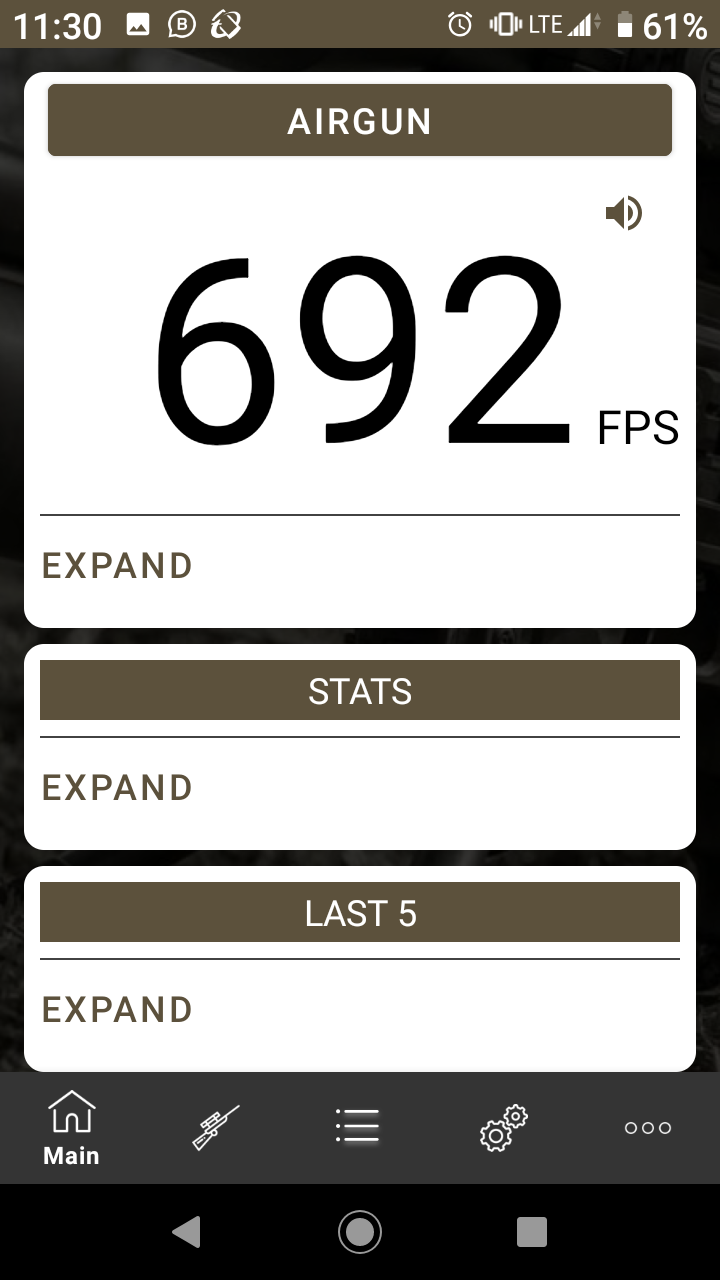

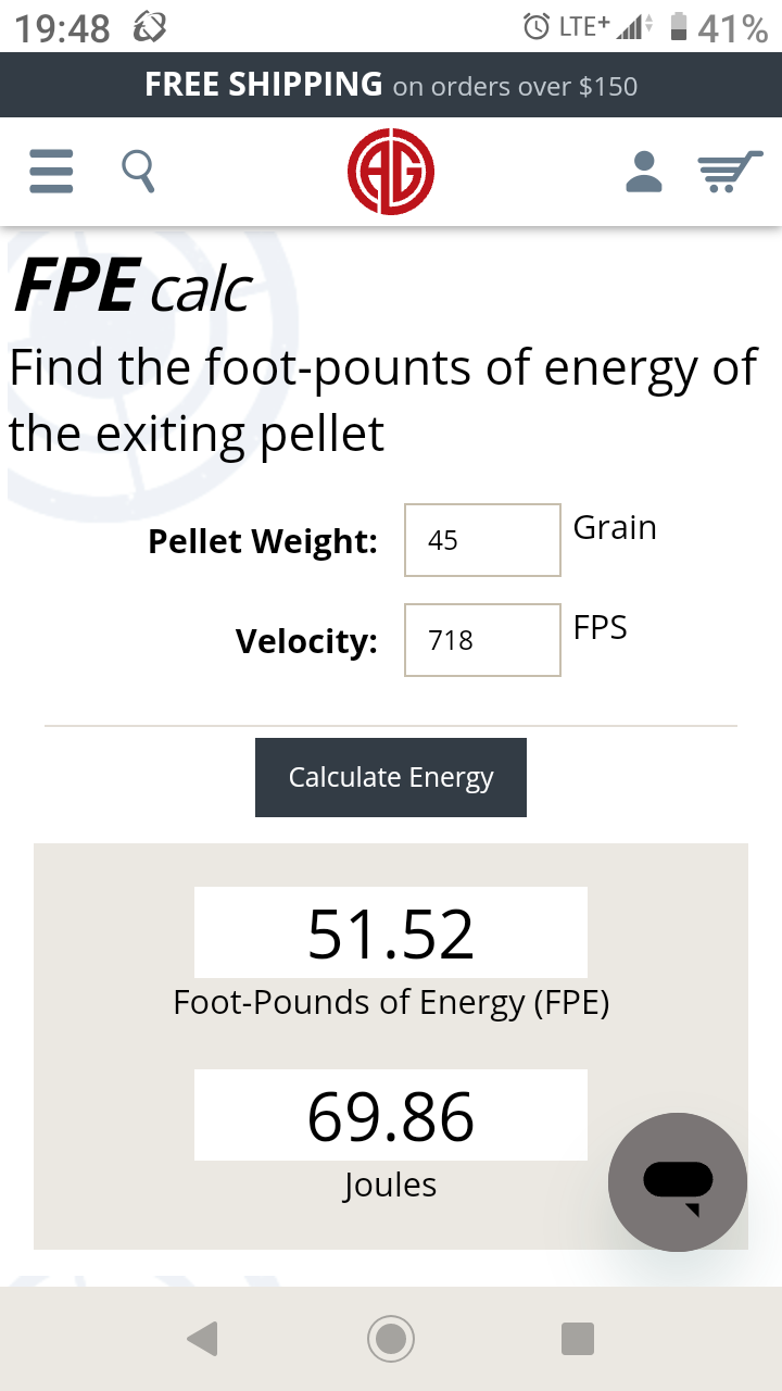

and here is how she shoots- just one shot, only 110bar on the reg and 130bar in the cylinder, power wheel on 15, spring tension high, 45gr pellet going 718fps which gives around 50pfe or 69j- is that ok?

the end cap is the original hammer spring tension nut.
the wheel version is different.

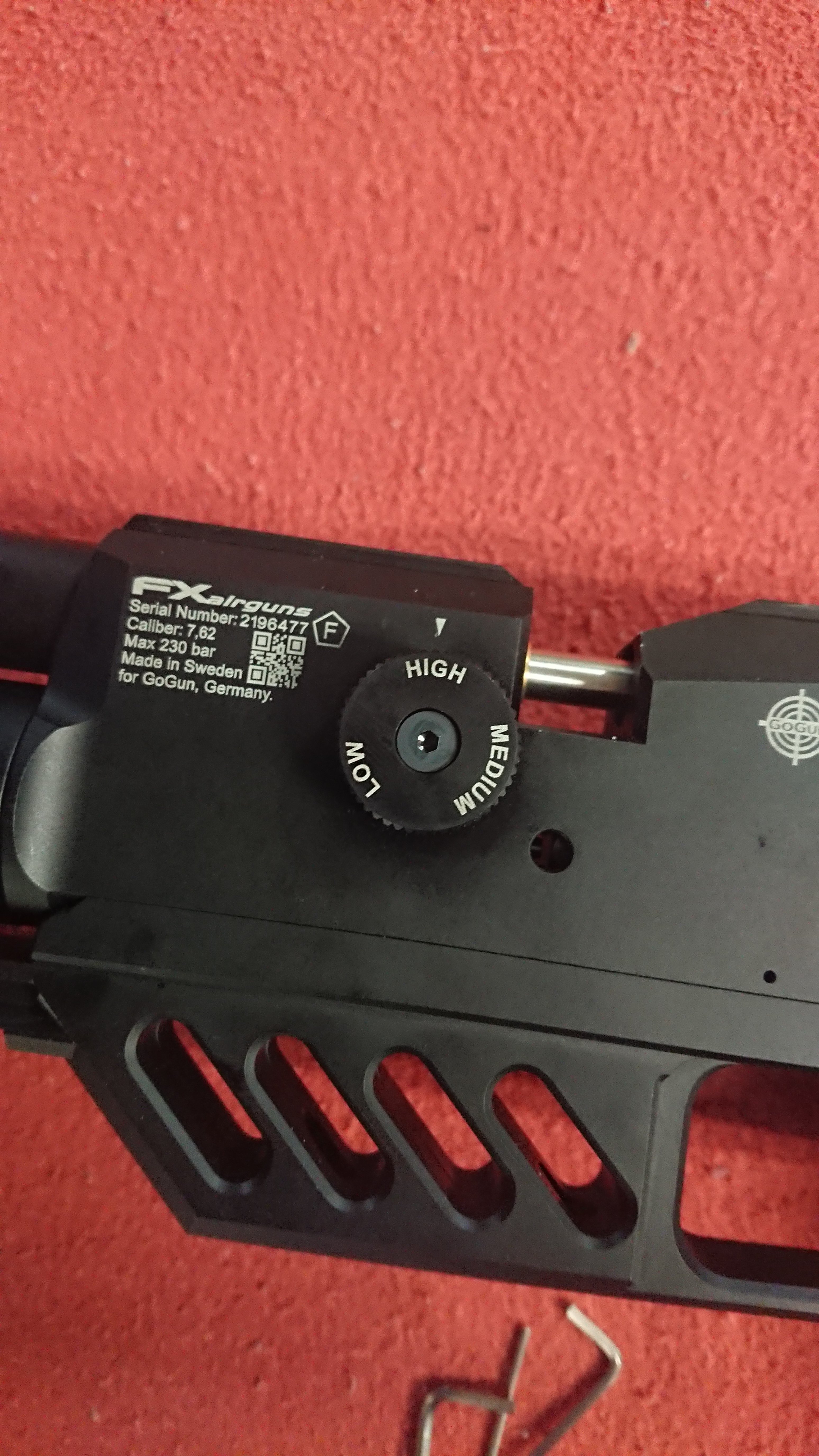

fine tuning screw- you mean that little tinny screw which i screwed out with a 1.5 or 2mm allen key?
i screwed it out but perhaps too much because i could not turn my power wheel so i backed it up till i was able to go up to 23 on my wheel..

Thats it, but its best to adjust it IN place. you cannot just pick a position off the gun and put it in. This is a balancing act of the gun, Spring tension and pressure, Its setting is relative to the guns settings.
yes- i hear you and i will do it only inside the gun..

you know i was getting 718fps with my 45gr jsb which was around 51fpe with reg at 110 and power wheel on 15- ok, you said it was low and i agreed because i too wanted to get the most out of it and then i could always back up to make it precise with less power... but first i wanted to get the most fpe..
so far so good..

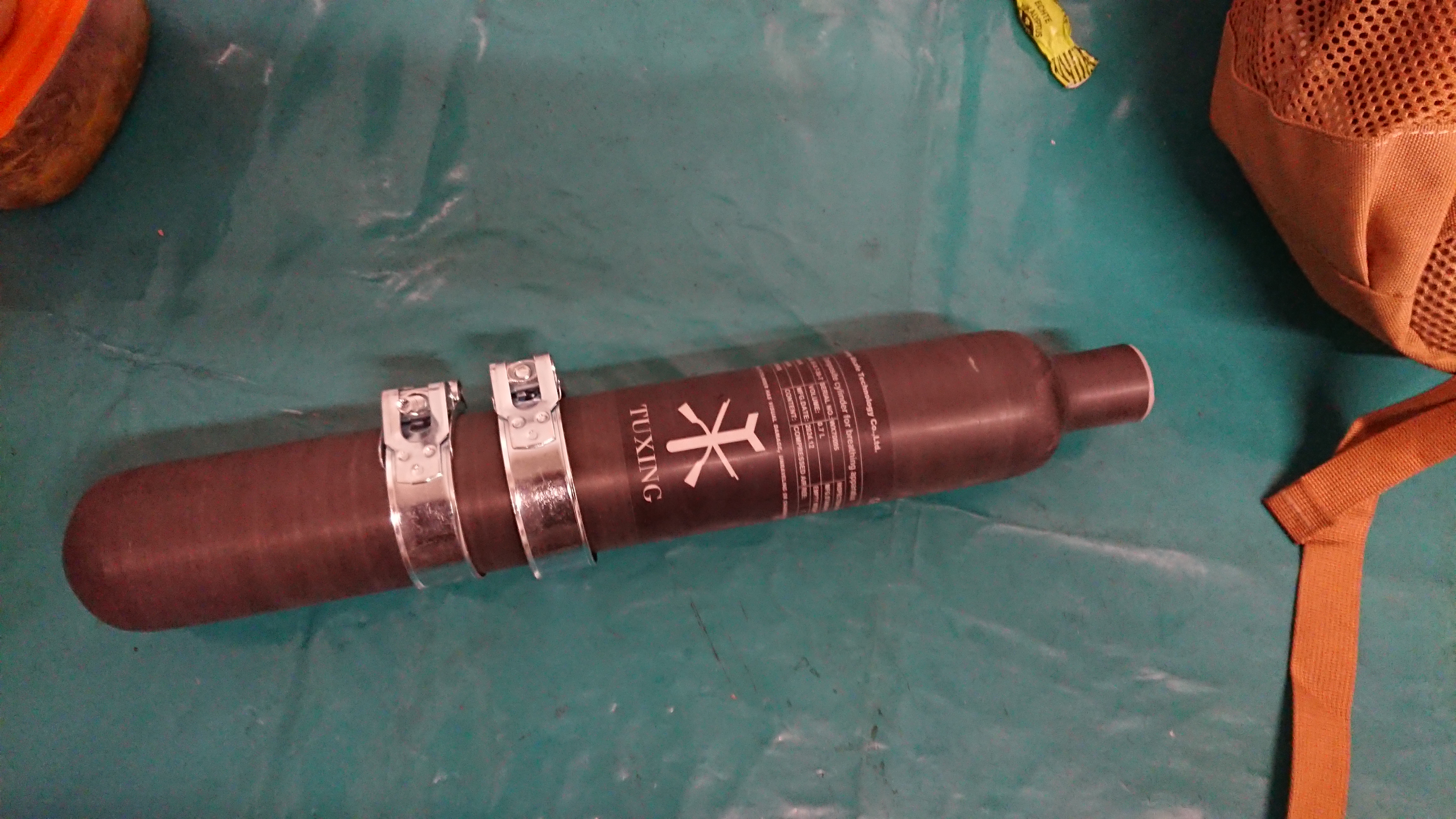

that was right out the box.. but now i put the big 700cc bottle and the new bottle adapter (with new regulator inside it) and even an extra 17cc power plenum in front of it..
then today i went and
1.cranked the power from 0 (did not have the 110 from Friday because i needed to degas to change the bottle) all the way up to 160 on the reg
2. cranked up the power wheel to 23
3. cranked up the tension on the spring with allen key till i got the highest fps and wasn't able to turn the wheel any more so i backed off a little so i could turn the power wheel again and lost only maybe 20fps but-
after all this cranking up done in steps 1,2, and 3- i ONLY got 716fps!
what is going on??
that's even less then i got on Friday without the bottle, bottle adapter and extra plenum :mad:

i just made that photo bigger of my gun where you typed over some text- i did not see it till just now, after i shot it..
and noticed that you write to do the cranking up of the reg and tensioning the spring in small increments- well, i did not know and didn't do it in small increments today- i just went ALL the way up at once..

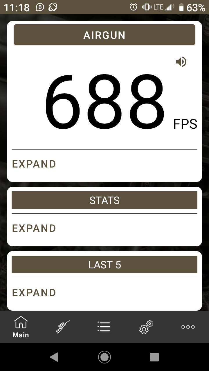

i was on 130bar reg and 23 power wheel and tension low..
so i turned the tension all the way up till the 1.5 could not go any further- the fps stopped increasing at 766fps
so i dropped the tension quarter turn and increased the reg pressure to 137-140... the speed was still 766fps so i wanted to add 1.5 tension but the tensioner 1.5 is already maxed out from the previous step with 130bar..
so how am i supposed to keep cranking up the tensioner 1.5 when its already maxed out in the first step with 130bar??
it makes no sense, there is no more 1.5 thread left

Dude. I told you. Once the fps stops rising. STOP Increasing the 1.5. At that point. RAISE THE PRESSURE 5-7 BAR. it did work. As your velocity at 160 with full 1.5 was 716. NOW YOURE AT 766 at 130
130 is the STARTING POINT. You cannot just magically make 130 produce more once the 1.5 HS screw stops producing results. I've explained it several times over. Brother. You've gained 50fps and you're only at 130.
130 is the starting point.
I told you in 2 or 3 messages that once you've reached 130 and the adjustments of the 1.5 screw either stops increasing or stops dropping to back that screw off a tiny bit and Increase pressure another 5-7 bar and then start increasing the 1.5 screw again until again, the velocity stops rising or drops. Then Increase again. If you just set the screw high and the pressure at an arbitrary higher pressure you're not going to have the hammer spring and valve balanced and you'll as you've seen have Jack poop velocity at high pressure
