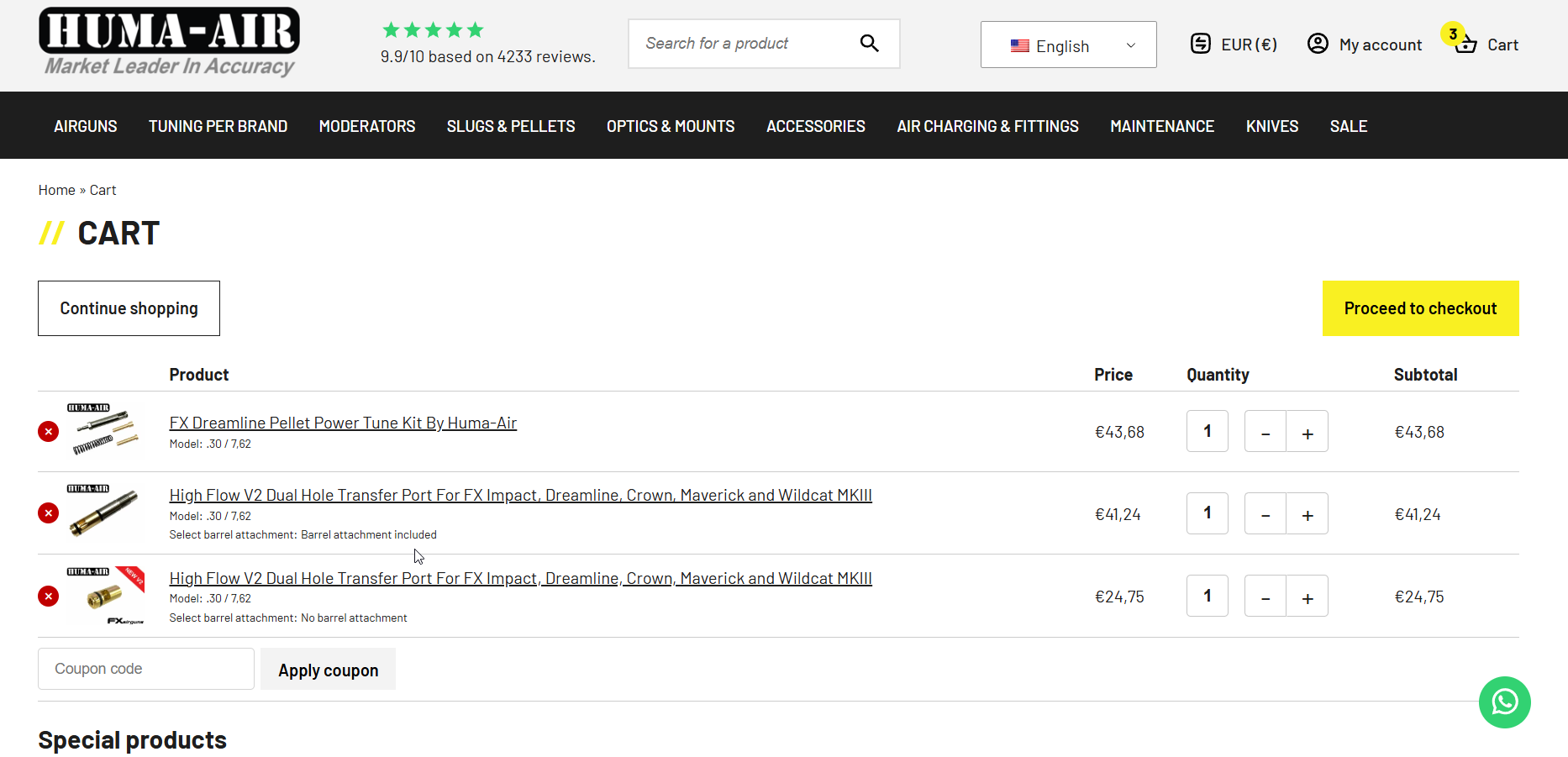

i am not sure which dual v2 port to order- with barrel attachment or with no barrel attachment?
There's nothing else you can get. The restricted flow of the valve seat will absolutely be the most helpful. If that is restricting flow you might not even need the power tune kit. However getting them anyway won't hurt. It'll just make more power and give you the ability to shoot 50gr pellets better.
i got this narrowed down to these 3 items but one v2 port is right and one is wrong- but i am not sure which, maybe i get both and return one unused.. or maybe take the gun apart and see what i have inside- but how to do it?
yes- i am getting all these 3 items so i don't have to second guess what if..

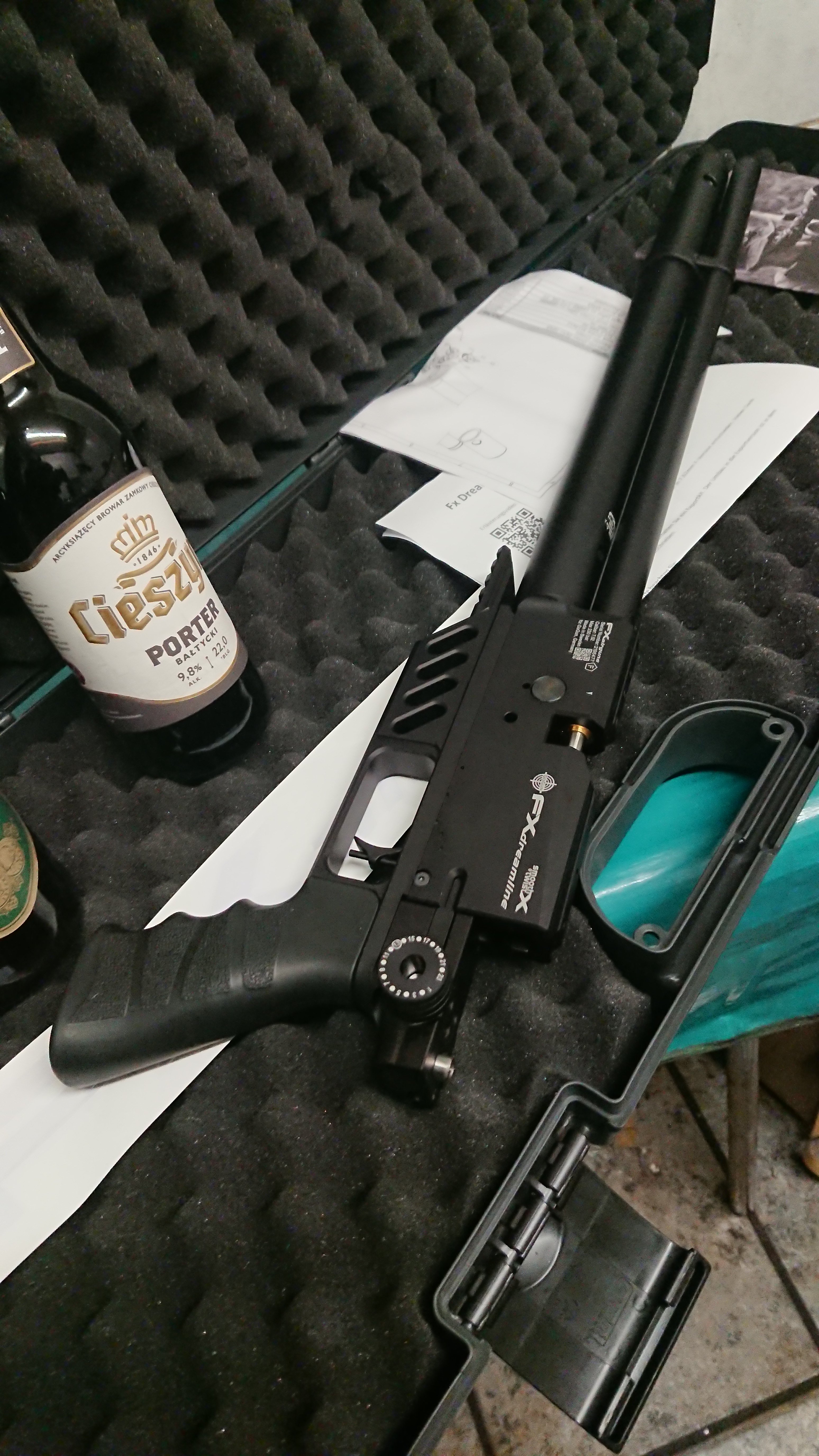

take shroud off- never done it.. you mean just take off the entire barrel assembly which i did when i put in the bottle adapter or take the barrel assembly out and pull the barrel out of the shroud?
i guess you want me to just pull the entire barrel assembly out of the gun and make a photo of the breech- the hole where the barrel assembly goes in..

i just ordered the valve seat in spain- 26euros
the other 2 items- pellet power kit and the port v2 i will order tomorrow after we confirm which v2 port i need- the one with barrel attachment or without..
No. The shroud, the black aluminum tube that is the outside of the barrel assembly, it houses the liner. It should twist off. It looks like you have the super light barrel.

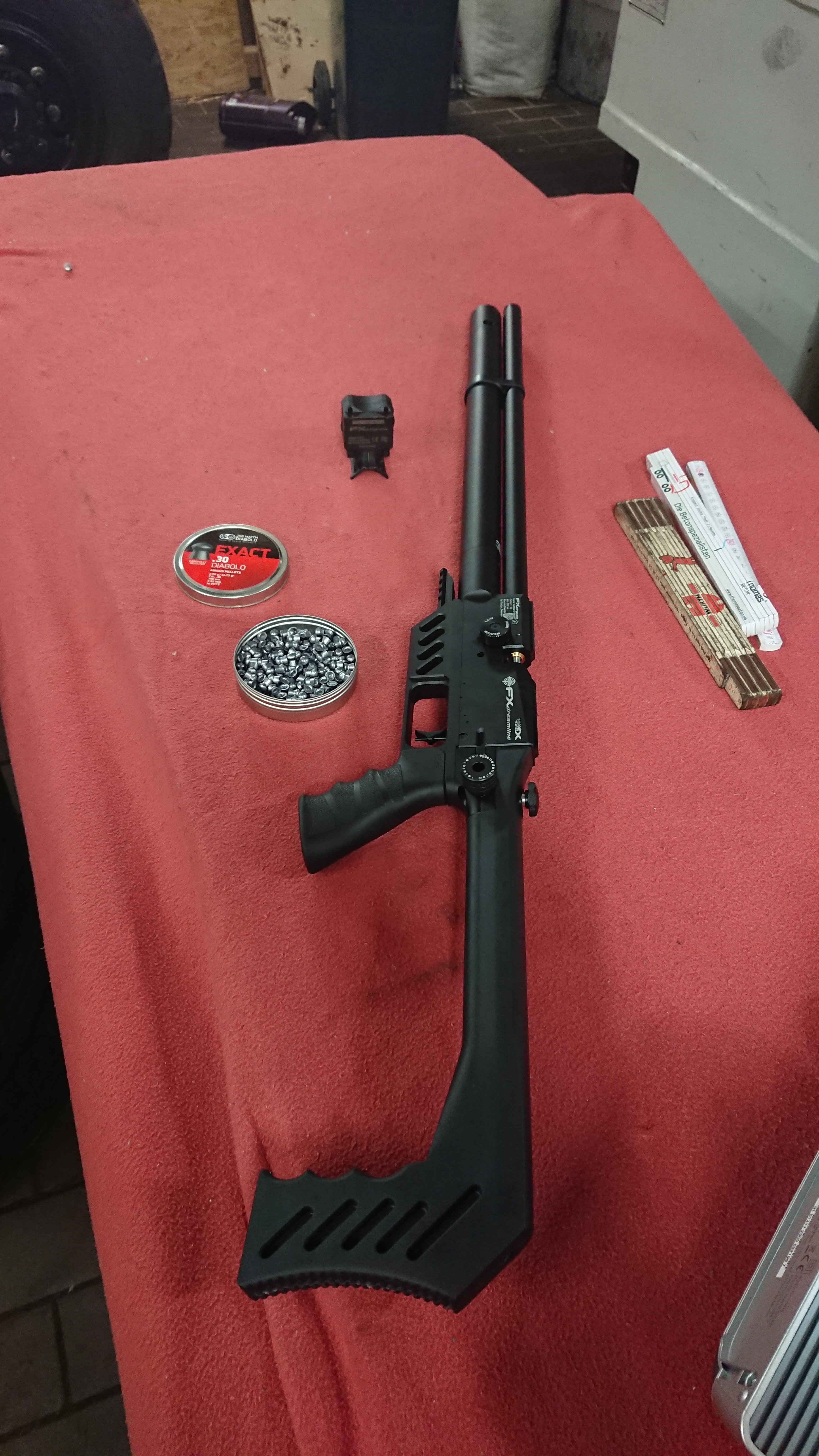

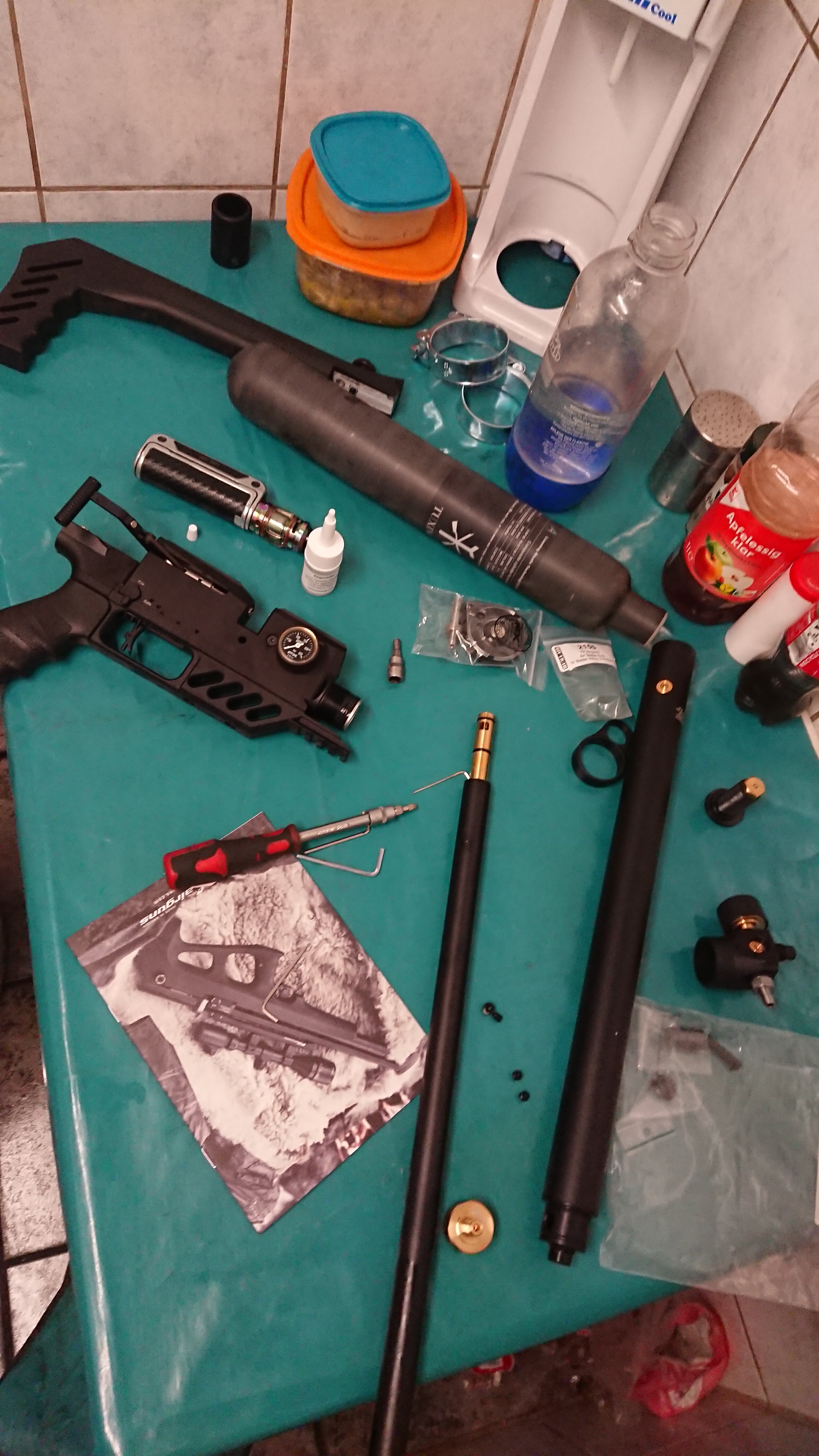

ok. .i found some pics from few days ago, check out the barrel when i had it on the table- it looks like a dual v2 transfer port with a bridge- don't it?

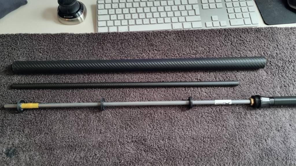

and check the tube before i replaced it with bottle
It looks like it, but the Huma version is called hi flow because there is more material removed over the stock. More air flows. It makes a difference. It's not the same.

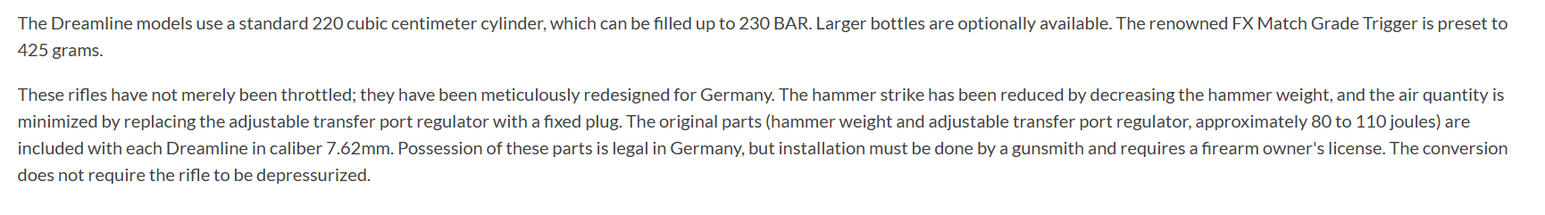

check out the text i found at the dealers website- it tells what has been restricted- but it doesn't say the spring was reduced... maybe it is an original spring and it says that it will make 80-110j when opened with the 2 parts included..
and i did make 80j today but---- its too little for me (770fps is to slow), i want 110j with 950 fps or soo! so lets modify this stupid fx gun all the way up
950 is 122j with 44gr. Faster and harder isn't necessarily better.
The dreamline and crowns use different shrouds. They use the same liner lock and barrel connection. They are both a thin aluminum shroud, with a liner locked into the breech, not secured by a threaded jam nut from the front of the barrel shroud. The super light is the liner centered by bushing discs inside the light hollow shroud. That carbon fiber tube is a barrel sleeve.i have the damn thing on my gun.
i just hope i don't have the light barrel because you said its harder to work on as the normal barrel, that's all.. i might not do it if its to hard- and here is no one to help, no dealer, no gunsmith hence illegal
