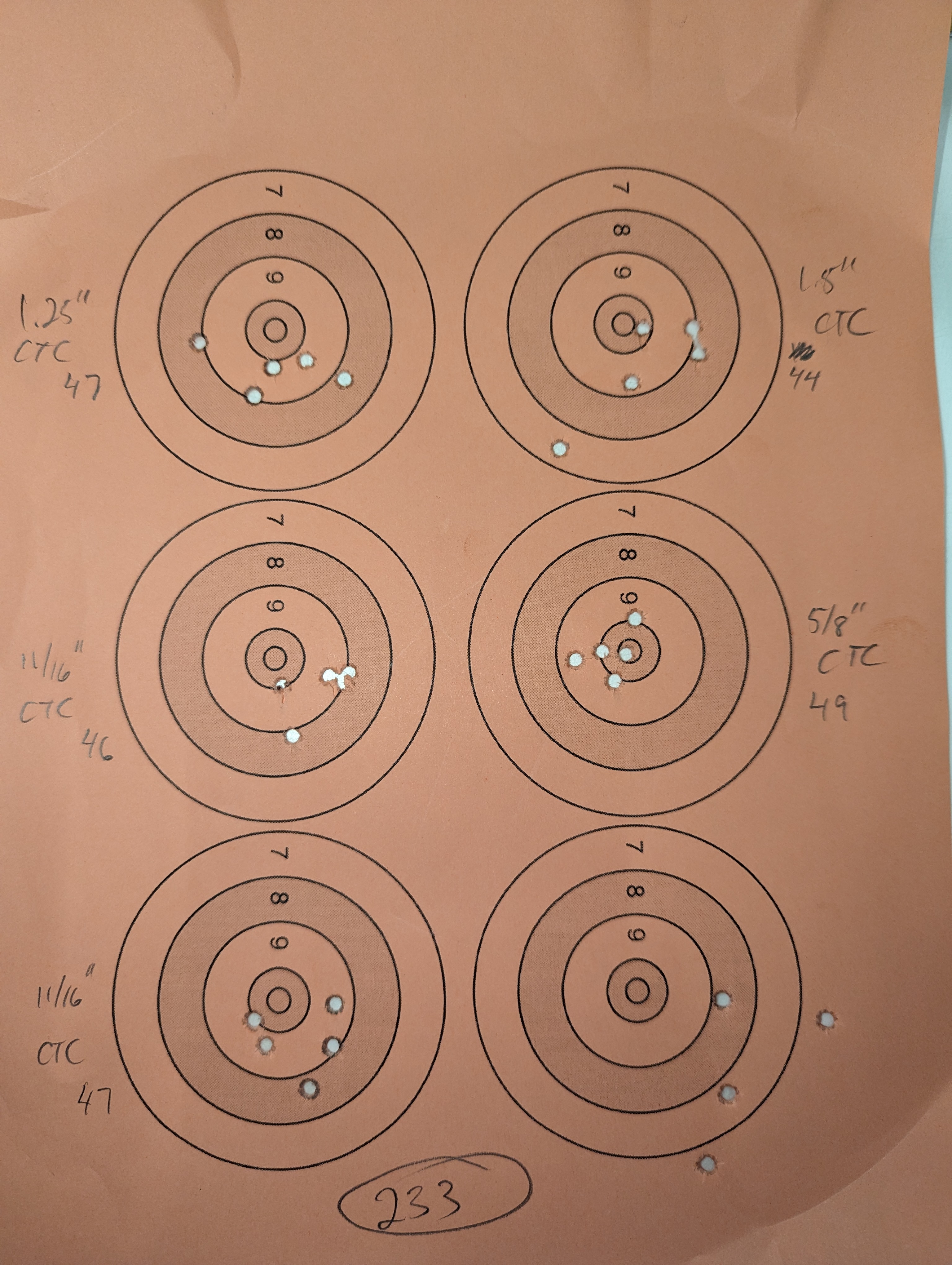

Here is the most recent example. This was shot just a few evenings ago after I'd gotten home from a field target match. Hadn't scrubbed the barrel in a while so pulled the barrel and the shroud and gave the bore a thorough clean. Put it back together, walked some paper down to 100 yards, and shot this. The bottom right bull were my sighters, after that I moved up to the upper left and took 5 shots, then upper right, etc. That first group of shots that "counted" is stretched a bit right to left, telling me I should have taken a few more sighters to figure out the wind. The upper right had one shot drop low, about as bad of a flyer as this combo produces. The final 3x5 shot groups were pretty dang good though. So, the best and worst work out to 0.6moa and 1.4 moa. Average of the 5 shot groups is 0.95" or 0.9072moa. This is the first 29 consecutive shots after the barrel was cleaned (4 sighters and 25 counted shots). For those familiar with the EBR target format, out of 25 shots, 10 are 10s, 14 are 9s and the "flyer" is a 7. The EBR score would be a 233.
This is the second more recent example, shot maybe two weeks ago. I didn't use the EBR target, but just a 8 bull target. The larger circles on this printed target are 1 and 3/8" so it makes the groups look worse than the larger bull EBR targets above. There are 8x5 shot groups here, sighters were in the upper left, and "count" towards my average. This is also all consecutive shots, just like the target above. So this is 40 back to back shots. Again 100 yards. Best group was 7/8" worse was 1.25." The average of these 8x5 shot groups is 0.98" or 0.9358MOA.
These are not the only examples of the AVERAGE 100 yard sub moa results, just the most recent.
The primary parts of the recipe are: a BRK Ghost with a 12 land and groove, choked .20 Lothar Walther barrel shooting the NSA .20/18.9grain @ only 875-880, for about 32fpe.

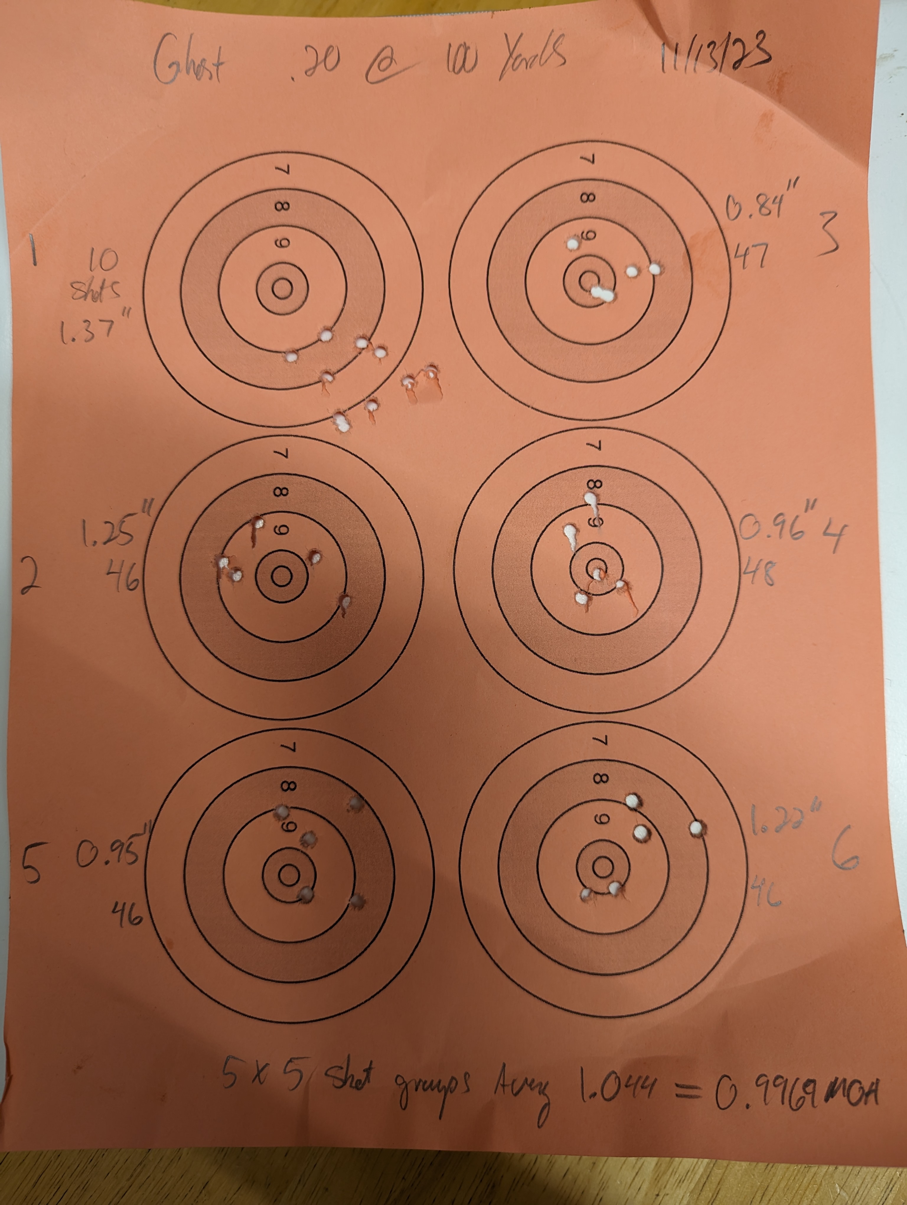

Shot another 35 of the .20 slugs just now. 100 yards. I changed a variable though, added a moderator.
Bulls were shot in the order I numbered them. Took ten shots at the upper left first. Concluded that the moderator shifted me right about 0.3mils, and down about 0.3 mils. I added the three clicks of vertical but tried to just hold off the 0.3mils for group # 2 (middle left). That didn't work so well so I clicked in the 0.3 in the windage turret before I shot group #3. Continued on to group 4, 5, and 6 with the same turret settings. Some of the holes in the bottom right group (group #6) look bigger than the others but that's because the paper was bulged out down there, from where the edge was contacting the bucket pellet trap.
In the scored groups I'm seeing 2x8, 10x10, and 13x9, so totals out to another 233 EBR score. Those five average 1.044 inches, which is 0.9969MOA, cutting it close on this one. Technically if the 10shot sighters group is included my average I'm over 1 moa. I'm not that nitpicky though, still pretty pleased with this combination. Simply more of the same. I think the added moderator cost me just an ever slight bit of accuracy, when compared to only using the shroud.
With and without MOA coin, for reference and to prove that I'm not hiding a hole in the paper under there. 😬

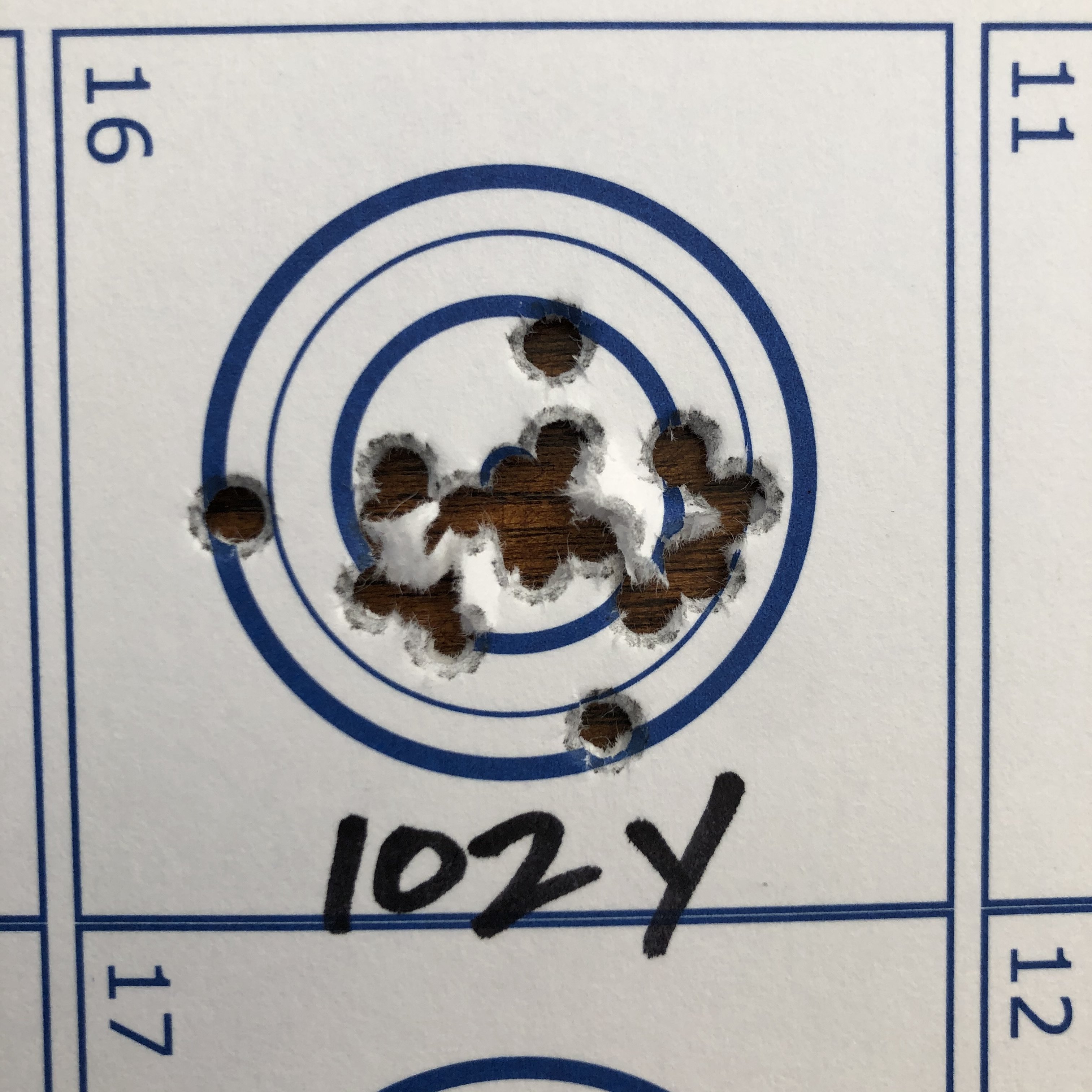

Cole, here is a 25 shot group at 100 ish yards using 22 cal jsb knockouts out of a LW poly from
a little over 3 years ago. The first thick ring is .875 at the outside.
I’m certain 24 of 25 is under moa and maybe all. 25 on a single group is a little tougher though. I’m guessing these have a similar BC to your 20 cal slugs. These were shot off a 2 piece setup with sand bags.
Mike

THAT'S the stuff! Great group.
