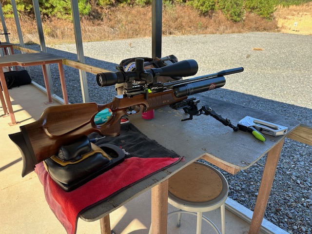

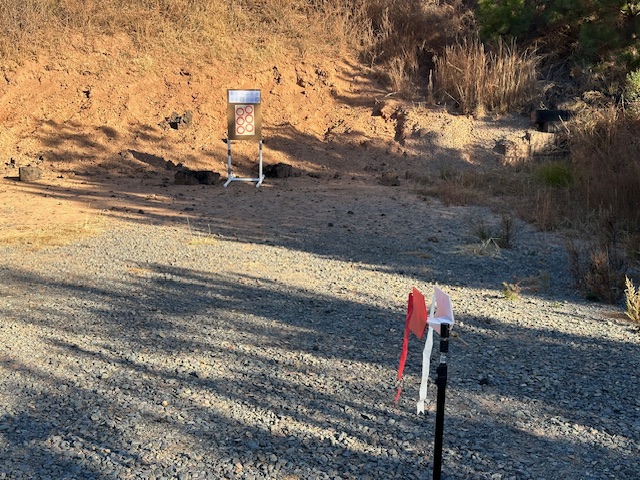

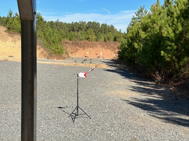

I got out today at my 100Y range with the FX Boss .30 caliber shooting the JSB 44g. Had two flags deployed, wind was light when I started and then picked up a bit. However, my Kestrel had an average of 2.5 mph from the bench, but I tried to pick my holds.
Boss .30 Caliber with ST barrel
Sightron Mil dot 10X50X60MM
Accu-tac Bipod
Rear Protektor bag
Pellets - non sorted or sized

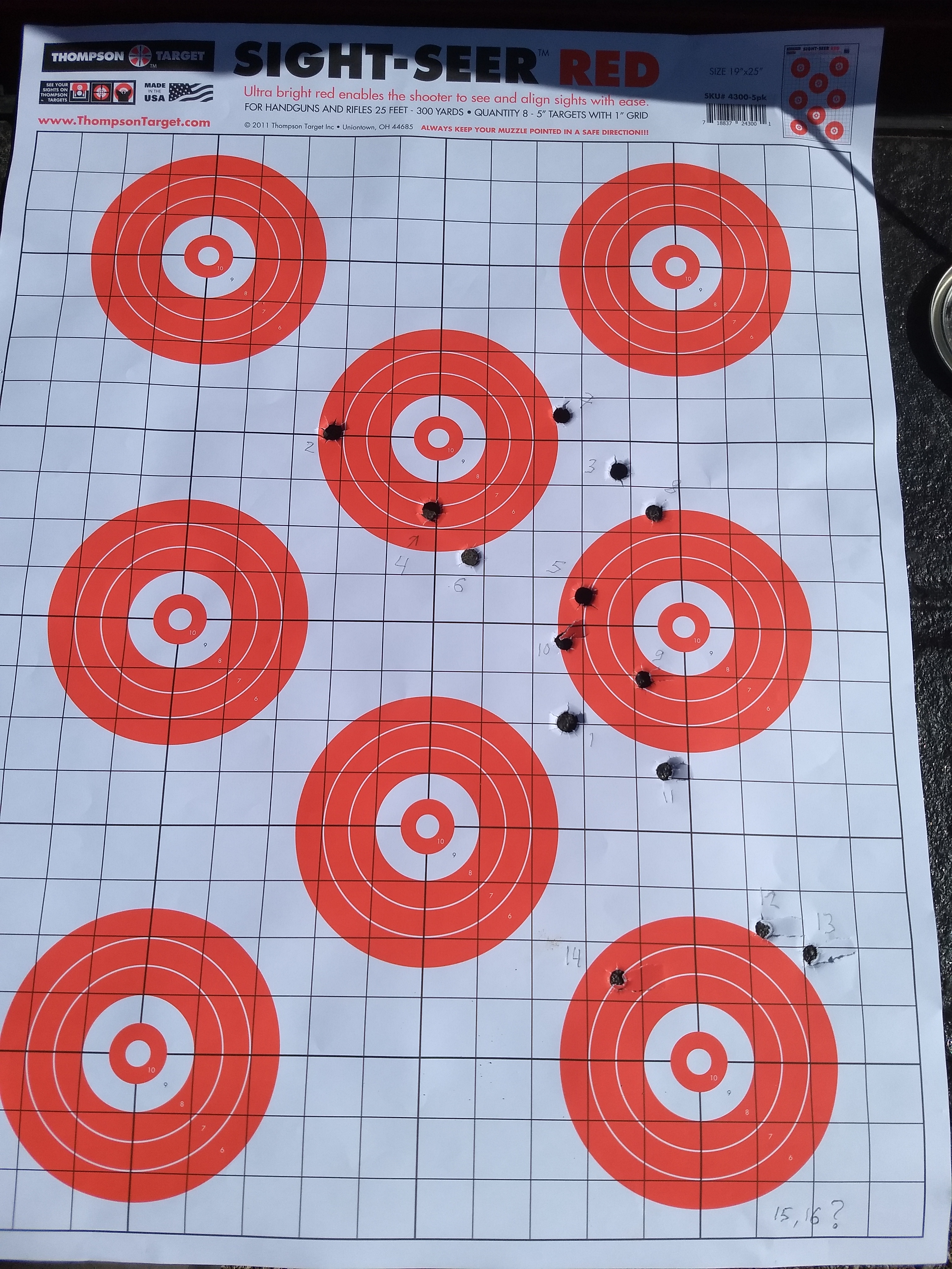

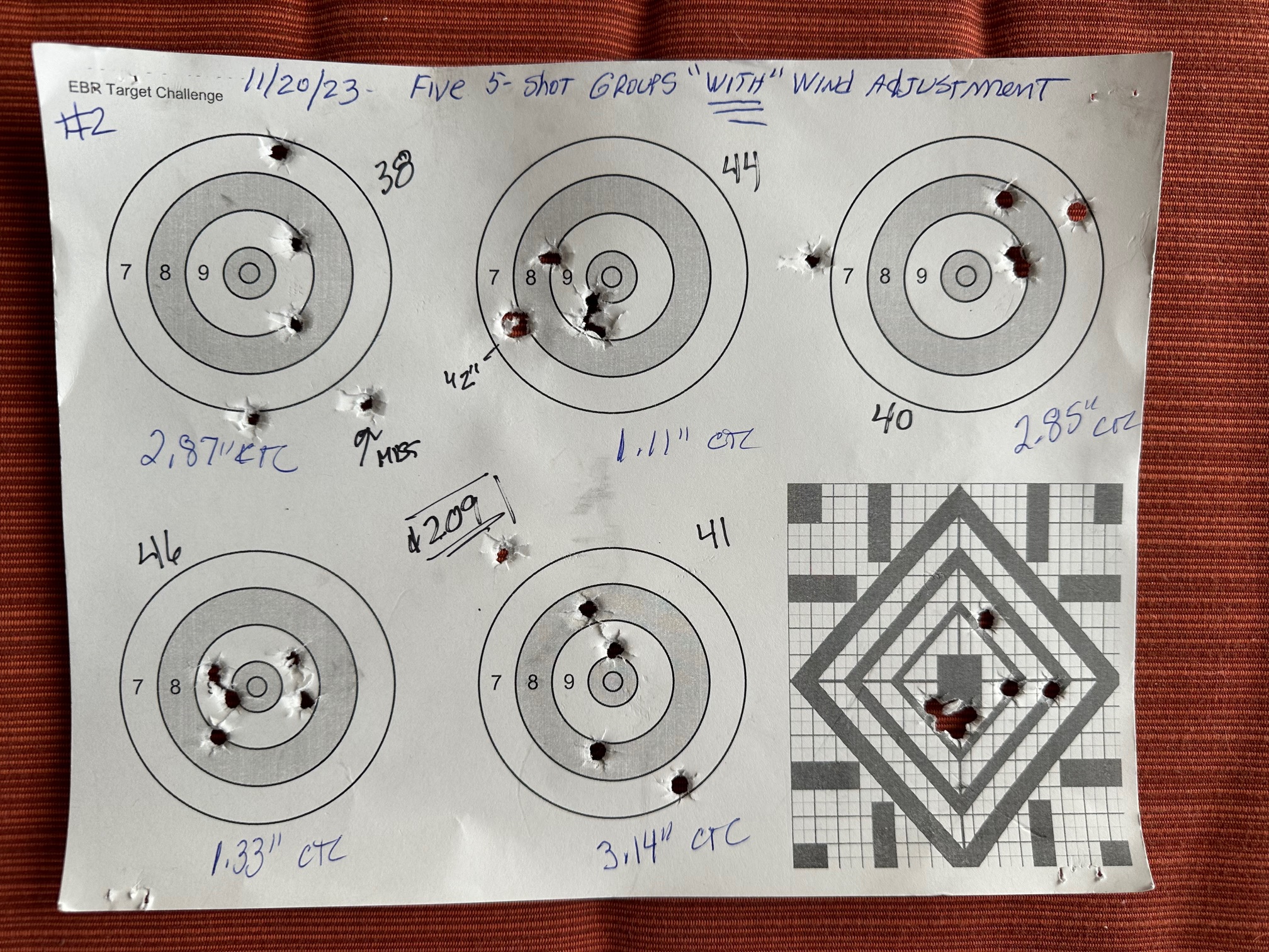

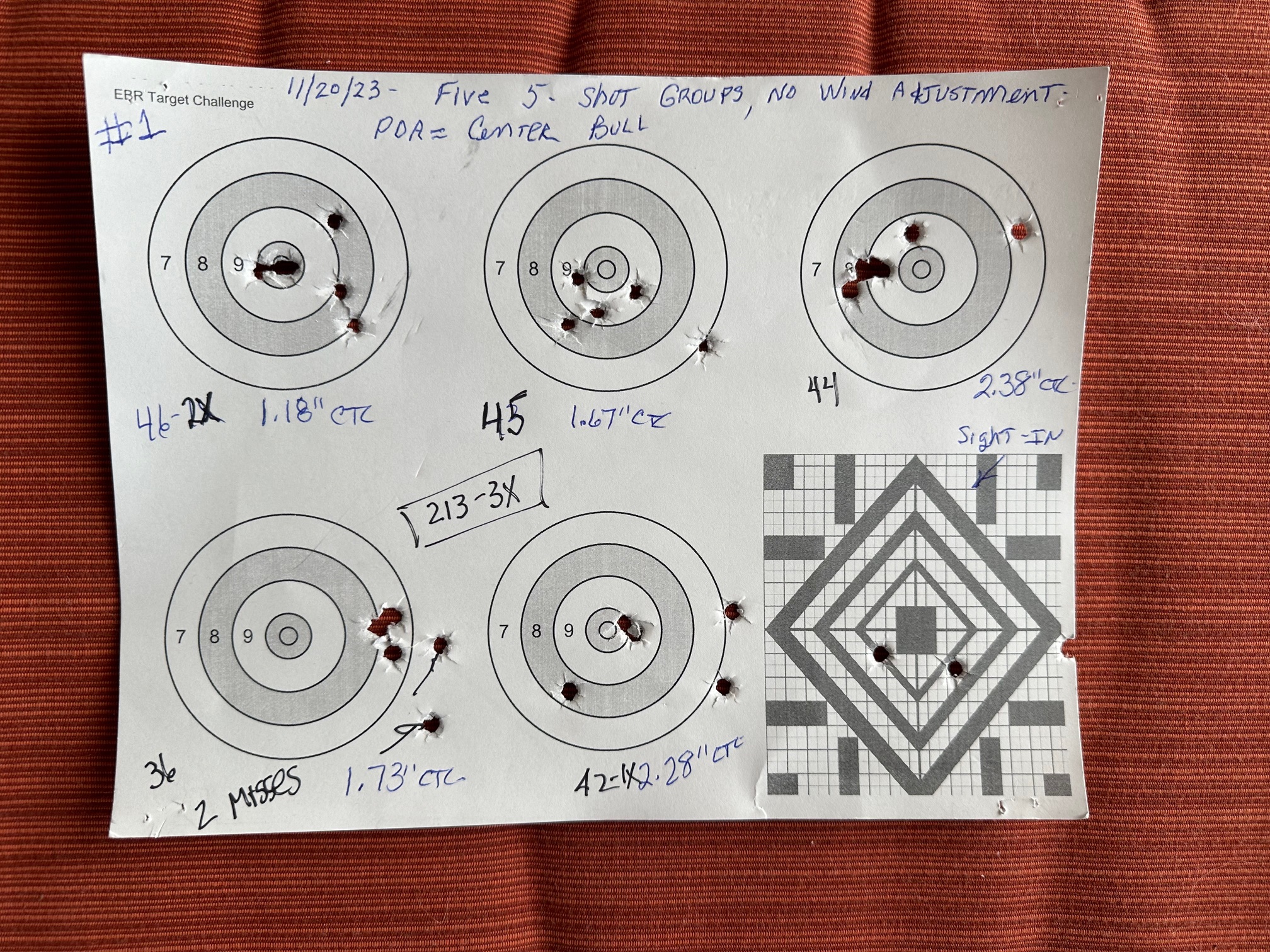

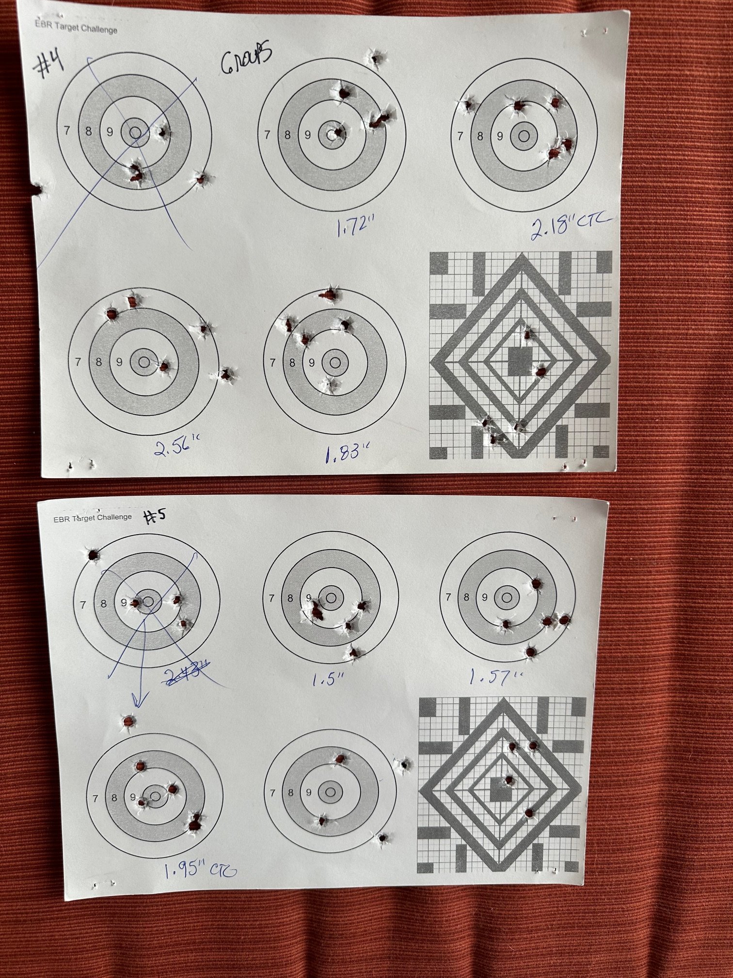

I shot a total of 17 five-shot groups across 5 EBR cards. I annotated what I did on each card. My total 17-card average CTC was just around 2" - Math was 33.85 / 17 groups - 1.99". No MOA groups today, but I had two or three that were slightly over an inch.
Some interesting finds: I shot two EBR cards to test shooting 1) without wind adjustment ( same POA for all five bulls); and then 2) with adjusting for wind and trying for score. When measured for score, the one without the wind adjustment was better at 213. The 209 was worse with adjusting for wind. Ha Ha, I knew I couldn't read those stupid flags! :)

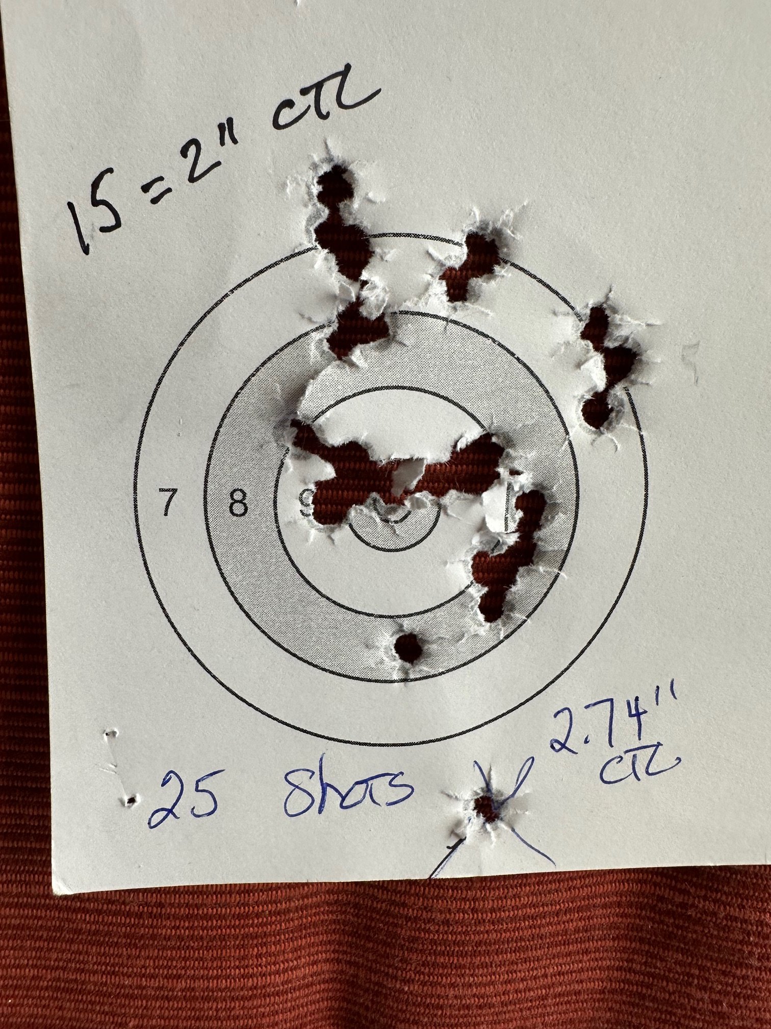

I also shoat a 25 shot group ( see attached ) and about half of the pellets were about 2" CTC.

@tommyb, you've got some quite good groups in there. Thanks for sharing so many consecutive groups, not many shooters are willing to do so.
In the past I've tried what you did, NOT jumping around for my wind guestimation, and comparing it to how I do when I DO jump around for on the fly wind adjustments. And I've found what you seem to have seen in this session: that groups are usually about the same, whether I'm trying to "read" the wind, or not. So I typically figure out what the prevalent wind is doing to my shots with a few sighters, and then hold there for all the counted shots. Ie, if it pushed most of the sighters 0.2 or 0.4mils to the left, then I hold (or dial) 0.2-.04mils to the right. Reading the wind and making on the fly adjustments is certainly a skill. And reading and using wind flags to make adjustments is an even greater skill, and one that I don't possess.

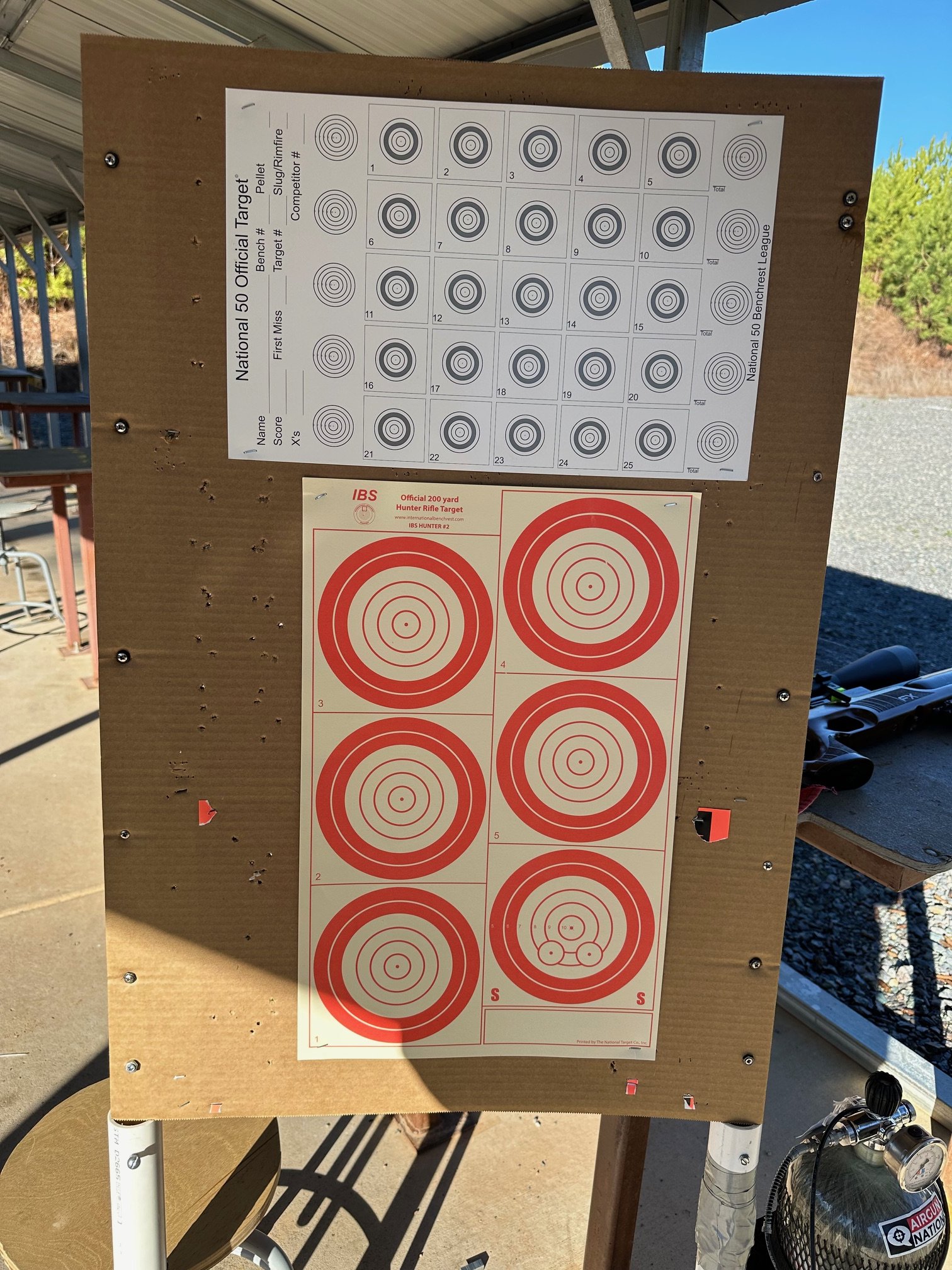

Went out to shoot my FX Boss .30 at 100Y yesterday. I used the N50 " in the rings " scoring system to score my three 100 attempts.
Interesting in that my average MOA for 75 shots, was 1.25"; but my scoring was not so good. I shot three cards and the best was a 1775, which is a good score for me and this rifle. I did manage to keep most of the shots in pretty tight groups, but I hit the outside ring so many times and that wrecked having a really good score. There were numerous ring/line shots that if they were a hair towards the center would have given me a 100 for the shot vs. a 50.
As others have stated, you need a 1/2 MOA gun to even have a shot at a 2500, or a lot of luck! The Boss shot very well today with the 44G pellets, this gun does not shoot slugs. I had five or six sub-MOA groups in that mix. There was virtually no wind, that I could detect and only a slight breeze at times. The target at bottom with the red bulls, was used for sigting in and testing purposes.

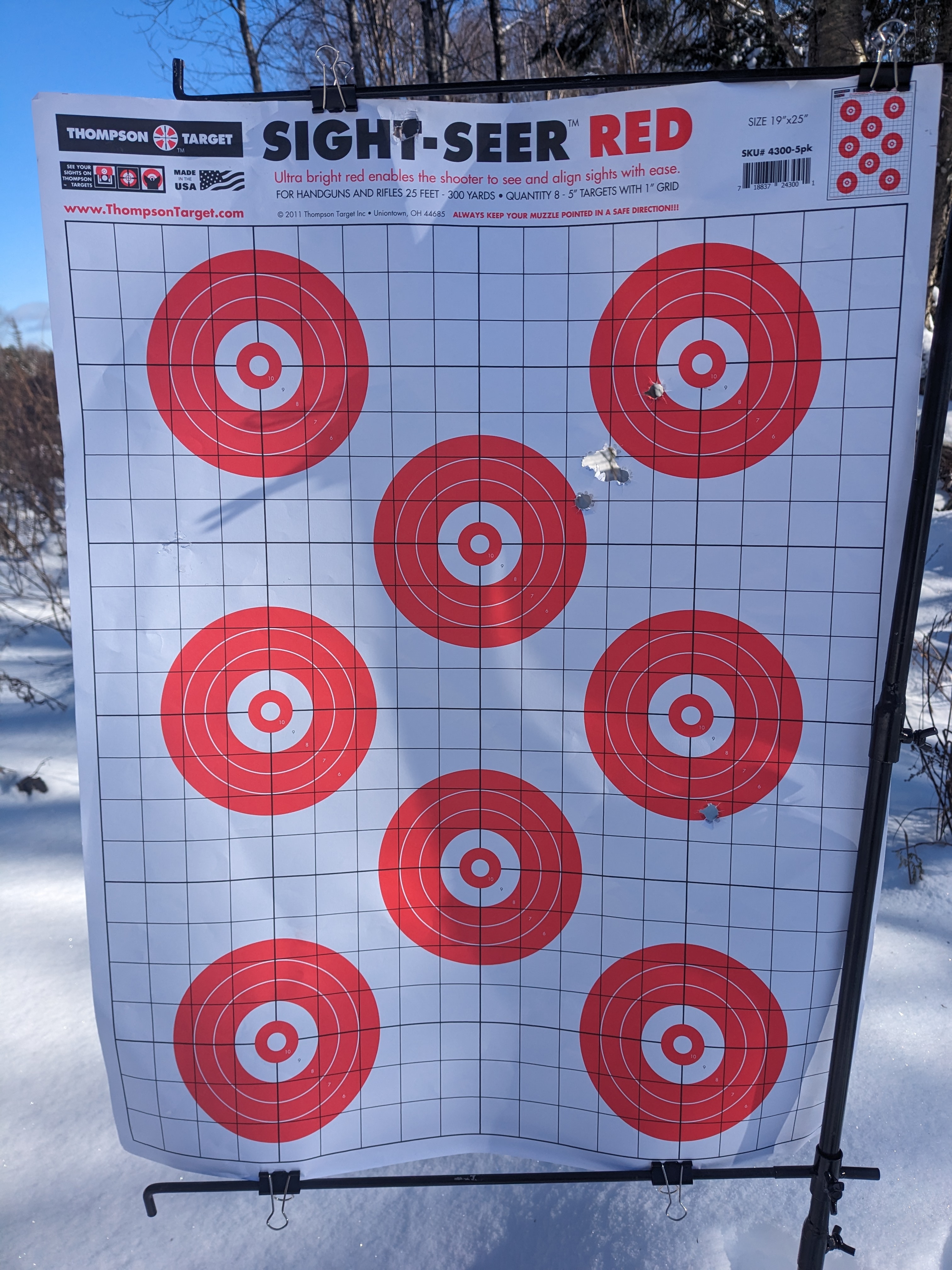

Btw- The .30 caliber makes big holes. And, these bulls were tricky to score and measure. I have 1/2” thick cardboard backing and official N50 card stock 11 X 17” targets. Why, are the holes not more round? They really tear up the paper and I don’t think they are spiraling.
Any ideas?
Perhaps because you pulled it down/sideways slightly for flatness while stapling to the cardboard and created tension one way more than the other. Just a speculation, of course.
My target was fixed with paper clips along upper/lower edges, that created some vertical tension, which was harder for slug to overcome, so it was ripping the paper horizontally. Here me shooting without refilling, you can see slugs started to tear the paper when the pressure dropped quite a bit:
