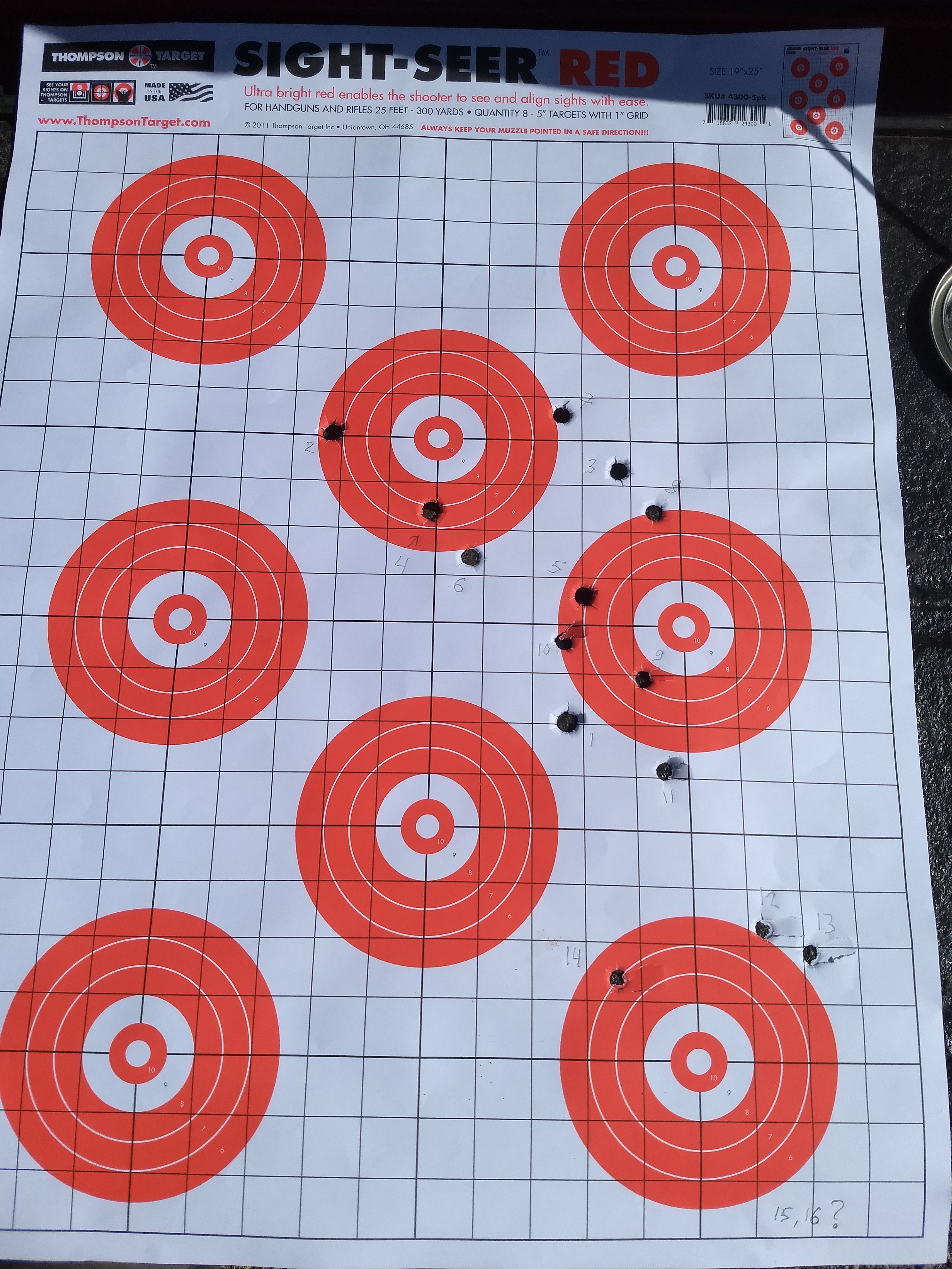

My target was fixed with paper clips along upper/lower edges, that created some vertical tension, which was harder for slug to overcome, so it was ripping the paper horizontally. Here me shooting without refilling, you can see slugs started to tear the paper when the pressure dropped quite a bit:

.510 300+ gr slugs leave no tears, just holes when the air is way up. They start to tear it when the pressure/speed/energy drops. Velocity 950 to 800 FPS - no tears. What FPS numbers do you see with .30 and .22?

The three 28-30 FPE .22 calibers (Royale, HW100, Revere ) all shoot the 18.1g in the 840-890 FPS range. No tears at 30-50y shooting the N50 targets or any 80-110lb cardstock targets. Yes, I don’t get any tears with slugs in the Paradigm .30. However, both the Boss .30 and Paradigm .30 shooting 44g pellets tear the N50 card. Strange…
Can increased velocity and pellet size/weight cause this effect? I’m asking because it is a strange coincidence that it happens with both .30 platforms, and not the lower power .22cals shooting smaller sized pellets with the exact same N50 official targets.
