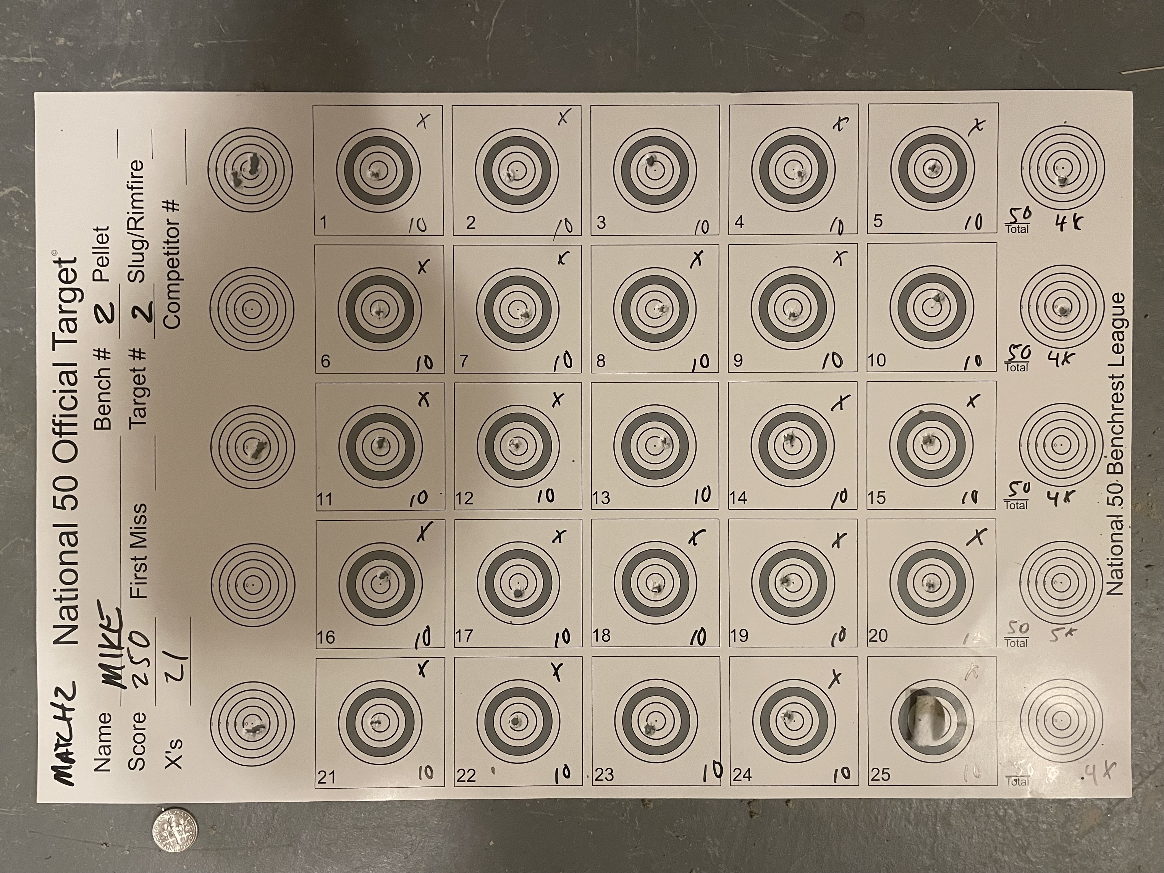

How many shots are you allowed? In the image you shared I see 30 (6x5) but how many shots can you shoot that aren't included in the 30 that count towards score?
Ie, are you taking additional shots in between the shots that count? In the benchrest events here in the US, people are allowed as many shots as they have time for and a common benchrest practice is to take MANY MANY MANY shots to aid in figuring out impact points. When a guy thinks he has the conditions figured out he takes a shot that will count, and then goes back to blasting away, occasionally taking shots that count, interspersed with all the sighters.
Although that is how most EBR shooters operate....it's certainly not how most benchrest shooters operate. On average...I probably take less than 10 on a typical match card. If Im practicing or tuning a gun I might take 100. It's usually not advantageous to break stride once you've got going unless things change dramatically or you are really sucking. You might take a few sanity check shots if that happens. If your gun isn't working it won't matter how many sighters you take, your score will still be poor.
Shooting groups of 5 that don't particularly matter where they land is not nearly as challenging as placing them in a predetermined spot. If score benchrest matches were simply groups of 5 wherever they landed...you probably wouldn't need too many sighters...but then it also wouldn't be called score benchrest, it would be called group benchrest. They both exist....but It's two different things altogether.

Cole...you are automatically assuming that the sighters must all be bad shots. That's rarely the case.
Here is 3 of my cards from a match. Note that all the sighters are 10s.
None of them are "bad" shots. Matter of fact, most shooters would love to be able to trade a sighter for a record bull most times.
Mike
Mike, I'm not meaning for this to be an argument, although the back and forth might feel that way. In contrast, we're arguing the same point I've seen you make elsewhere.
You've made the point more than once about how more cards need to be shot at EBR-like events to better determine a winner. I didn't go digging just now but from what I remember your stance on that centers around consistency and statistical relevance. And that's what I'm saying here with the comparison between sighter-aided scores and non sighter-aided scores. Only including some of the shots taken (non-sighters) skews the data to appear better than reality, the same way only using one EBR card to determine the winner has a skewing effect. Yes, the EBR winner shot the best score for that one round, but the results are more statistically sound (more "impressive") when they're the best shooter over multiple cards.
I understand that not all sighters are bad shots, but the cards you shared in the last post further make my point. That was shot by the best benchrest shooter, using the best equipment, and is probably an even further outlier in that Id guess that most of even YOUR cards don't have all the sighters as 10s.
Ie. you're sharing one of the better examples where the sighters are all tens.
Actually was sharing the only 3 cards that I've saved from a full match....and I didn't save them. Jeffrey saved all of the match cards when he was here and forgot to take them with him when he left.
The point value of the sighters is also based on how a person chooses to use them. In 25m BR, I always aim dead center on a sighter and let it blow. This is so I don't have to remember where I held and the condition present when I took it. I don't do that in N50 because it can easily blow out of the sighter area in heavier wind. Instead, I aim where I believe I should to make the shot...most of the time.
Anyway, I see your point...but I suppose one could go a step further and propose that no sight in time be allowed prior to ft matches.
I don't think you're being argumentative. I, also, don't think your comparison concerning the allowance of sighters in score benchrest is like shooting one card matches.
The nice thing about proper BR matches is that the best and most prepared shooters win every time. If sighters were disallowed ...the same guys would still win, but they would prepare differently.
