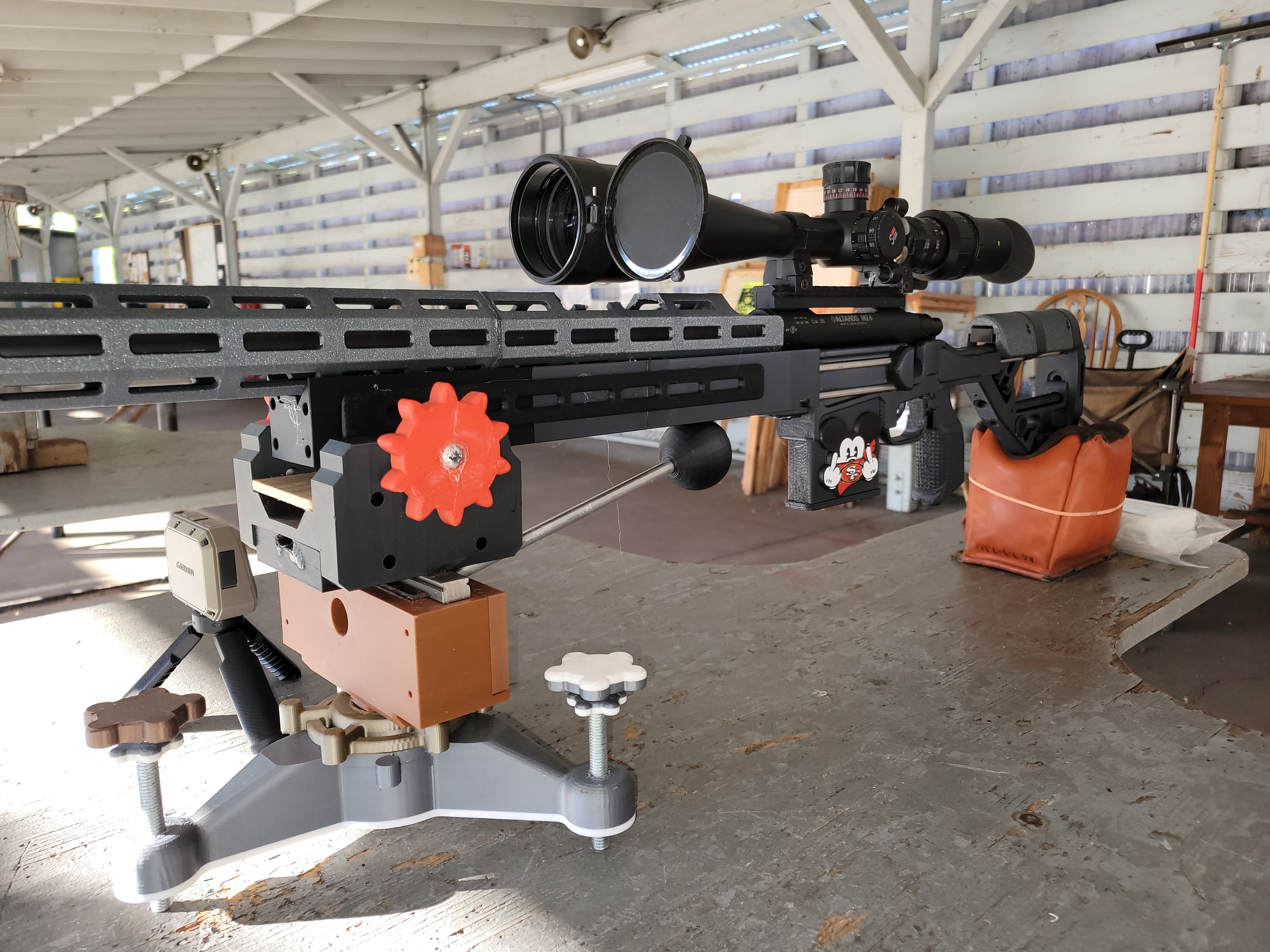

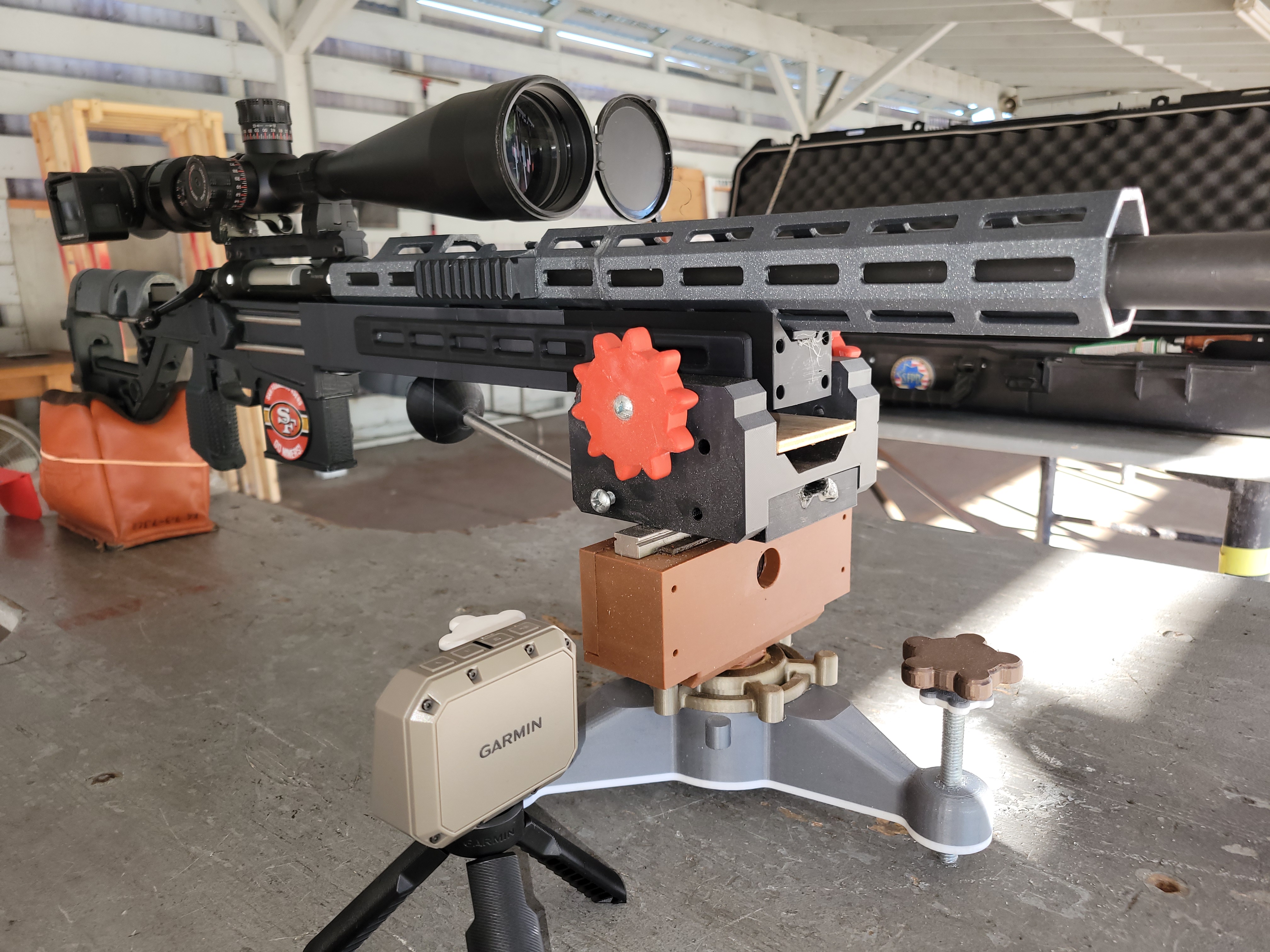

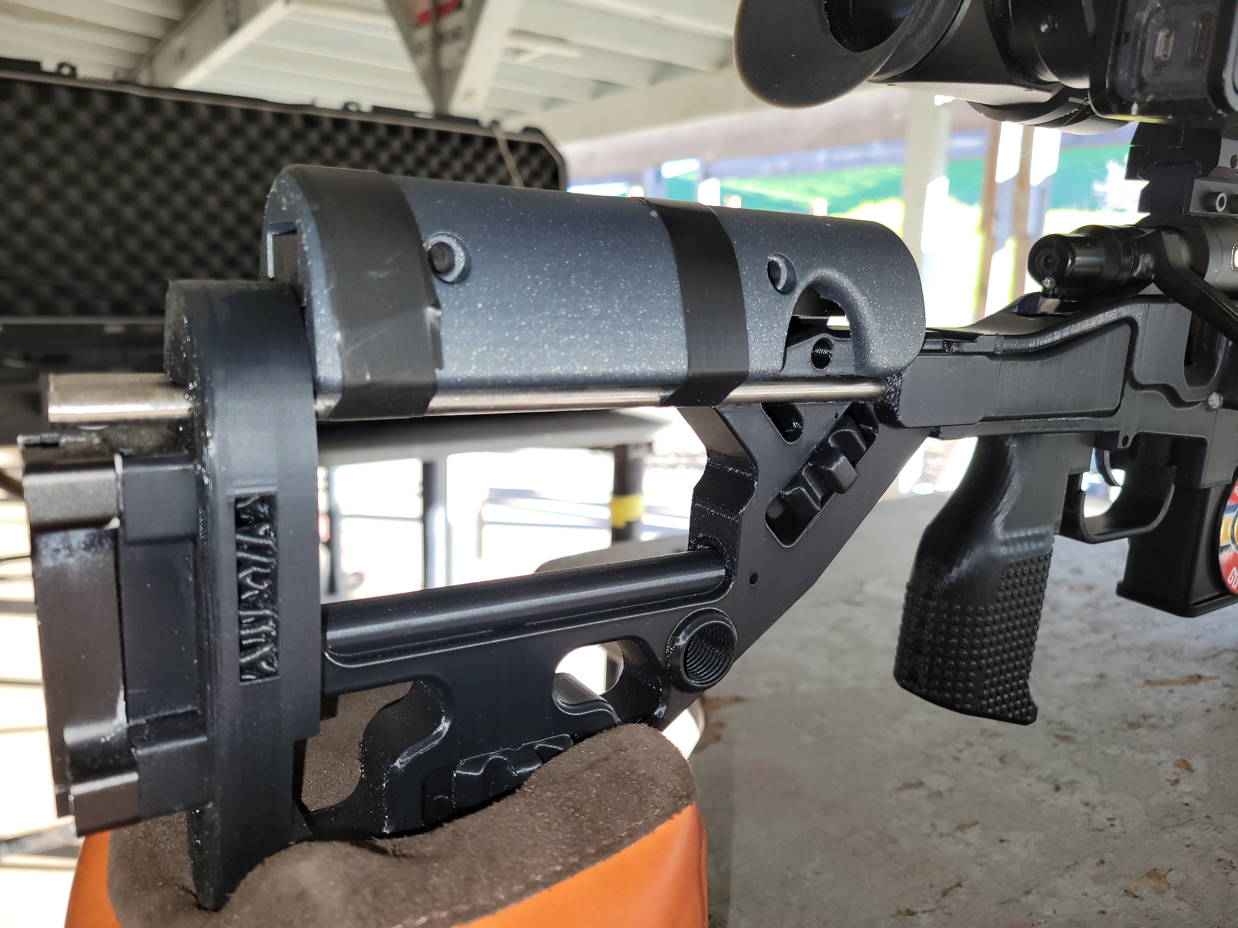

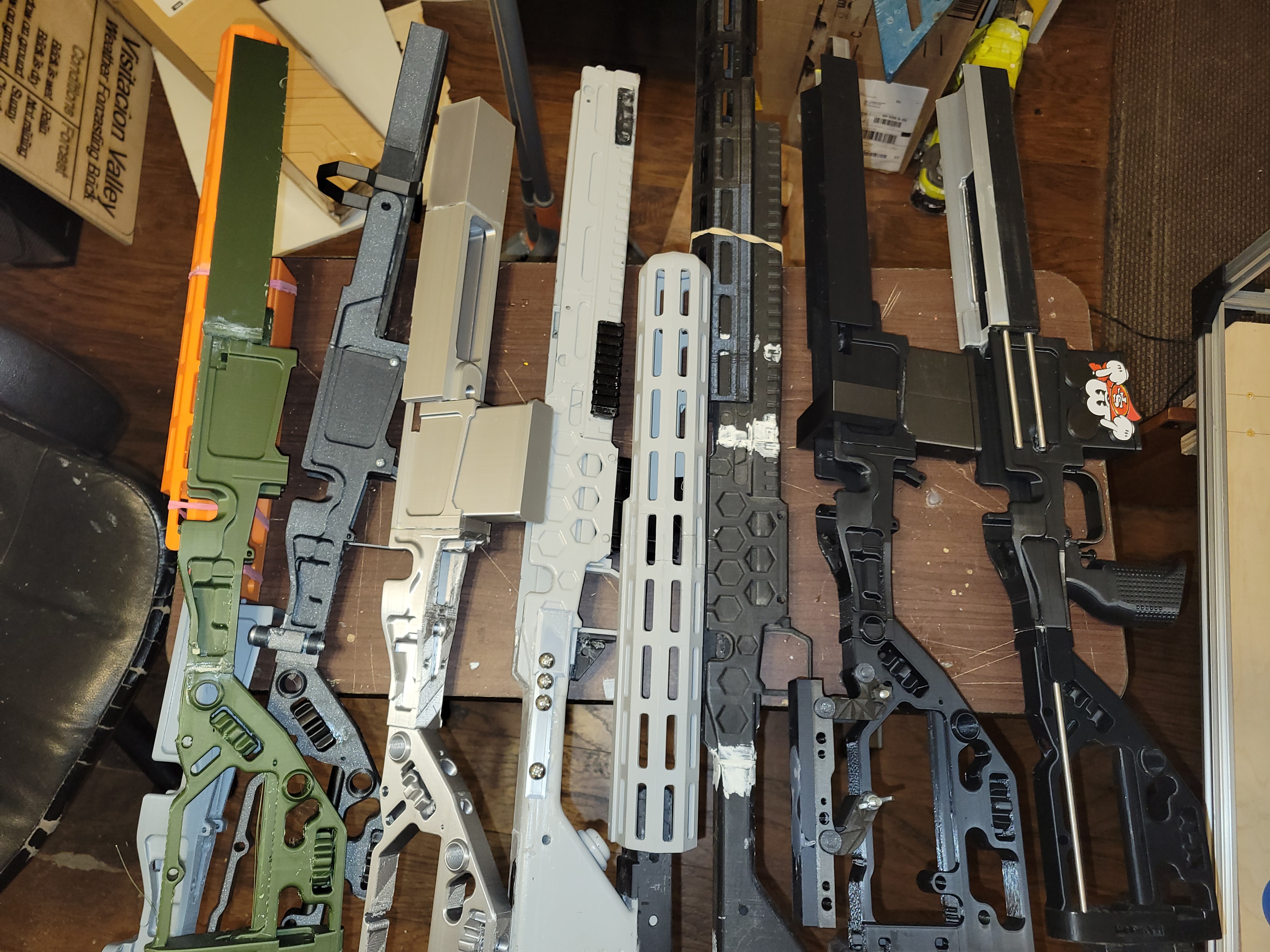

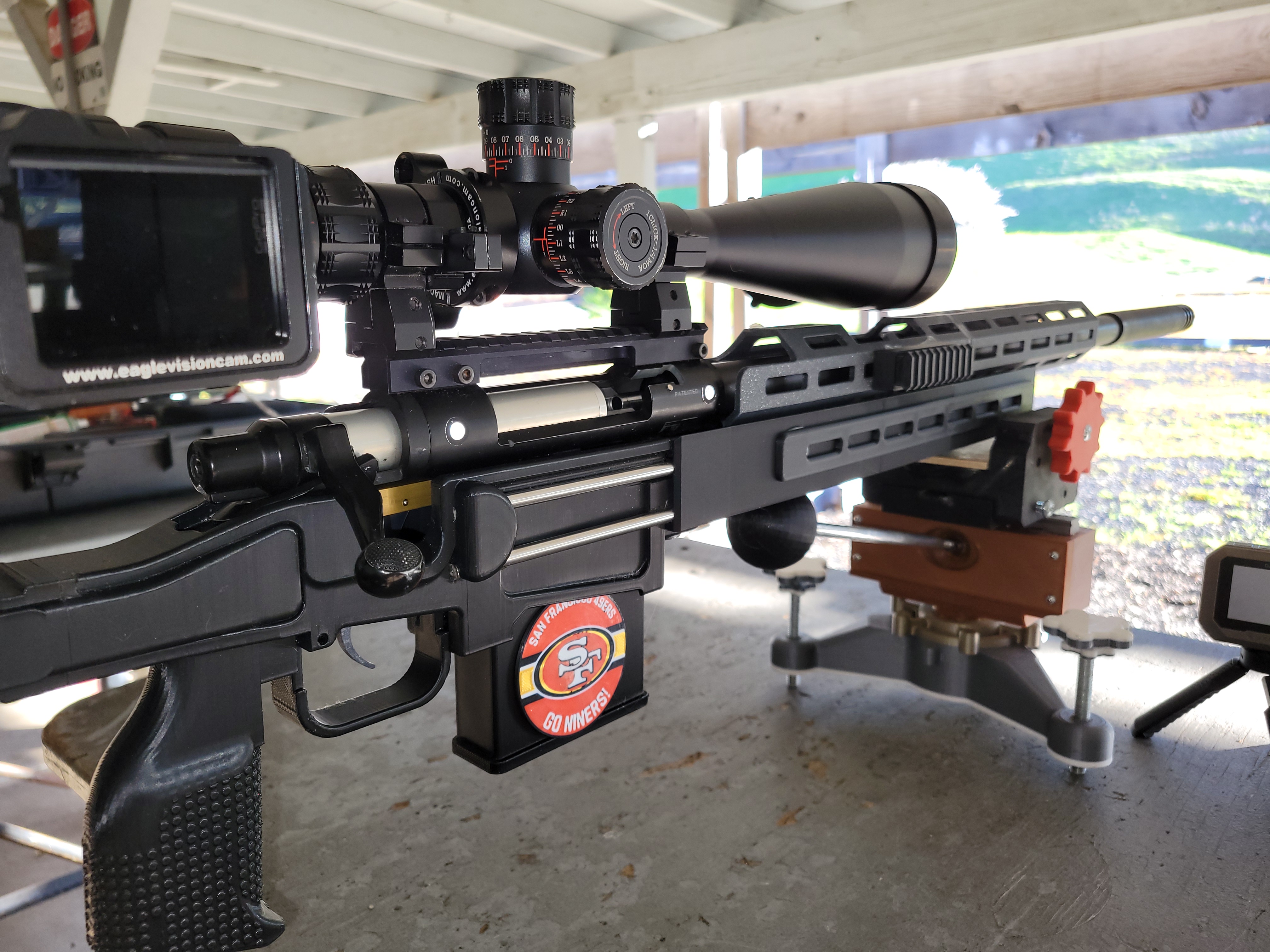

I have been playing around with different 3d printed designs for a technical stock for my Altaros M24. I only shoot benchrest at 200 yards.
I also 3d printed the co-axial front rest that works great! Now I have to only decide on the right filament for the actual stock. ASA, PETG, ABS or some type of carbon or nylon engineering filament?
Needless to say, I love my Bambu X1c printer and have no problem printing different prototypes. My new printer, Anycubic Kobra 3 max will print the stock in 2 pieces instead of 3 pieces on the X1c as it will have a 500mm z height instead of the X1c of 256mm.
There are four 1/4 stainless steel metal rods built into the stock to make the stock strong and sturdy.
Enjoy
Rod in San Francisco
