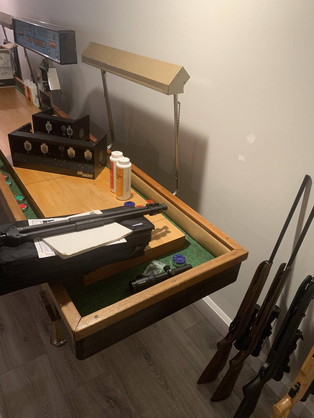

I just happen to have a old shuffleboard, I’m using it for storing gun stuff till my room is done. Away the wax is actually minuscule balls. The rocks roll over the wax which looks more like sand.
