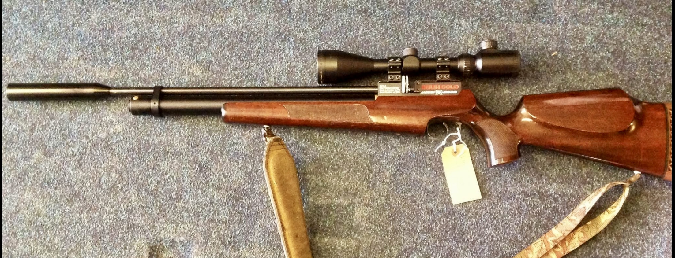

I still have my .22 Cyclone, my friend have the same year but the Cutlass, with a different stock and the cocking mechanism, otherwise the 2 share all parts.
I have not shot mine for a while as i have been deep into .177, actually my .22 is illegal now, well at least for me to own.

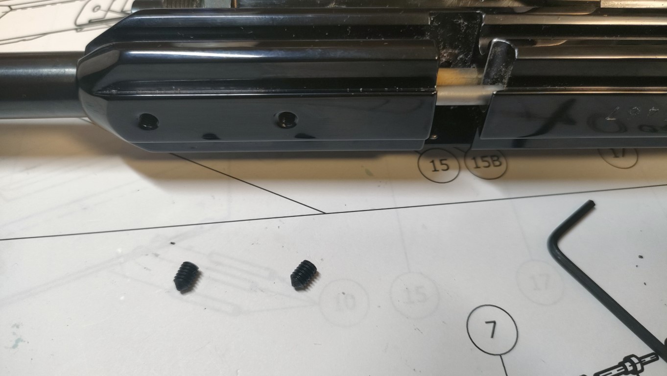

I'm disassembling my FXCYCLONE to replace the O-ring.
But I can't remove the barrel. I removed the two top screws, but even when I pull it, it only comes out about 3 mm.
Is this just because the O-ring is stuck? Or is there some other problem?
I'm worried about the barrel bending. I'd appreciate it if you could tell me the best way to pull it out.

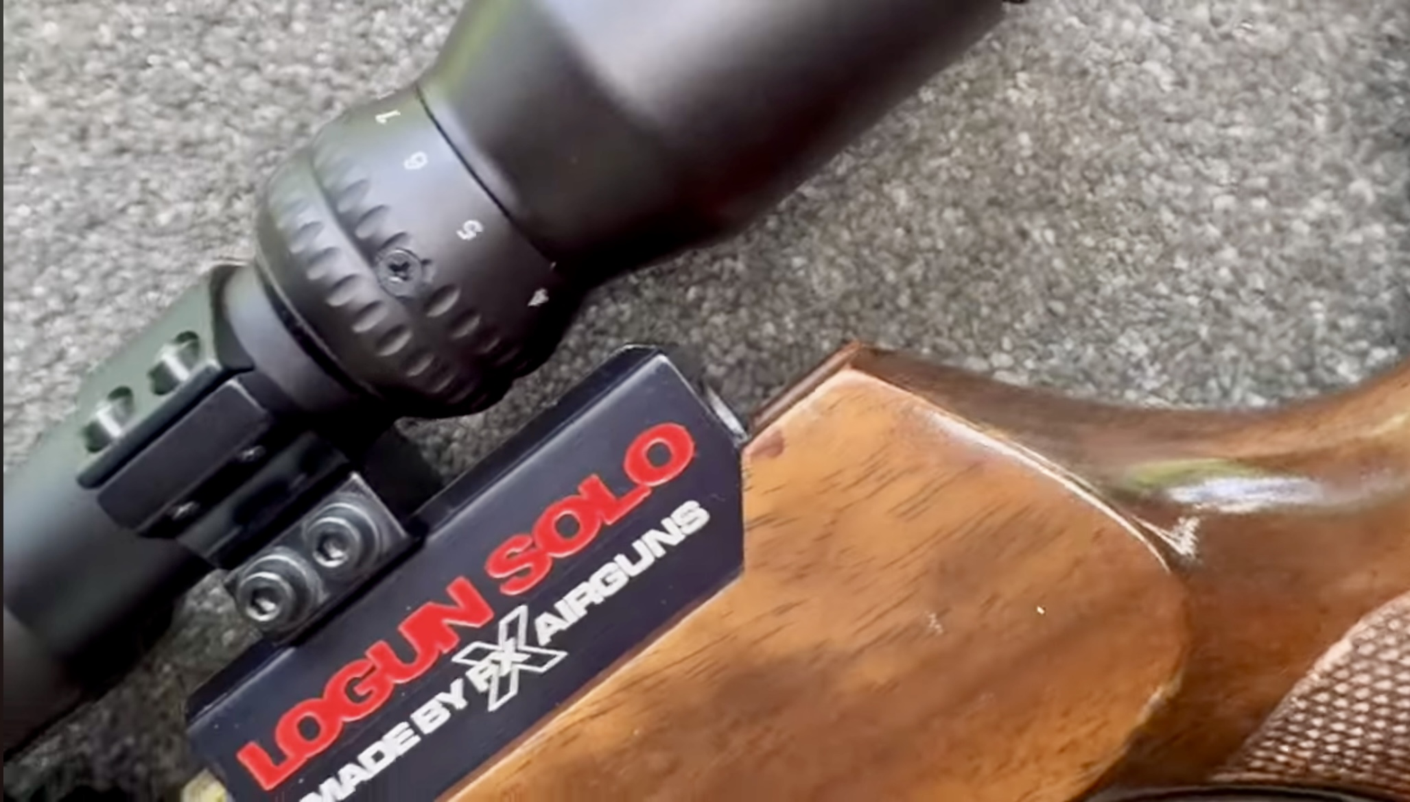

I also previously owned a FX Cyclone in .22. Great gun. I actually owned a Logun Solo made by FX even before the Cyclone. Solid, solid PCP they both were!

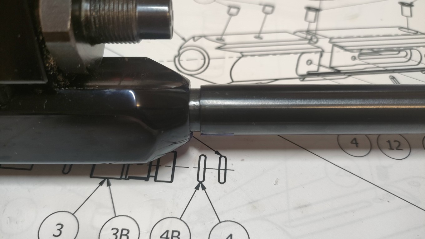

Dear Sir,
This is the part that fits into the barrel housing.
I think 63 and 67 are O-rings that are inserted inside the tube, but does it mean which one depends on the thickness of the barrel?
So for a 5.5mm barrel, would it be item No. 5112 (5.28*1.78 NBR70)?View attachment 520771
FX part # 5112, 5.28*1.78 NBR 70 can be found as a standard inch O-ring #009 NBR 70
Thank you for prompt reply.
If my barrel is 5.5mm, I wouldn't use a 67 (O-ring No.2529 4.3*1.5) here, right?
